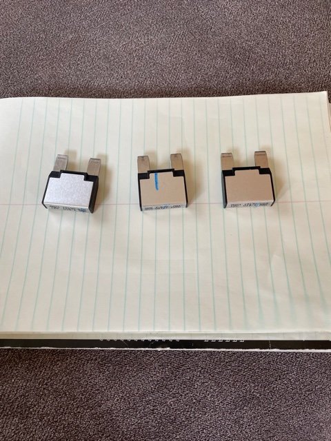

I also am looking for a location for these guys (attached images) 12 V 50 Amp
I found a home for these 50 amp guys. Took a while, there was a wire assembly with sockets behind glove box that accepted them.
