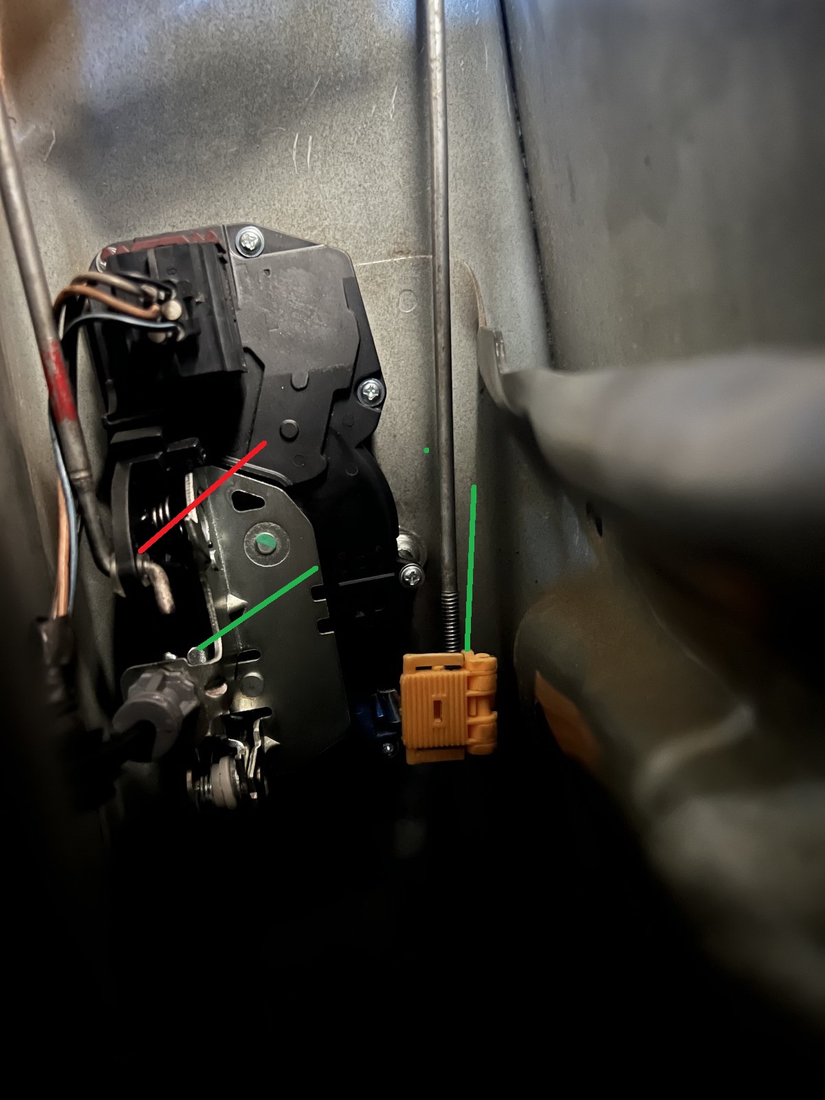

So in my pic here the red line that should be up all the way and either of the green lines should open the door. Maybe the child safety lock is enabled?
I have pulled on the exterior door latch and it won’t pop open the door. I didn’t check if child safety lock was enabled when I installed the actuator so that might be part of my problem. But the exterior handle should still open the door when it is in the unlock position. I’ve been fighting with this for two days if I can’t figure it out today I’m just going to wait to bring it to the shop. What a pain in the ass lol

Is the linkage moving? It could be misadjusted. Pop that orange clip open and move the lever by hand.
That’s what isn’t working. I have opened the door this way before and it worked in the past but when I try and move the lever now by hand nothing happens. Really at a loss what to do hopefully the shop can figure it out. Don’t know how I managed to replace handles on three of my doors perfectly and the one I replace an actuator on is the one that won’t work now FML

Somehow got it open ! I pulled up on the interior door catch and it finally opened. The child lock was NOT activated so I’m really wondering what could be causing this to not open on the inside or outside. Any thoughts or advice would be appreciated.

Take it back out and inspect it's operation. I would absolutely not use that one again assuming it was properly installed and linkage properly adjusted. Exchange/replace.

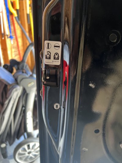

I got the door to open from both inside and outside but now it won’t latch shut! Any ideas? Both the exterior and interior door handles work to unlatch the actuator as shown in the video, but when the door closes the latch doesn’t engage and hold the door shut. At least I can open it now. Going to tie the door closed with several bungee cords for now until I can get it to the shop tomorrow morning. I’m just happy I was able to get the door open but I have to pick up my kids so my wrenching time today is up.
I found a shop close to me that is going to look at it tomorrow morning, I’m officially throwing in the towel. If they need to replace with another actuator I’ll pay whatever I need to not have to open up this door panel again, especially when the door is locked shut!
