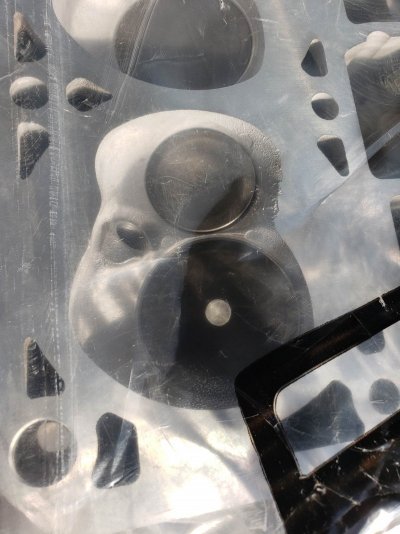

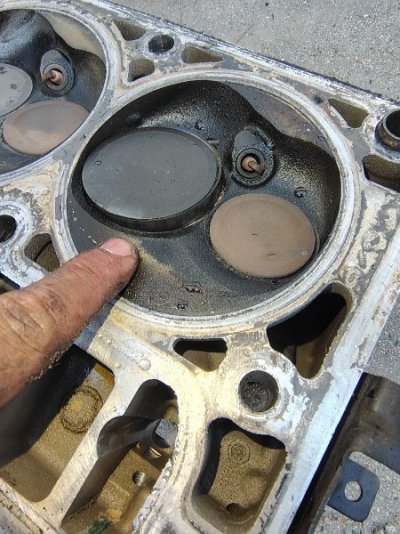

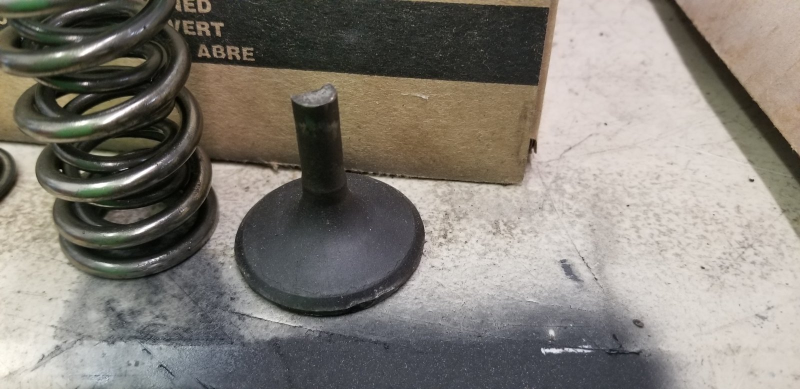

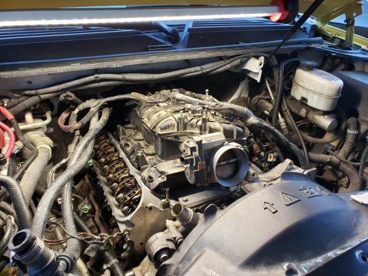

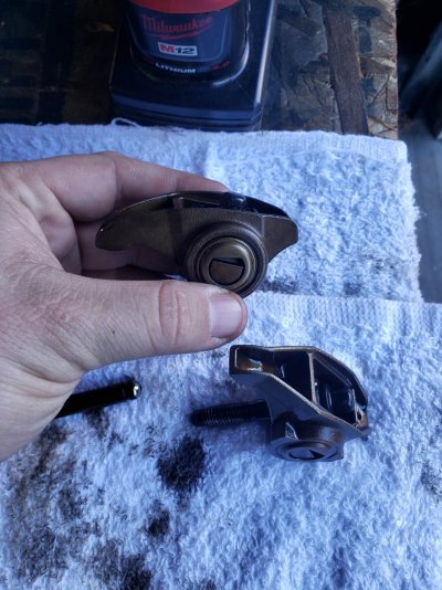

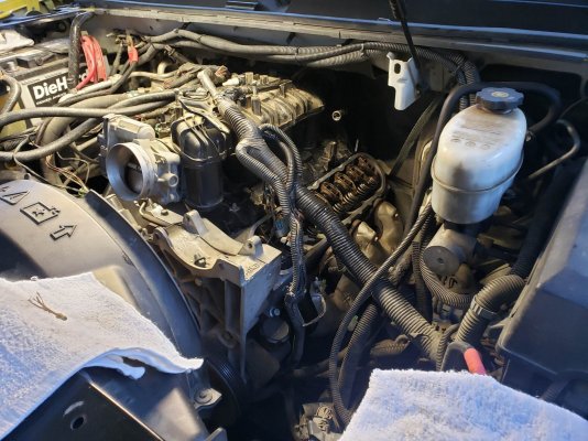

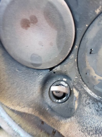

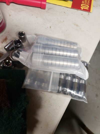

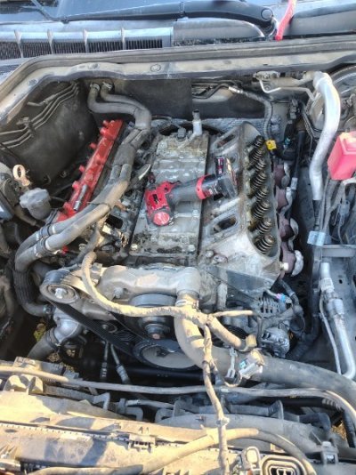

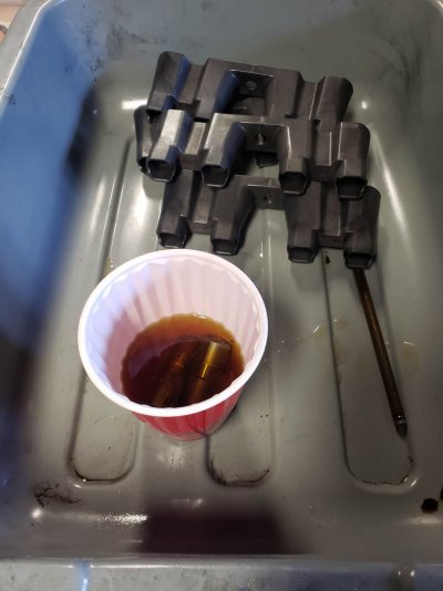

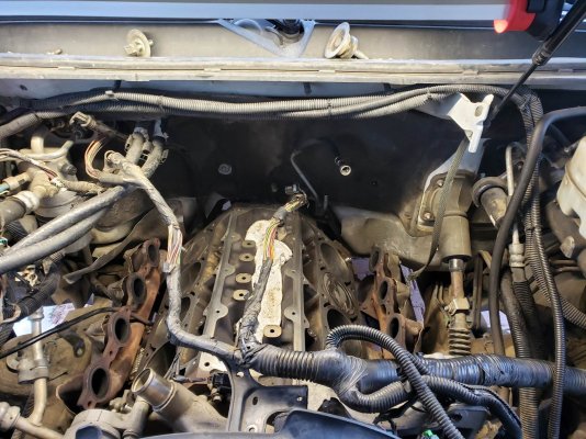

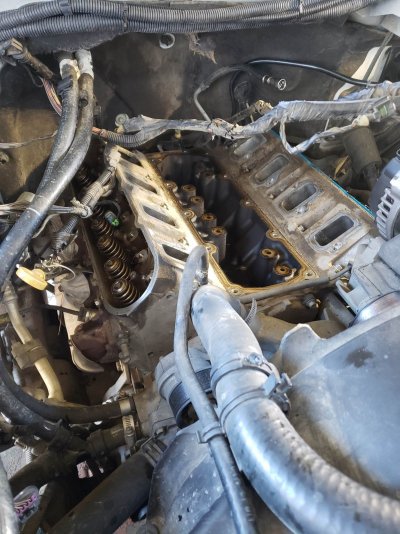

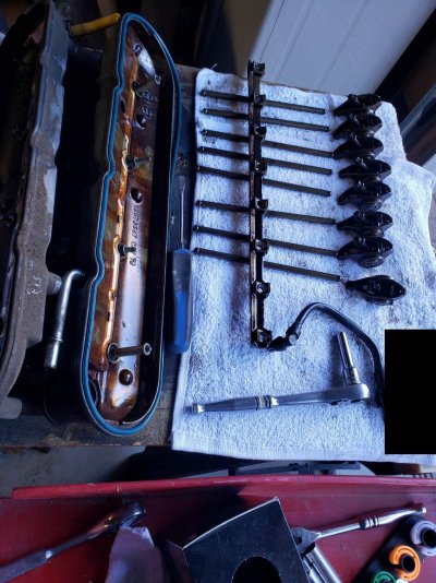

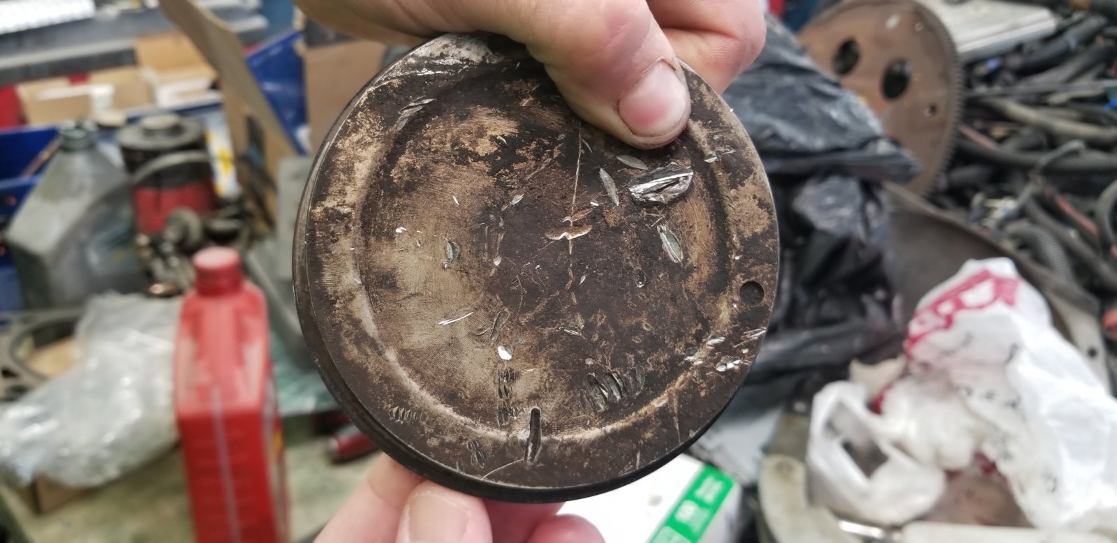

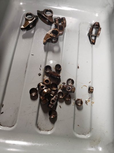

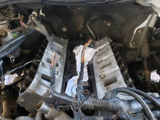

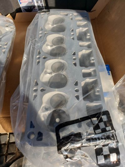

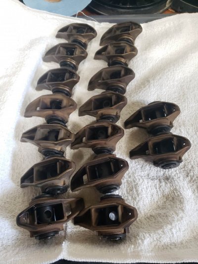

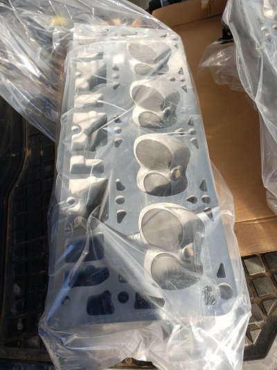

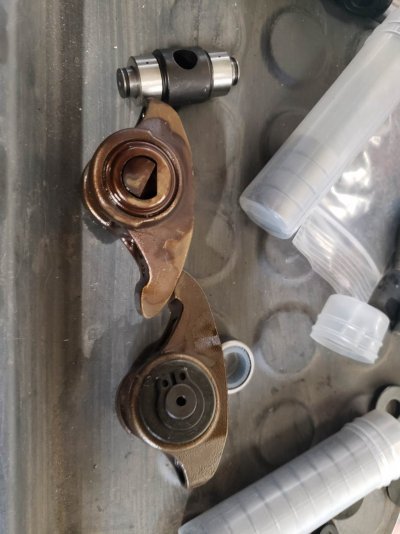

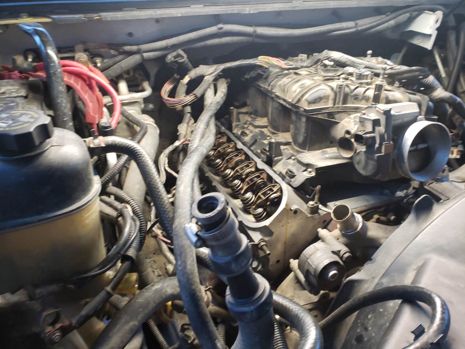

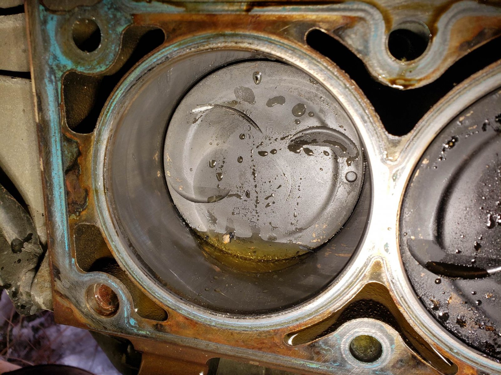

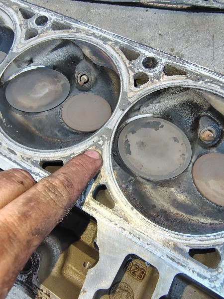

Was getting a Misfire code cylinder 8, and rich code bank 2. Put a new Spark plug and Ac Delco Injector Cylinder 8 and swapped the Lead and coil to different cylinders cleared the codes and drove it 50 miles then the code came back but what I thought was a Lifter tick (Not DOD). After taking the Valve covers off and running the truck and listening with a stethoscope noticed the rocker on cylinder 8 intake side was crunchy sounding. So I made the choice to pull the Heads and glad I did. Checked the piston did not go very deep and did not bend the connecting rod when I ran the piston all the way up. Last 2 photos are from the machine shop and the guy did an amazing Job. Will post more photos Later in the week due to the snow storm coming my way.
