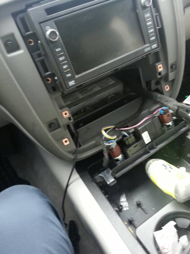

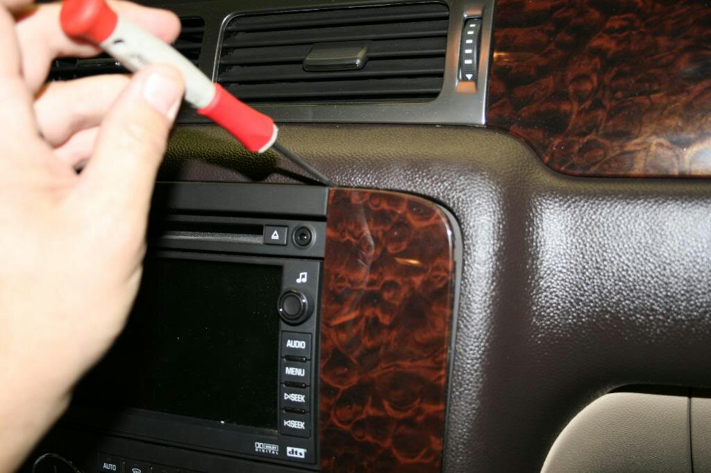

Take you trim removal tool and wedge it between the trim around your radio and create some space. You will need to use a little force but will eventually hear the clips pop free one by one as you work the tool along the trim. I started at the top left corner and slid the plastic pry tool down and around popping each one along the way. If you need more help just YouTube it something will come up. After the trim for the radio is removed you will see the bolt screws mentioned early. Remove all of the screws on either side from the radio down to the cigarette lighter portion. Now slide out the bottom parts first which may require you push some clips in slightly to pull it out. Do not disconnect any wires just pull them forward enough to see the vcim.

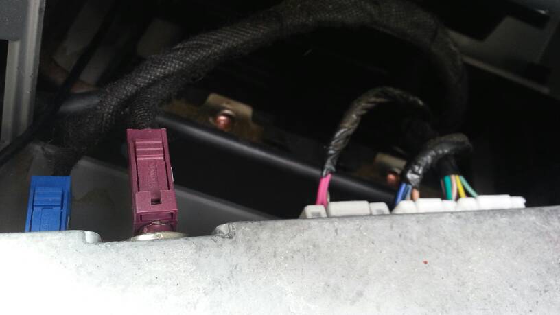

Now that you can see the vcim you should use a flash light to get an idea of what's going on in there. Not much to see but better to know your surroundings. Notice the black clips holding the vcim in place? Those are the biggest pain in the ass of the whole process. Before you get to the black clips unscrew last two remaining nuts holding the vcim in place. Now as for the clips. My suggestion is to use the plastic pry tool and push it until it give you enough space or snap it. Don't worry about snapping the black clips they are completely unnecessary fire keeping the vcim in place as the two screws are plenty strong enough to hold it down super secure.
At this point you have the vcim ready to be pulled out just enough to remove the cables from its back and swap it out. A note of caution regarding the two cables in the back left of the vcim....push down on the clip and pull to remove those two.
