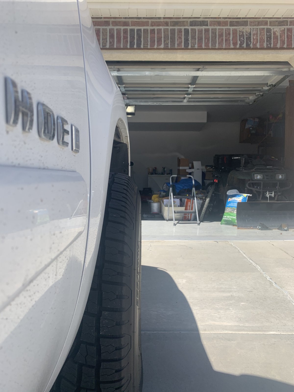

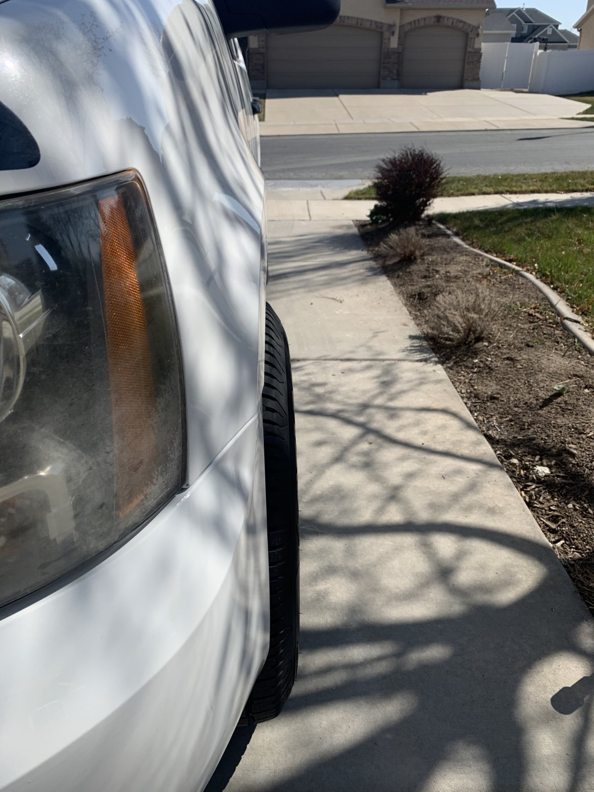

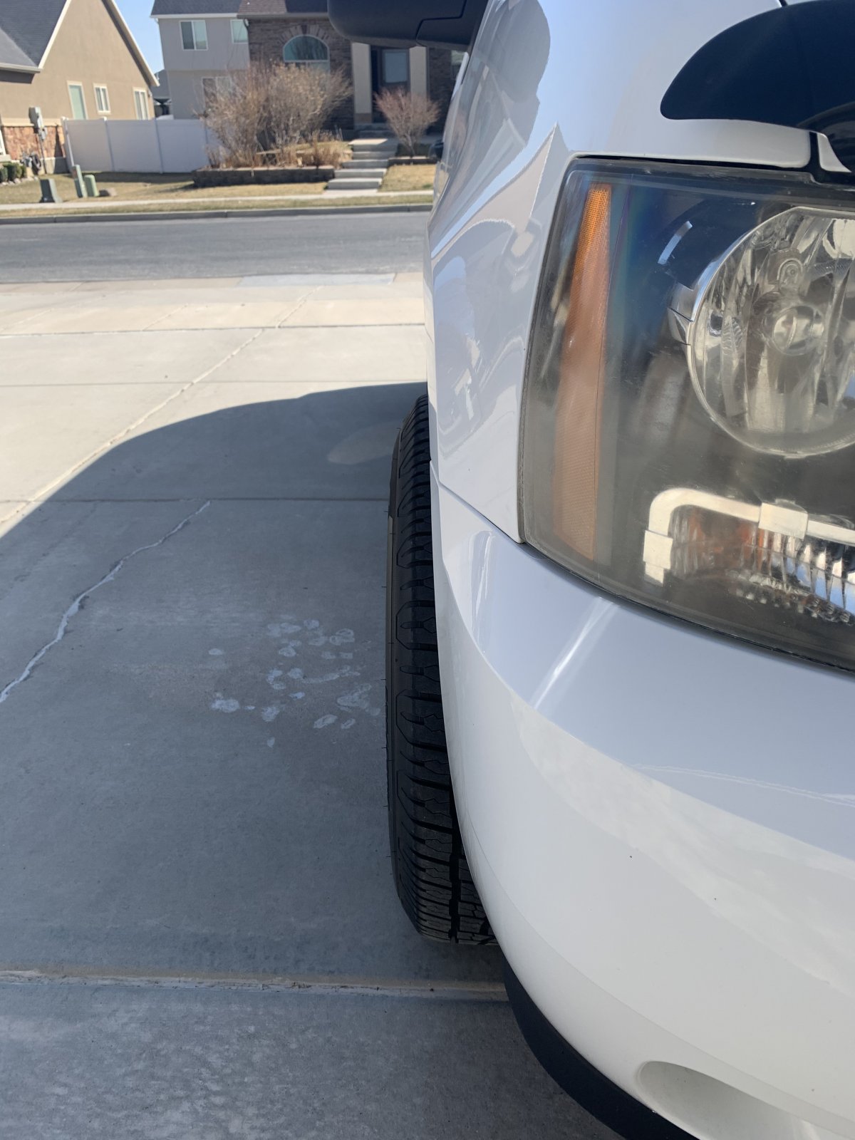

Hello guys, 08 chevy Tahoe 4x4 with no history of accidents. I’ve owned this tahoe for over a month barely. I got new wheels and tires and when I got home I noticed that the front passenger side tire sticks out more than the other one, very noticeable. I thought it was an alignment issue, had it aligned and nothing changed. I swapped the front tires in case the offset of one was different and nothing happened. Any idea what could I be dealing with? I’ll post some pics so you guys can see it. Thanks in advance!

Only speculating but, perhaps a hub was replaced with one of a different/wrong offset?
(maybe different hub offsets for different size wheels ie: 20" vs 17"?)
Pretty sure only one control arm length is available.
Perhaps you could tie a string from front upper control arm pivot to rear lower control arm pivot or vice versa
and measure from back of hub to string on both sides to see the difference?

I would verify there is no spacer behind that tire. And if there is one, that lugs are long enough. Never Know till ya look! And it could be offset bushings in upper control arm for alignment.
Cgiese80
Cgiese80
Apr 3, 2021
9
I removed the tires to make sure there was nothing behind the wheel, swapped them out and still looked the same. I did have that Upper control arm replace only on that side and right after that, I got it aligned.
