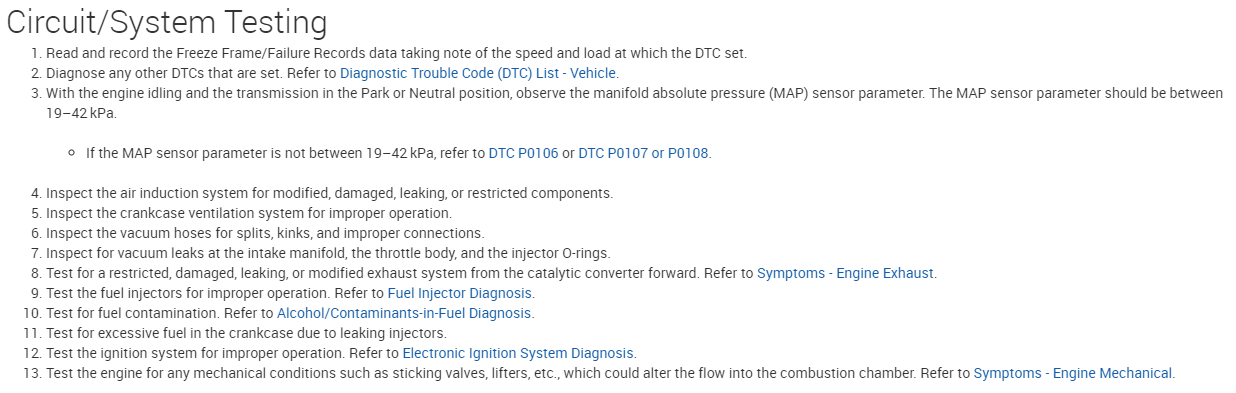

You always want to start with the basics: https://www.autocodes.com/p1174_gmc.html
You said "if changes" sensors and mass air flow. Does that mean you did change them or "if" you changed them?
How old are the ignition related components? Miles on the engine? Idles rough or smooth? Long crank before start? Etc......
