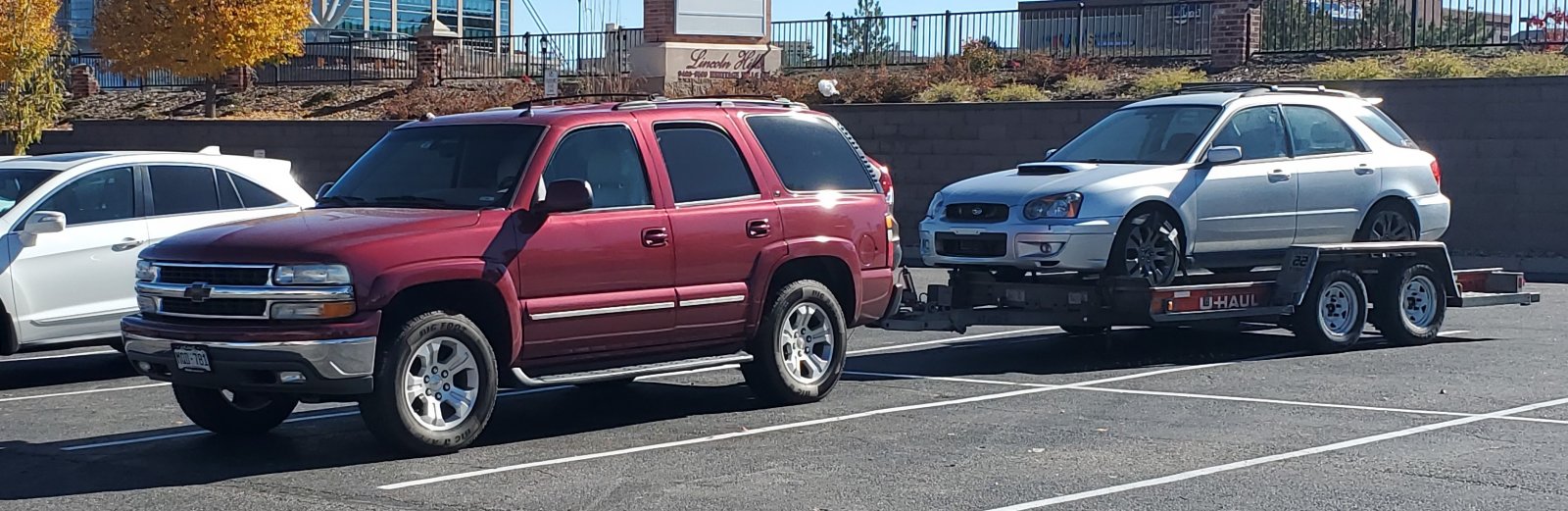

For your heavier hauling be sure there is a tranny cooler in front of the radiator. If the fluids haven't been replaced lately, do it preemptively.
