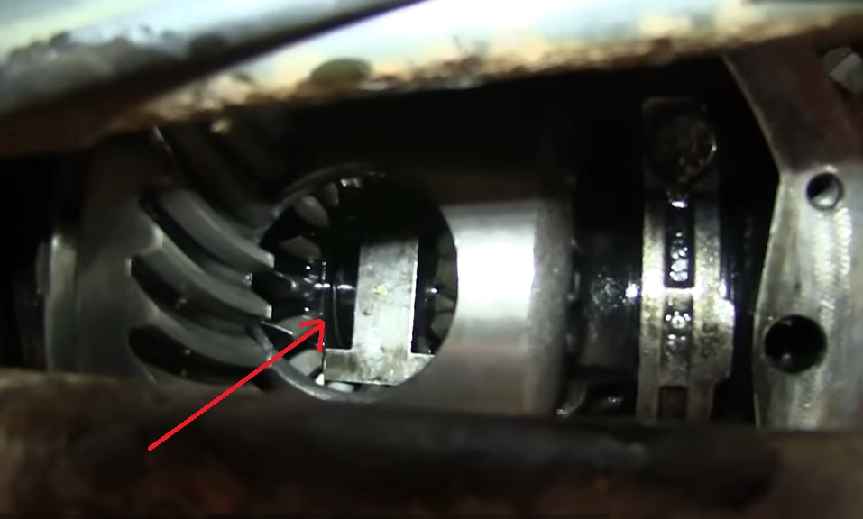

Need to replace the rear axle bearings and oil seals. Have gotten the Eaton G80 locker down to having the pin removed and trying to get the C clip off the end of the axles. NO GO.
Cannot push the axles in far enough to get the C clips out. Only need about two thousands more travel.
I am told that this cannot be done at home because of the fact that the 2005 ABS sensor thing is inside the axle tubes on outboard end! Anyone know a GM Tech???
