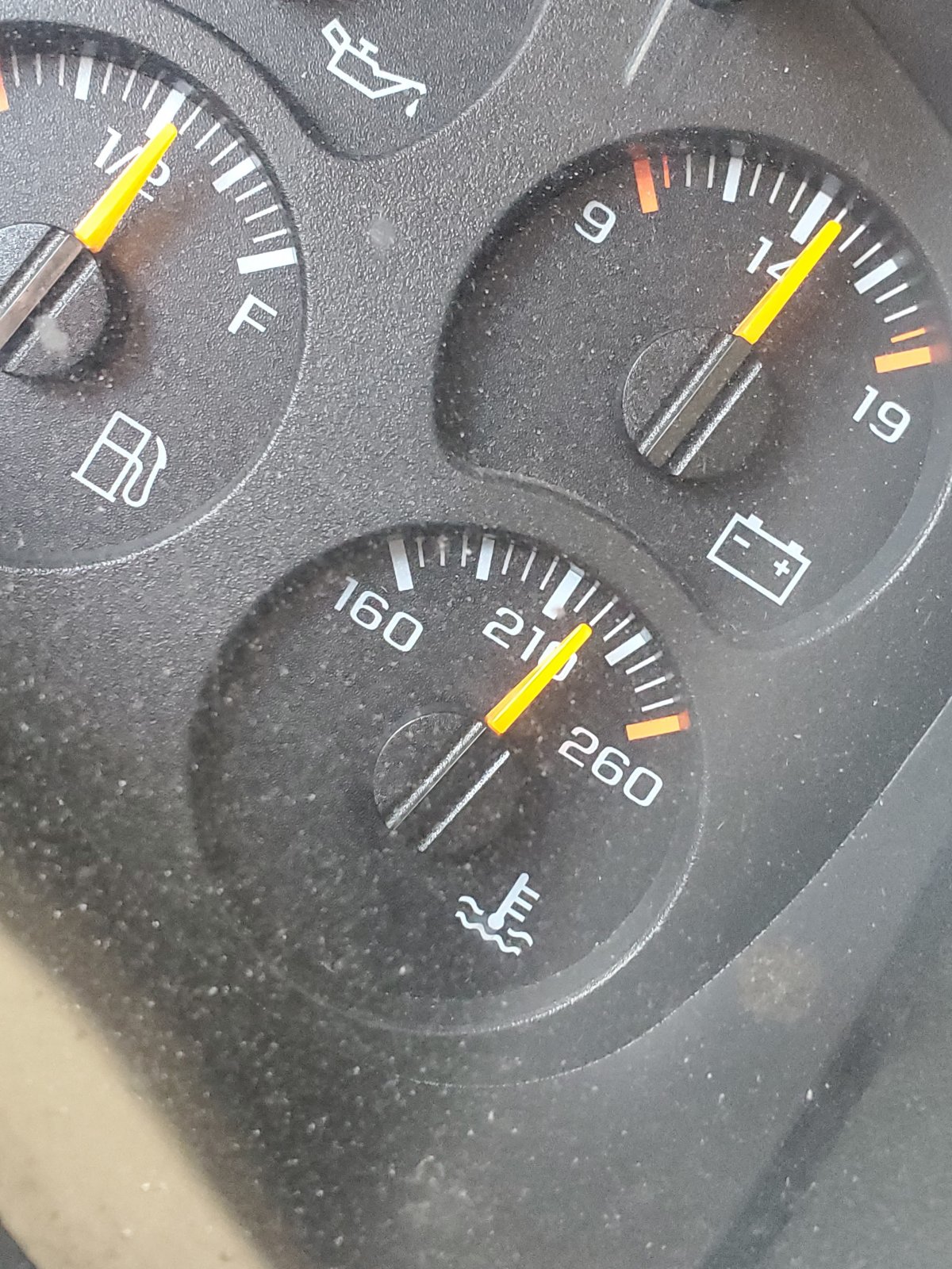

This is with that line basically clamped shut. This was showing about 203-207 on my scanner.

I think I will probably just get a new thermostat again and test it this time before install. Kind of want to get a new GM pump too just to be sure nothing is wrong with it. All I know is it shouldn't take a 5.3 gasser longer to warm up than my diesels, that's why I bought a gasser again for winter lol.
