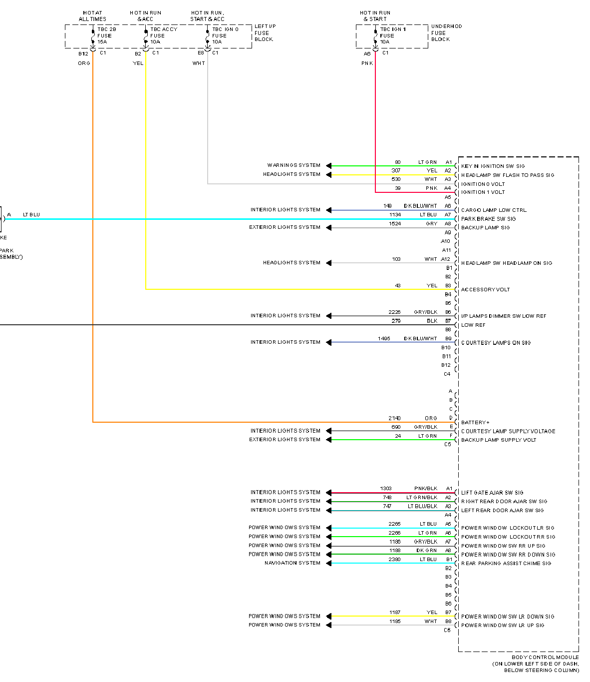

Here's the part that applies to the window switches:
Thanks for the pic as that's step in the right direction but that doesn't look to match my switch. Note in the bottom it says Body Control Module and it's got signal wires for door ajar, power brake and such. It does give me some clues though as I see reference to the RR up and down but the driver door switch/module I have controls 4 windows, 2 mirrors, and the door locks.
