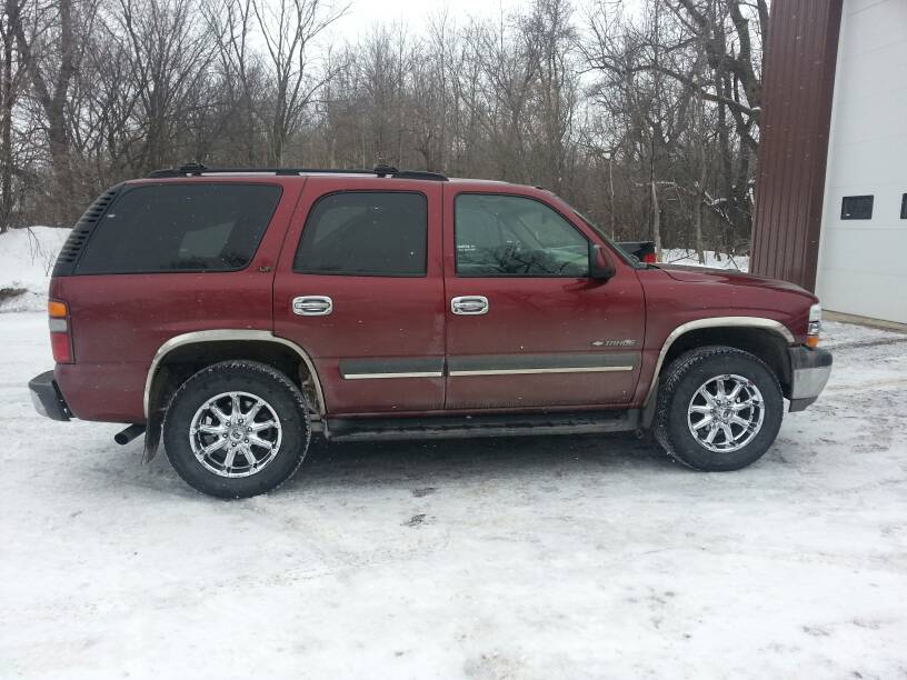

Looking for a little help in the right direction...I've got an 02 tahoe that came with those crazy expensive nivomat shocks...As it would turn out wife got a new job, and we are in the process of buying a new car because she has to drive 100 miles a day and that just wasn't working for the checking account putting gas on the tahoe.... soooo like I said we decided to buy a new car and sell my 07 silverado and keep the tahoe being it is absolutely mint with less than 100k miles on it. So being my pickup is gone, I've decided to have a little fun with this. Being I have the nivomat shocks on it, and they are shot, what do I have to do go put a little bit of a lift on it? Keys in the front and spacers in the rear with z71 shocks and springs? Also what size of tire can I expect to run with little to no rubbing? It has 18 inch xd badlands on it.

It's a little dirty but you get the idea.. thanks for any reply!

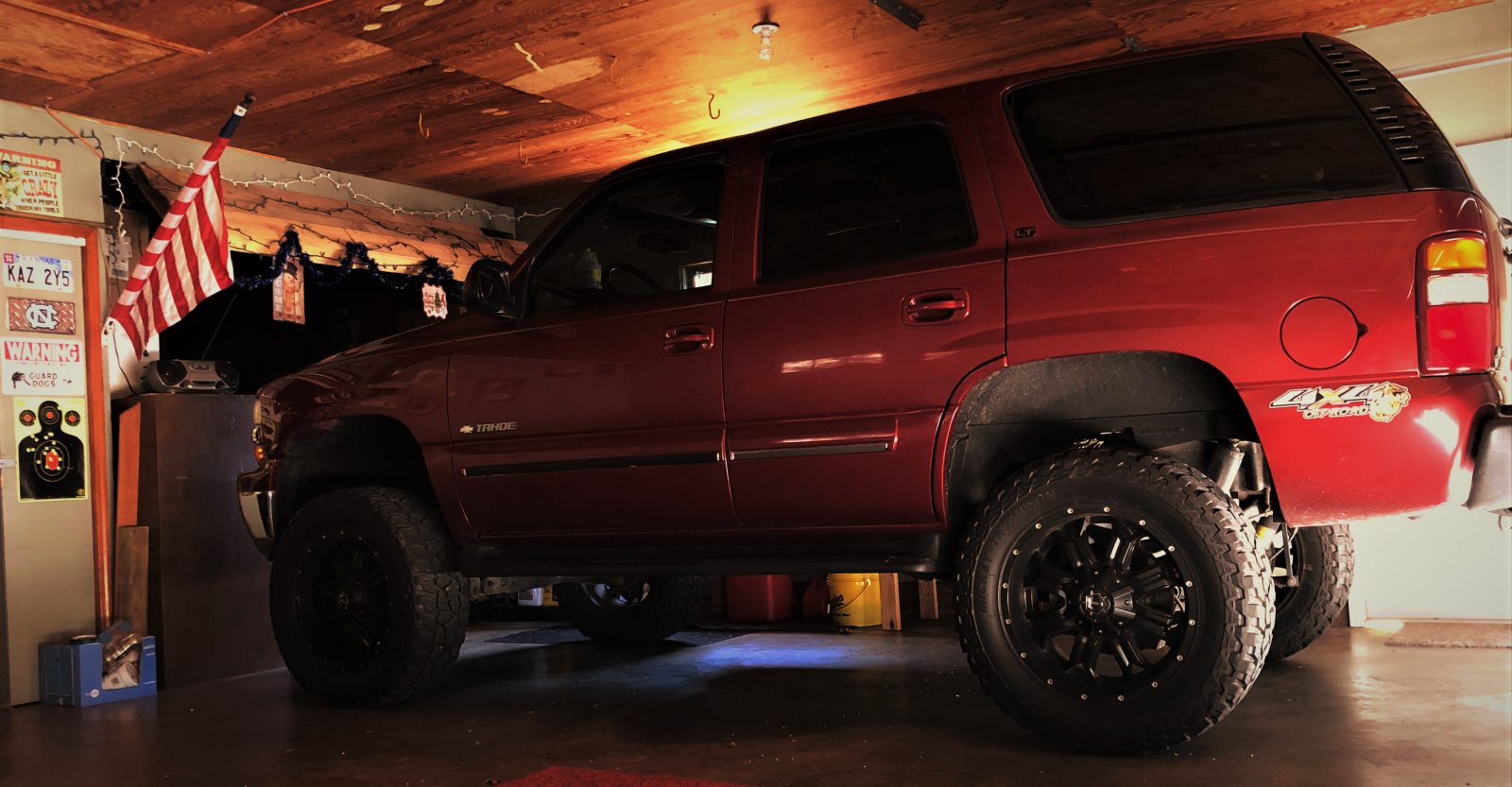

99-02 silvrado front 3" lift spindles and Z-71 rear coil springs with a 1.5" spacer!

No spacers and Z-71 springs are = to 3" of lift in non 4X4
