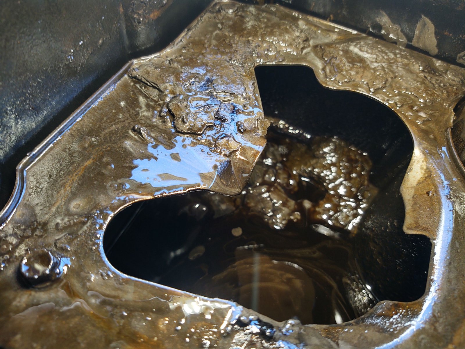

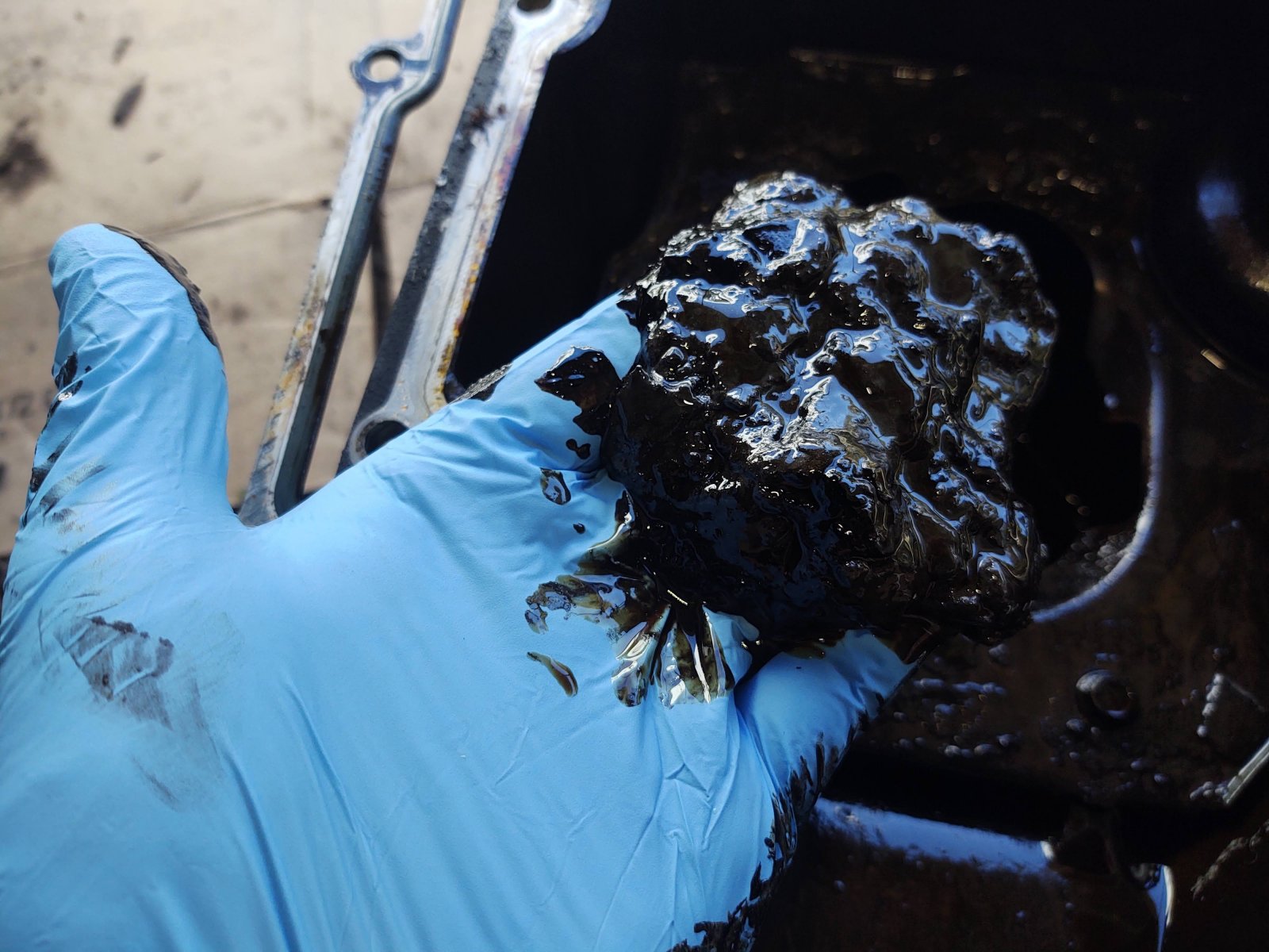

This all started about 2 weeks ago, I got a "Low Oil Pressure " warning light on my dash, and my oil gauge dropped to just below about 10psi. I replaced the oil sending unit, NO CHANGE. So then I bought a manual pressure gauge, and after hooking that to my engine I saw that it was reading the same as the stock guage on my dash. So I ordered a new oil pump and pickup tube/screen. And if course all the needed gaskets and seals involved when you remove the water pump, timing cover, and oil pan. So I pull the oil pan and it's FULL of thick sludge. The screen was also mostly clogged with sludge and debris. IMG_20211025_141333528_HDR.jpgIMG_20211025_141414244.jpg

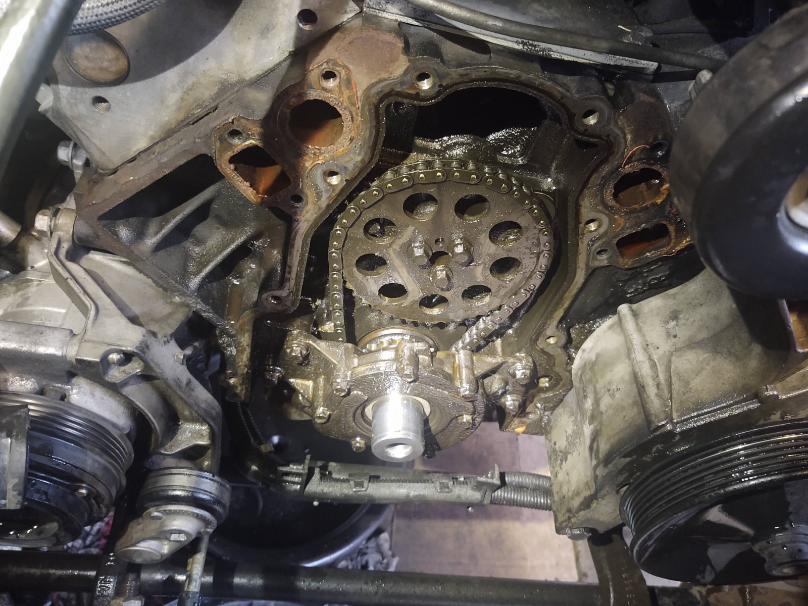

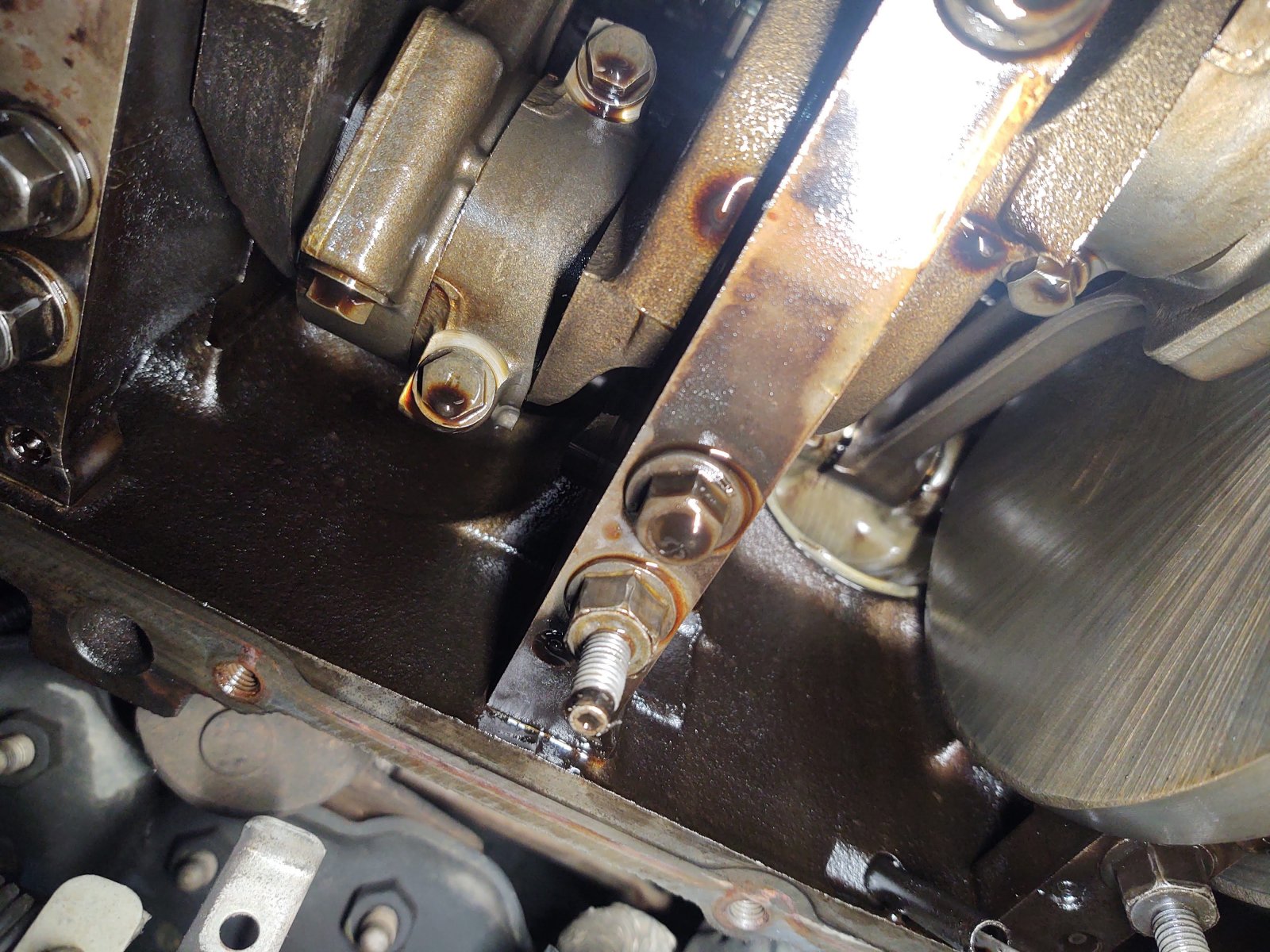

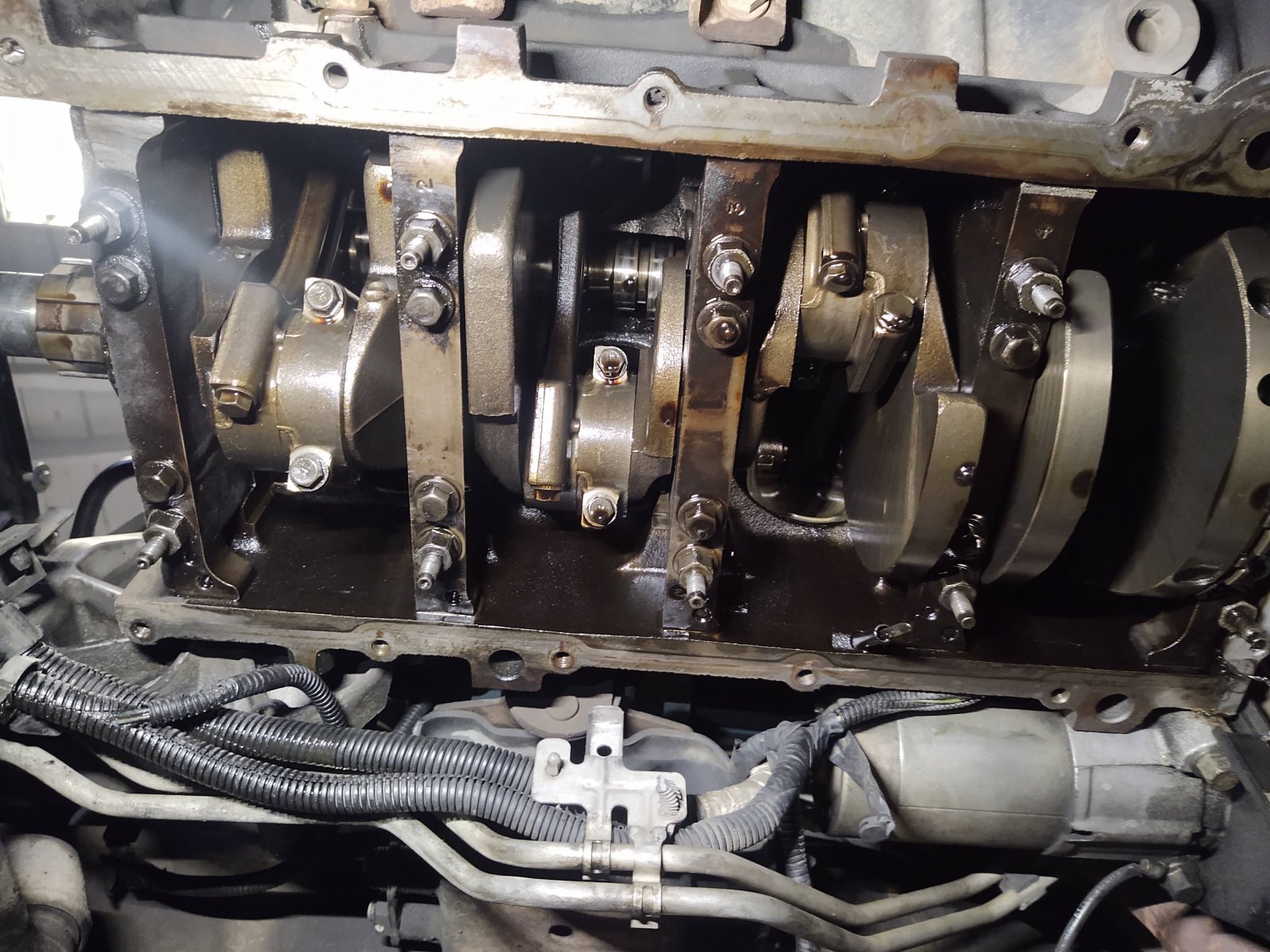

After much scrubbing and cleaning, I finally got the oil pan completely clean. Then I removed the front timing cover, and thankfully saw that the rest of the engine although not exactly CLEAN, had nowhere near the amount of sludge that the oil pan had. IMG_20211030_183140784.jpgIMG_20211030_183033324.jpgIMG_20211027_112049566.jpg

With all that sludge and over time, the low oil pressure, I would be worried about crankshaft and camshaft bearing clearance. Sorry to say that the damage may already be done but yes, double check that o-ring. With the sludge from before you may have drain back problems at the heads as well.
