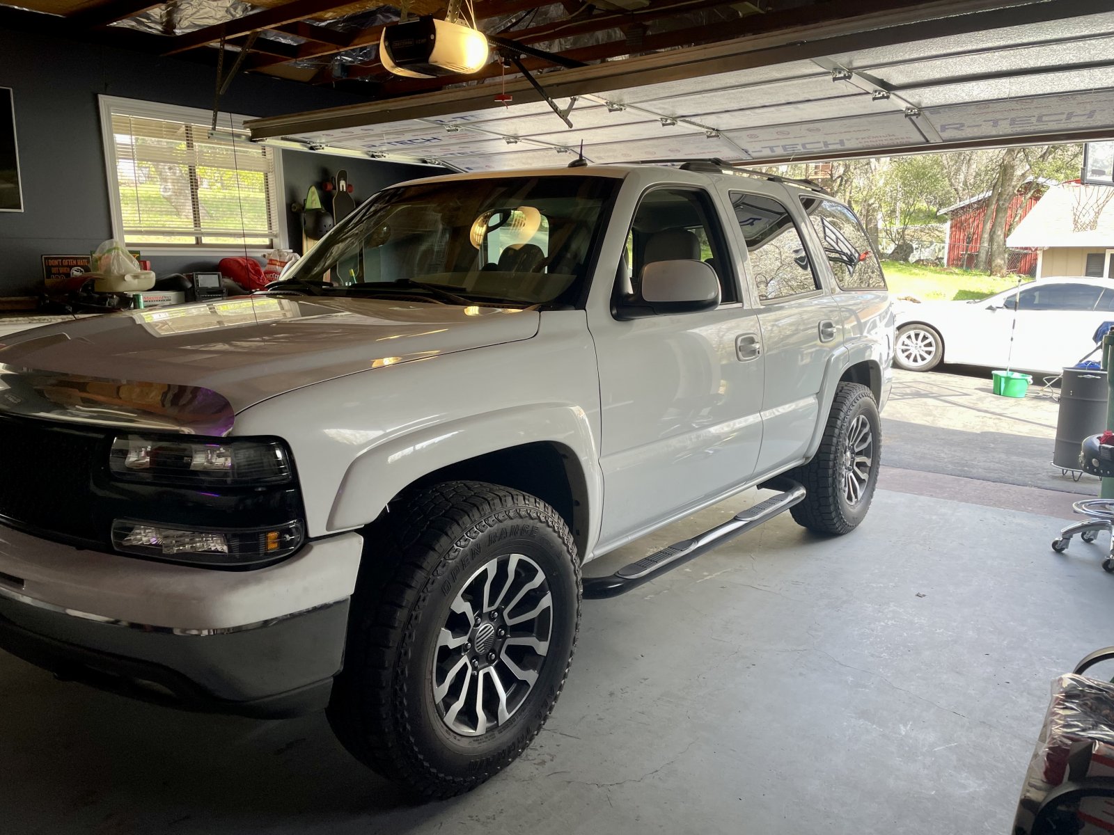

I installed a lift kit on my 03 Tahoe over the weekend. New keys, front shocks, control arms, tie rods etc. prior to the lift, I measured 36” in the front. Post lift, I’m at 38.5” when I crank the keys where I want them. Then after I lower it to the ground and drive around the block I’m down to 37.5”. I’ve done this a few times, crank the keys, it perfect, then soon as I back out the driveway it drops again. I do have the Autoride setup and did not do anything to the rear. Not sure if that matters, just throwing it out there. I have a few more turns I can go on the keys, but wanted to pause and check here first.
Question is: Any reason why it would drop back down?

ok so anything you do to a suspension changes the position of everything. if you do any suspension lift without an alignment it will chew your tires apart. some cheaper kits are literally for your mall crawlers and show trucks so getting perfect alignment isnt necessary. back to the original question as to why your seeing a drop after you drive the vehicle is the tires and suspension and settling back into its loaded state. unless its a solid axle vehicle when you lift a vehicle the front end sits like \/. once your drive it everything settles back to as close to l l as it can get. i would also note most kits especially key kits are capable of going beyond what the drivetrain is actually capable of. the mfg assumes the end consumer is either using a shop thats already aware of this or has done thier research and is themselves aware of it. so if your vehicle is safe for 2 inches and thats what your after you will have the push the keys beyond what your currently doing so it sits at your desired height after a drive.

Thanks. That makes sense and I’ve read that that somewhere before. I’ll crank the keys some more and see what happens.
