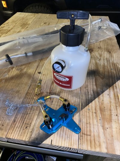

I’ve had the best luck with a pressure bleed using a Motive bleeder (looks like a garden hose sprayer) with a BA14 adapter:
You’d connect that to the Motive line with an automotive x industrial quick disconnect. Or a “universal” one works just as well. Add a ball valve in the line to help control spills.
