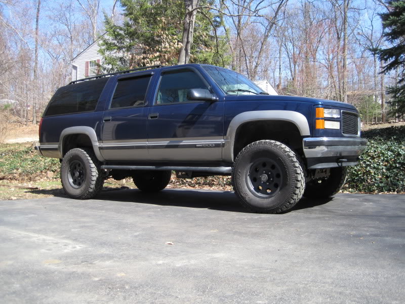

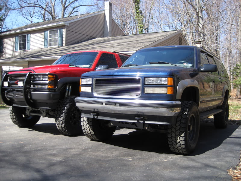

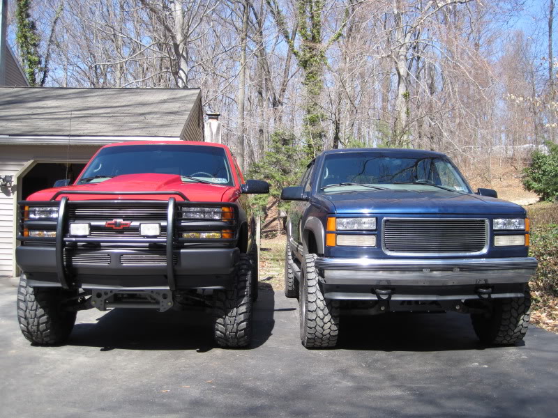

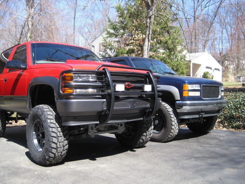

The rough country kit is a great kit, fits great and is built well. The old version of the kit was not the best thing in the world but teh new ones get great reviews....I run one on my suburban. I run the cepek on my 2 dr tahoe and I love it too. It is the tallest 6" kit out there. It give a full 6.5" of lift with out having to crank the bars. My rough country is about 5.2" drop and then crank or uncrank from there to get the 4" or 6" kit. I spent a little over $1K on the RCX kit and couldn't be happier so far.
both kits side by side. The tahoe is cranked about 1.25-1.5" and sits 3" taller than the suburban. Same size tires on both.
Listen to this man, he is the guru of OBS lifted Tahoe's.
