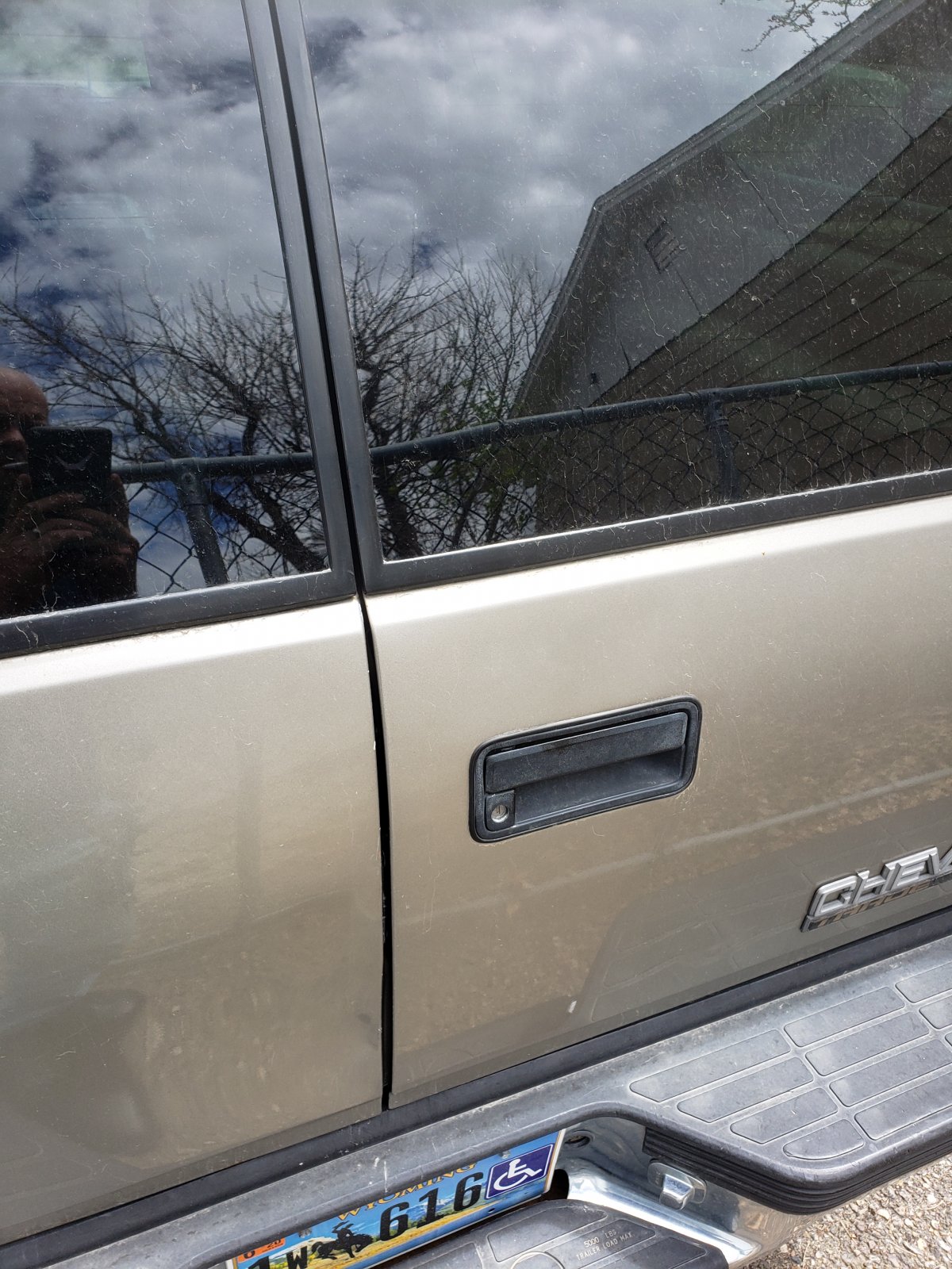

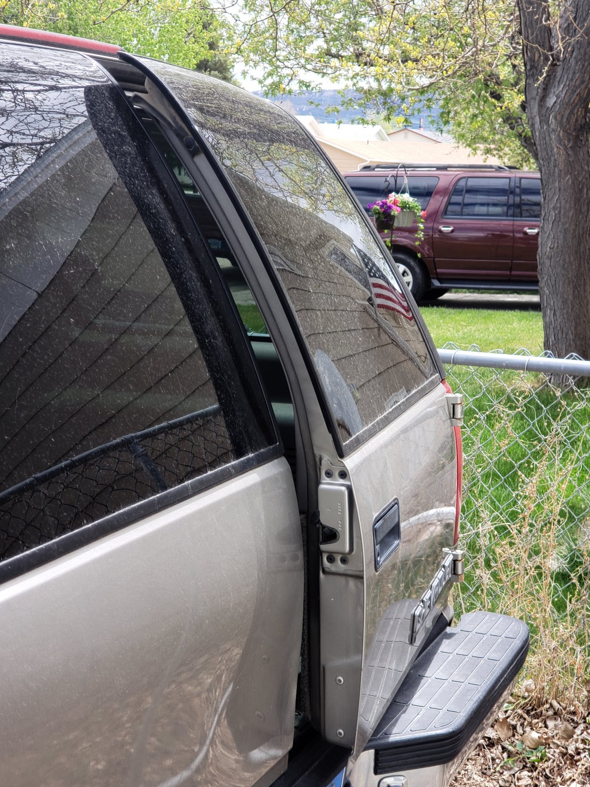

My 1998 Yukon barn (cargo) exterior door handle won't open the door.
Here's what I've done so far:
Please help!!
- Pulled the interior carpeted panels from the barn (cargo) door
- Checked the actuator - it works both with a key in the lock and with the power door lock switches
- Checked the small rod connecting the exterior door handle to the latch that should open the door - it is broken
- Manually moved the latch from the inside of the door that should open the door (I can hear and feel the latch lifting) while someone outside used the handle to try to pull open the door - the door still won't open
Please help!!
