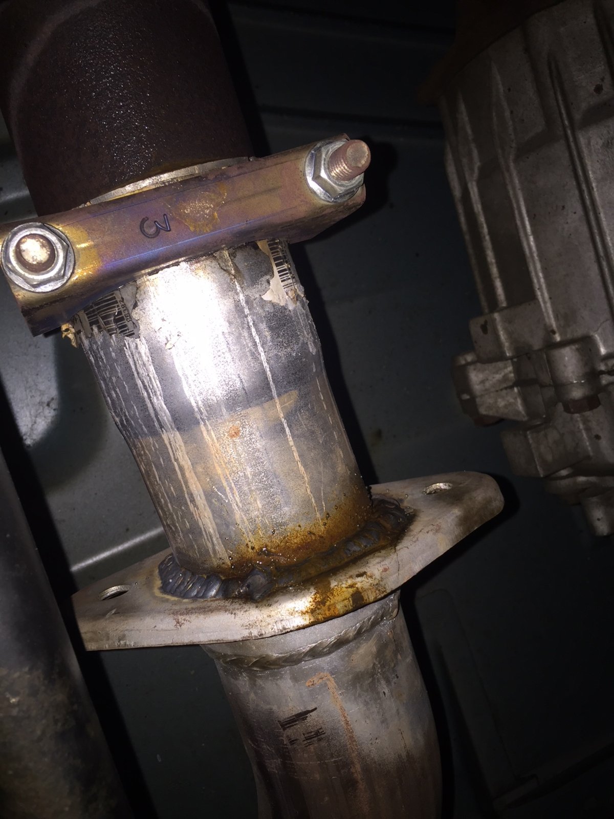

Just an update here. I didn't bother to look at how they actually fitted the new Gibson system to the rest of the exhaust until now. I'm not really pleased about it. As I said, the previous owner took the truck to a shop and for some reason they cut part of the pipe that comes out of the catalytic converter, including cutting the flange. Not knowing this, the shop I took it to had to come up with a way to connect the Gibson cat-back to the rest of the system. It looks like they welded some kind of exhaust sleeve into my really nice and expensive Gibson piping and clamped the other end of it to whatever piping was left over on the rear of the cat. Is this the definition of shoddy workmanship or is it genius? Either way, I don't like that it isn't properly fit to the truck. Very important question, if I want to replace the y-pipe and cat in the future, can this "weld" be taken out of the cat-back portion or does that flange now have to be cut? Basically I do not want to have to modify the cat-back portion of the system at all. Had I known this was necessary I would have just purchased a new y-pipe and have it connect properly via the flange. Not sure what to do here...picture attached.

Is it just me or could they have just used an adapter with a flange on one end? I know I have seen those before, maybe they didn't have one on hand? Instead of WELDING one end of the adapter into the cat-back section, find one that bolts to it! Guessing I'd need one with a 2.5 inch inlet and a 3.0 outlet since that is what the cat-back section is?

if you take that clamp off and heat the pipe you could probably just pull the y pipe out. yes they could have just welded on a new flange. its not too terrible tho that sleeve can be cut back off the flange can be smoothed back out and properly fitted to a new y pipe if you wanted.

Great, thanks. I think I will take it to an actually muffler shop. Lesson learned. Can I keep my existing y pipe and cat even though the flange is gone? I’m assuming they could just weld a flange onto it or just use an adapter with a flange built in? I know Flowmaster makes a direct fit y pipe with a cat for about $190 shipped. Pretty tempting as long as that weld can be taken out. What I DON’T want to do is cut any part of the Gibson section.

Ive NEVER seen a proper exhaust shop use a clamp like that? Why they didn't just weld up a 2 bolt flange is beyond me as opposed to welding a 6$ reducer to the flange face. If i saw that unaware of your story id assume you had some guy of craigslist do it in exchange for a 12pack.
