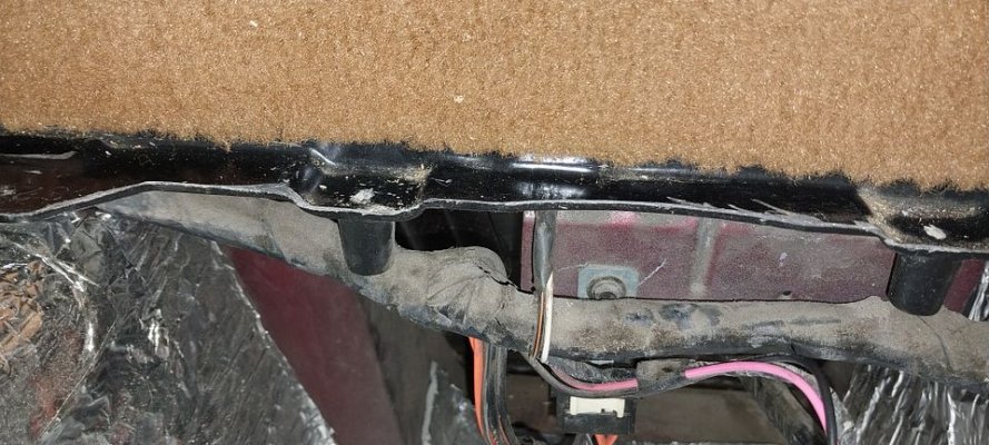

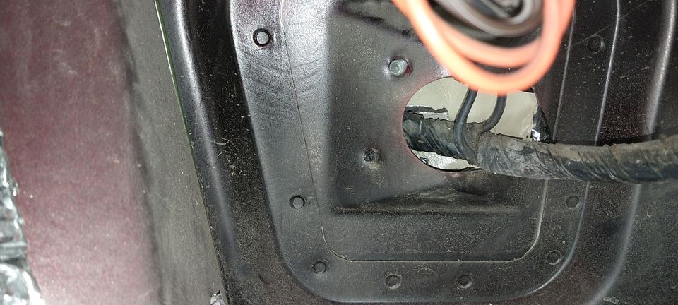

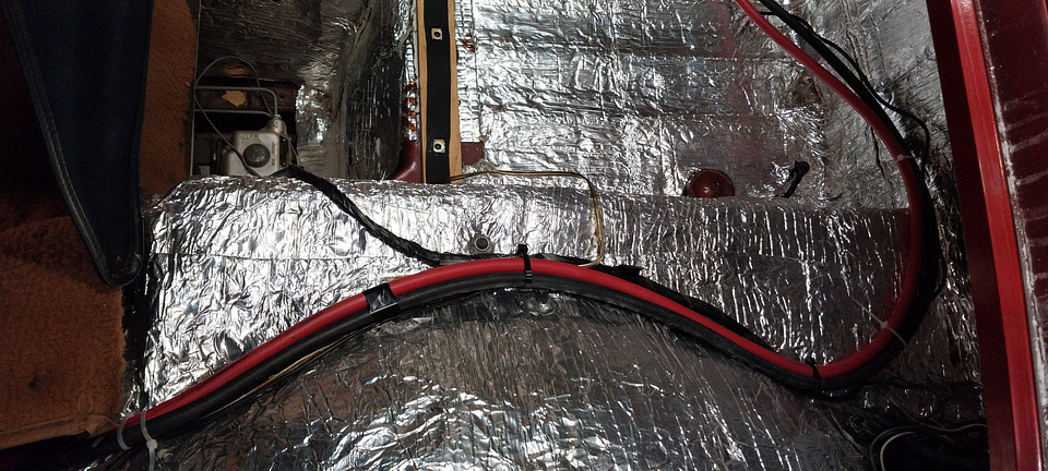

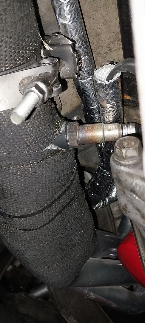

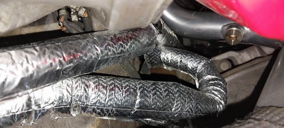

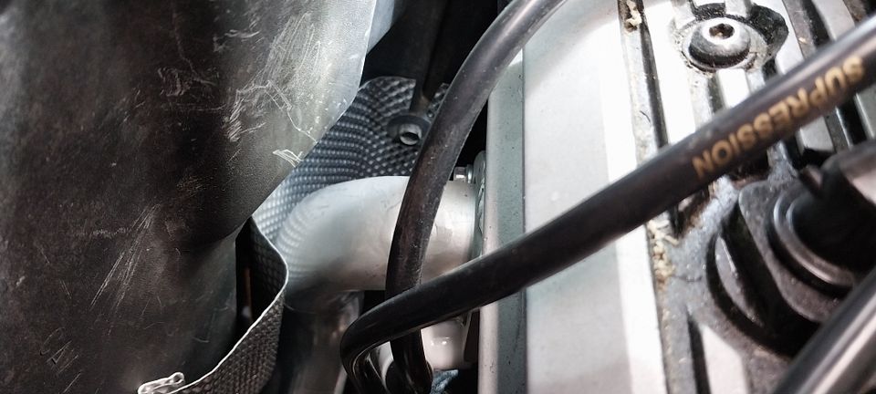

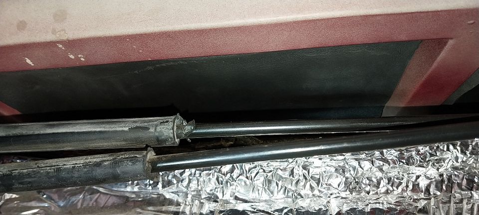

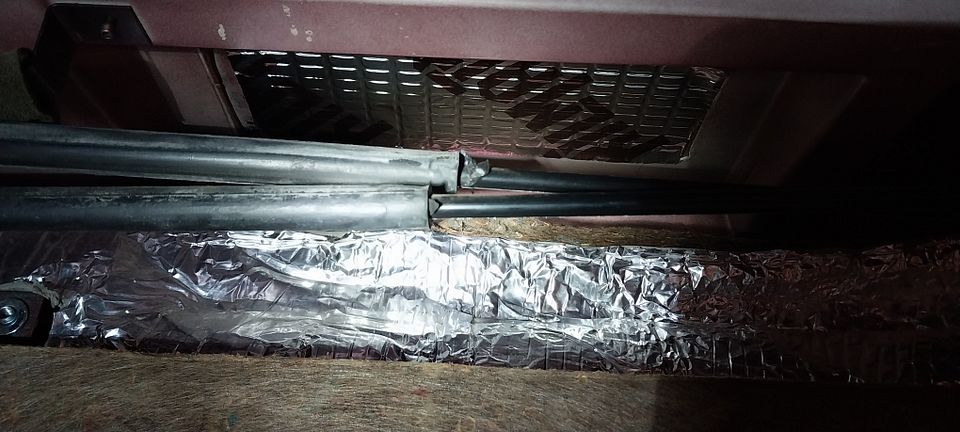

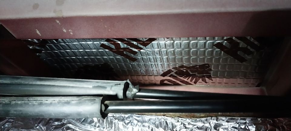

I am still doing heat management after the header install. None of it has been mandatory, nothing has burned and it has mostly been just to prevent any potential issues and to make me feel better.
Clutch line, O2 wire and others in the area covered.
Starter wires and i think the knock sensor wire covered.

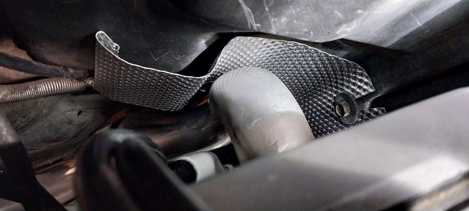

I made a small shield to be between the header and the A/C box, it is a little close in this area and I didn't want to scorch the box over time. The shield has about 1/4" minimum on all sides (more in most places) between the heat and the box. It does rest on the box in the folded are which is well away from the heat. It should work just fine.

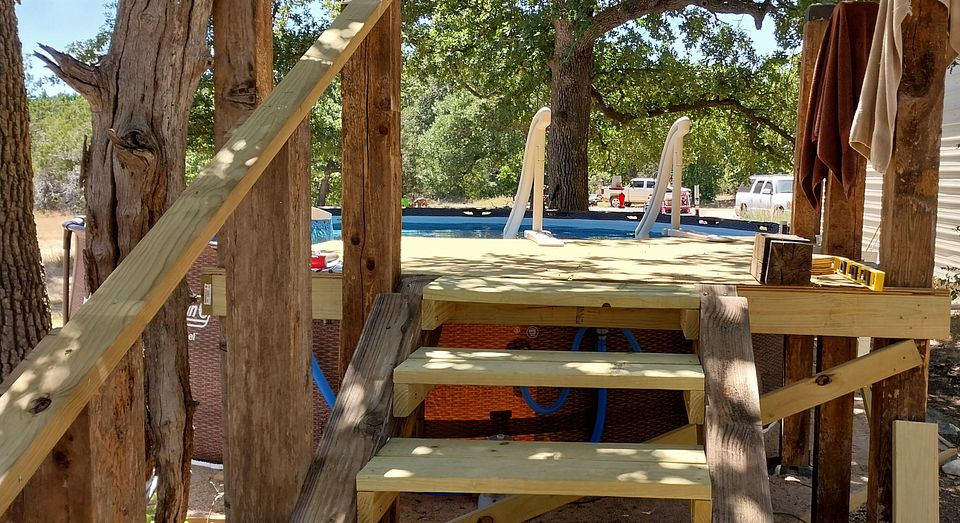

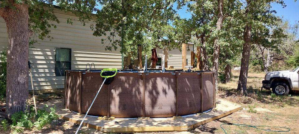

When we bought this property we had wanted a pool, after discovering the shelf rock that is about a foot under the soil we decided against it, the excavation cost and the need to blast rock made it not economically reasonable. In late June I decided a cheap above ground pool would be acceptable. The only real issue is the property isn't level so I would have to make a pad that was. I am still recovering from my latest heart episode so it took a while to get the pad built, the initial leveling was easy, I used the tractor to do it, the fine tuning was harder, I shoveled two 8' pickup loads of sand for the final leveling, that was fun. The other issue with an above ground pool is my wife has a couple of hardware stores worth of metal in her ankles and knees, climbing over a ladder to get in and out of the pool wasn't going to happen. I had plenty of old 6x6 cedar posts and grabbed some treated lumber and went to work to make a platform and stairs for her. I still need to do the hand rail, outdoor carpet and build a bench but it is functional. The pool is 18' and 48" tall or about 5,000 gallons of water.
I placed this between two large Oaks to keep the water from turning into a warm bath. It does mean I have to clean the leaves out daily but that is ok, the water was 80 degrees when I checked this morning. That feels good on 105 degree days.

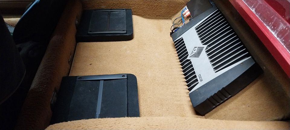

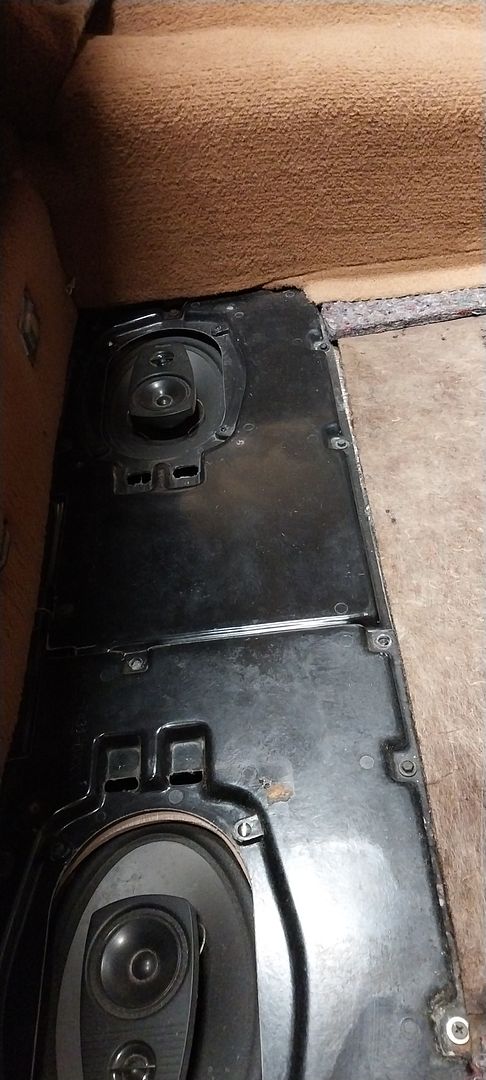

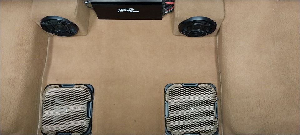

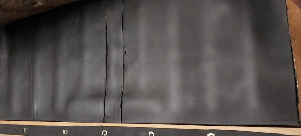

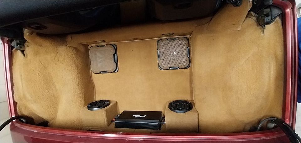

I have done a little work to the car. The Borla's do have a little drone right at 1800 rpm, it isn't bad and I have been shifting gears to keep it out of that range. One area I did not address with sound deadening was the area over the top of the deck, it rings like a drum and I can make it a little better.
There are a total of four of these indented areas to treat across the back of the deck.
The indent in the middle got a layer of 80mil KilMat.
Then the area over the middle indent got another 80mil layer making it 160mil.
After the KilMat I put 1/2" medium density foam over it.
This really made more of an impact on the drone than I expected. Sadly I cannot do the same treatment to the deck lid, there is an outer and inner layer that appear to be bonded together but with hollow areas that will ring. I could give it the same treatment but it would be ineffective at quelling the ring as the outer layer is what rings, putting a dampener on the inner would only slightly muffle it, not enough to make a difference. I may order up some more foam and at least insulate it but that can wait.
While I had all of this apart I decided to foam the back wall that separates the fuel tank from the cabin. It already has a layer of KilMat and Frost King on it, a little more insulation cannot hurt so add another 1/2" of foam to the thickness. I also added a layer of foam over the rear floor so it also has a layer of KilMat, Frost King and 1/2" of foam. Now the back compartment is all the same thickness. I cannot do the wheel wells the same, the carpet won't fit but they have the KilMat and two layers of Frost King on them.
The floor foam, I had to add in a small strip in the middle.

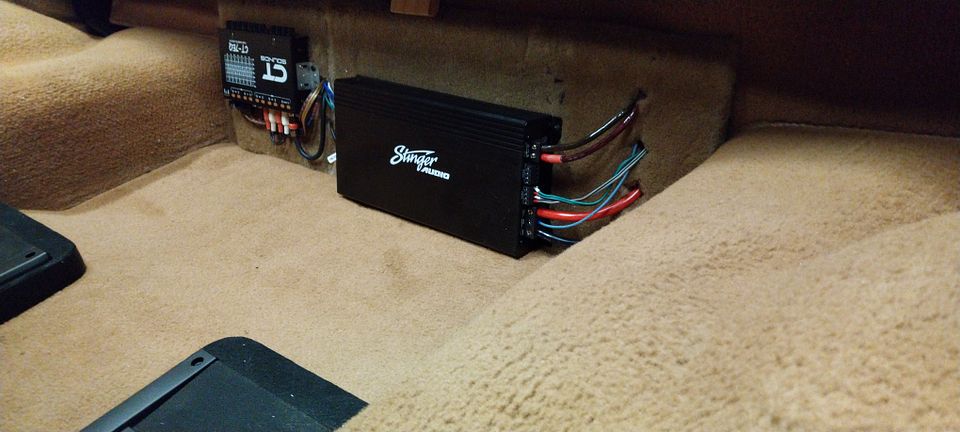

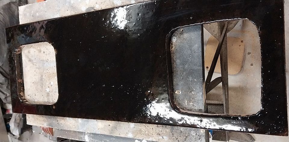

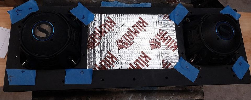

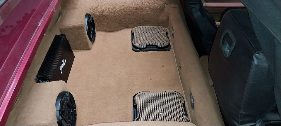

Since I was already in there, with the sub out I decided to change the sub layout, going from one ported sub to two sealed subs. The ported layout had one flaw, it gave up some volume at certain frequencies and was louder at others. Not what I had expected but it did. I had already purchased another 8" Solo-Baric I had intended on putting in the Yukon as the old 12" JL finally died. Instead I did the math and discovered The total volume would be adequate for two subs in a sealed enclosure. Simple enough to make another baffle and add a second sub.
Medium density particle board that I fully glassed. Somehow the pics of the process of glass the baffle got lost.
Figuring out the series/parallel wiring with a little KilMat across the middle.
I found some appropriate Kicker grills to cover the subs with. When I looked for these grills initially I could not find them, I am glad I did this time, they look better than my home made ones. I had some SEM Cognac dye/paint left over and covered the metal grills with it. If I would have had more I would have done the grill surround as well but I don't think it looks bad as is. When Mid-America gets back up and running I will order a couple more cans of the Cognac to have on hand.
No flash, this is how it actually looks to the eye.

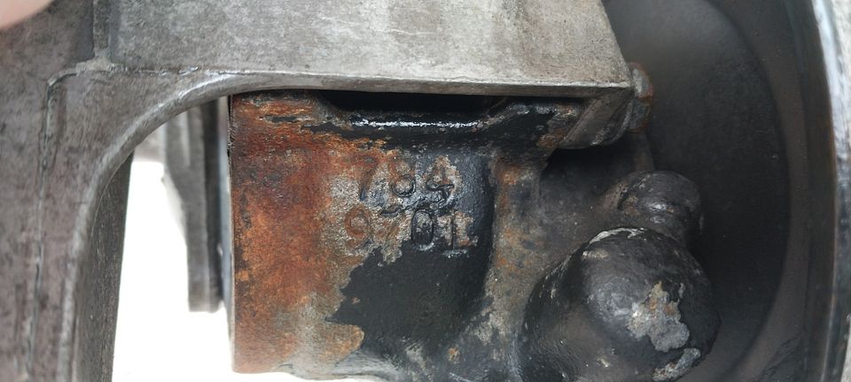

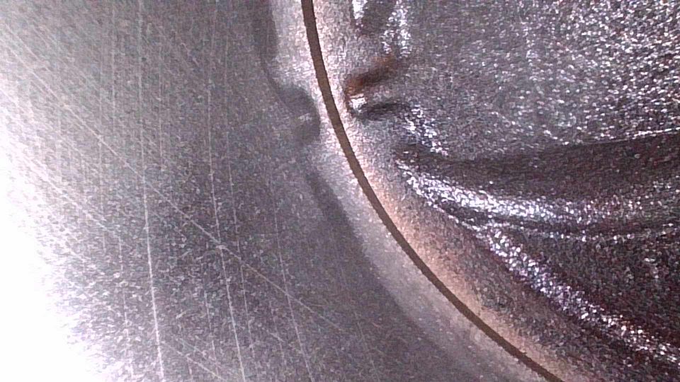

The piston, a stock L31 style dished piston. When they swapped the stock C4 block to this one they did not change pistons. I was surprised by how clean it is and it is in keeping with way this block change was done, they just put all of the old stuff back onto the new (junkyard) engine.
The other surprise is how clean the bore is, and how much crosshatch is there. I suspect they did a dingle ball rebuild of this block and little more. I expect to find a stock L31 cam in it. I think a Summit SUM-8800 will be called for.
I used a feeler gauge to check the current head gasket compressed thickness on the edges of the head, at least where I could get to, and got .034-.035 on both banks. Not completely accurate but close enough. If I did my math right, my static compression should be about 9.7:1 with an 059 quench. The stats as close as I can find with internet info. This engine doesn't really like 89-89 octane gas, it runs so much better with 91-93, now it makes sense as to why.
Bore = 4"
Stroke = 3.48
Cylinder head volume = 58cc's
Piston Dish = 12cc
Head gasket = .034
Head gasket bore = 4.06 (a WAG but from a Summit search of SBC head gaskets, it should be close.)
Deck Clearance .025 (Some forums show .02 and others showed an actual measured .025 so I went with .025.
I am strongly considering just doing a pocket/light port (bowl and chamber cleanup, straightening the pinch lightly and an 80 grit finish) on my stock 113 heads with new springs and valve seals and a check of the lifter rollers. SuperRitchie managed to make almost 400hp with a set of stock 113's and a dual plane and decent cam. With the ported TPI I have no expectations of even getting close to 400hp, I would be happy with anything around 250 whp if coupled with a Summit 8800 cam. It is difficult to justify the expense of new heads with an induction setup that won't be able to take much advantage of them and I am not really going for the max I can extract out of this engine, I just want a little more than it has. I will have a much better idea of what is really here once I get the heads and cam out, but I am not expecting any surprises this time.
I would welcome recommendations, criticisms, a math check, specs check, etc. I have tried to cover all of the bases but I am sure I am missing something to be discovered later.

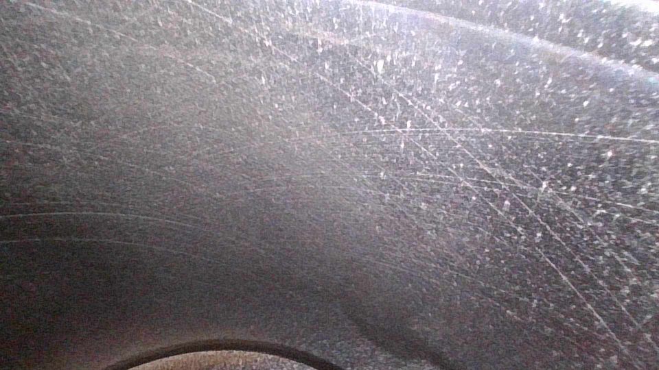

I have done some actual work to the car tis week. When I got the 1990 wheels one did have some damage and I have been casually looking for a replacement since I got these. I found one for a price delivered I was happy with. It is in great physical condition but terrible cosmetic condition. I can fix that.
What I started with.
The clear was badly stained and faded. I stripped it all off and as expected the aluminum beneath it was also stained with a few minor scratches and dings. I knew that if I sanded out the stains and scratches the finish would no longer be correct. It would be more work than simply stripping the clear and re-applying. My goal and hope was to make the "new" wheel match in color and texture to the existing ones, if I did not then then I would be doing all of them to make them the same. I went ahead and sanded and polished out the stains and most of the scratch depth, which of course left me shiny wheels that need to be matte. I did a test with matte clear over the shiny and it was not matte enough to be a close match to the original. There are really 3 textures here, first, the rough insets where it looks to be painted or just rough aluminum, the color is darker either way. Second the matte face and third the more shiny exterior ring.
I played around with grey spray paint to approximate the color of the existing wheels inset parts. I got really close with a light dusting of high heat aluminum paint. I masked off the ring and face and sprayed the insets. After it dried I heated it up slowly numerous times, hotter each time to help it finish curing. I masked off the insets for the next step.
I had tried to get the matte texture on the face with sanding and buffing, nothing got it close enough, I needed a different plan. I got a cheap Inokraft hand held sand blaster and 10 pounds of #12 glass beads. This was a messy task, but it gave me the matte texture I was looking for and was fairly consistent. The glass beads are definitely the way to clean up the aluminum.
I lightly polished the outer ring to give it the shiny appearance. Now I am left with the task of clear coat. I used the Spraymax gloss first, mainly for the shiny ring but it should help protect the matte portions as well. I knew I would either need to wet sand the shine off the matte portion or go over it with a matte clear after the gloss cured enough. The wet sanding worked but not well enough, it had consistency issues. It let it cure enough, masked off the outer ring and went over it with matte clear. It got pretty close to what I was hoping for.
Before the clear coats.
I did not work very ******* the inside of the wheel, maybe I should have but it is never seen and will just get filthy again quickly. I did remove most of the brake dust and the remnants of the weight adhesive. It is stained and ugly but otherwise smooth and clean.
I am sure I will need to do the other three wheels in the future if I decide to stay with these wheels. I do still have 5 of the 1989 wheels but I actually like the looks of the 1990 wheels better. It did keep me busy for about 10 days.
I haven't decided on replacing the center caps or trying to refinish them. They are plastic and still available but I always am concerned with the quality of non-oem parts. I know in the future the 17" tires will be going away just like the 16" have. I will probably roll with these until the 17" is no longer viable or too expensive to justify. I will probably be dead before that happens, so we will see.

Things have progressed and regressed in the past few weeks. The wheel refinishing was a huge success, as far as how it looks, unfortunately it is not close enough to the other three, the difference in being a machined face versus a lightly polished face. I have found no way to make the refinished wheel match close enough to the OEM machined face. This means having to unmount 3 wheels, finish them the same as the one I already did and remount them, or look for a different option. I went with the different option, I will get to that at a later time.
I decided to double check the measurements of the spring pockets in the 113 heads to see what springs would work the best, I found so much conflicting information it was wise to check. I managed to strip out a valve cover bolt, I had a tough time getting it out. I decided to not have that issue in the future and picked up a set of ARP 100-7509 hex head 8740 chromoly valve cover bolts. I can't really complain, the originals are at least 37 years old and the ARP was only $40 dlvd, some other options were way more than that.
I had a little smoke fest, my amp blew and took out both Solo-Baric subs, not a good thing to watch happen. I racked my brain for almost two weeks trying to figure this out, Stinger amps actually have a very low rate of failure, almost non-existent with the newer line. The Solo-Barics were not being driven hard and unless in a marine environment have a low failure rate. Kicker pointed at Stinger, Stinger pointed at Kicker, as to be expected. In diagnosing and researching typical failure points and going over all of it with Stinger, two things came to light, poor grounding was the first thing to check, I did not expect a poor ground so I metered it out, I had to go to the 200m scale to get a reading of 0.0009 ohms, I am not sure it is possible to get a better ground. The other failure point is low voltage. My battery lives on a tender and has been rock solid, at least it was, though it is almost 6 years old. My battery developed an issue, it will charge to full with no problem but will get down to 11.5 vdc in an hour with nothing attached to it. That is not good, it had to be a recent development as the car has been off the trickle charger numerous times recently. Low voltage could easily have taken the amp out. I don't believe I have ever had an amp smoke, I have had DOA amps before but never one that was over a year old die, for any reason. The amps I replaced the Stinger with handle low voltage much better, just in case.
I did not replace the amp with another Stinger, I decided to go separate amps, a D4S mm1000 for the sub and a Soundigital XP440 for the mids and tweeters. I did not go back with Solo-Barics, I don't need the bump as much as they could provide, instead I went with a more SQ sub, CT Tropo-8's which do not have the raw output but make up or it with sound quality. In early testing with the ample power of the MM1000's the Tropo-8's have more than enough output while providing clean bass. I am less impressed with the Soundigital XP, I had originally ordered a Taramps TS-400 but it was a little too noisy, not bad really but not great either. The Soundigital is cleaner, but still not as good as the Stinger was, the difference is amplifier architecture, the Stinger has less wattage and a worse signal to noise ratio but still sounded cleaner. On paper the Soundigital is the winner, in practice it is not. If I could find a clean way to fit a smaller Stinger in I would have but space constraints are real. I have ordered a true DSP to go inline before the amps and I can tune it with REW and a calibrated mic. The laptop tuning software follows the same convention as the DSP-408 I use on one of my home stereo's so the learning curve will be minimal. That should be the difference, at least I hope, if not I will need to get away from the micro amps and go mini amp, sacrificing the space I don't have.
The new subs, this may be a temporary installation, I ran out of board to make a new baffle with so I improvised but that meant raising the total baffle height another 3/4" when I just reduced it by 3/4" a few months ago.
Each sub is dual 4-ohm, I ran each voice coil in series and then used the 4 amp inputs to parallel them back to a 4 ohm load. This fit in nicely with the power needs of the Tropos.
I installed a different power block, one to handle the 4 gauge and 8 gauge needs of the two amps.
It's a lot of wiring. One change I had to make was to add a line driver for the subs, the Atoto only outputs about half an ohm for the sub output, this was fine with the Stinger but the MM1000 really wants more even though the specs say it can handle the .5 ohms, I had to crank the gain almost to full to get my A/C voltage to the sub leads. Adding the little Recoil line driver allowed me to keep the gains lower, this will help with noise. You can see the line driver on the left side.
The (never) finished project.
Obviously I had to get a new battery, I decided to get another Optima, I have a Red Top in the Yukon and it has been rock solid for several years. I chose the Yellow Top for the car. It did fit with no trimming, other than the little tabs on outer edge of the battery tray. It locks into place very well and the top posts gave me a cleaner way to power the amp circuit breaker and power lead for the FiTech.
All of this mess made me postpone the engine upgrade/maintenance for a few more months.
