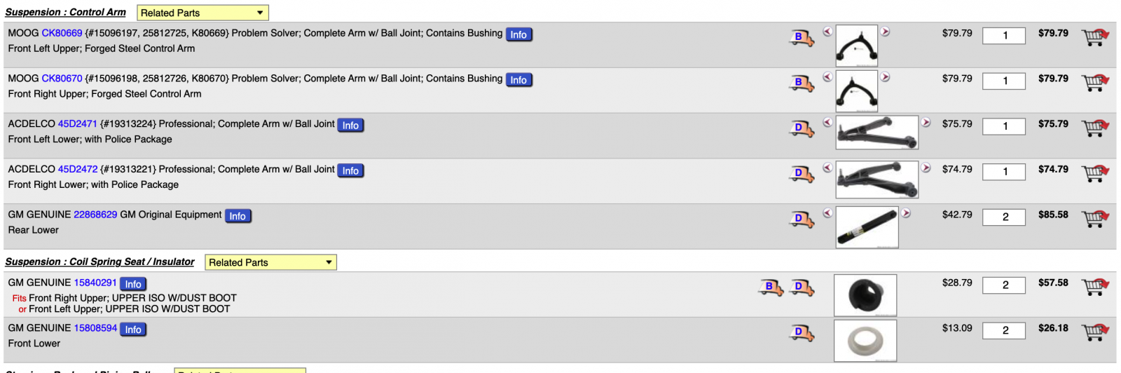

So I have tried to do a lot of research and checking around to make sure I have the right parts but just want some confirmation from people who have done it/have more knowledge than me about these SUVs. I am not trying to do direct factory replacements but just replace with quality stuff.
Rockauto doesnt seem to have the Bilstein 5100 series struts for the front end, anyone have a reputable place to get them online or a local autozone etc?
I am new to domestic vehicles so if I chose a line from a brand that isn't quality or if I forgot anything or don't need some of the stuff, let me know. Also any tips/tricks to make to make it easier would be great. Thanks in advance!
