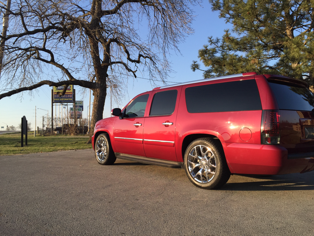

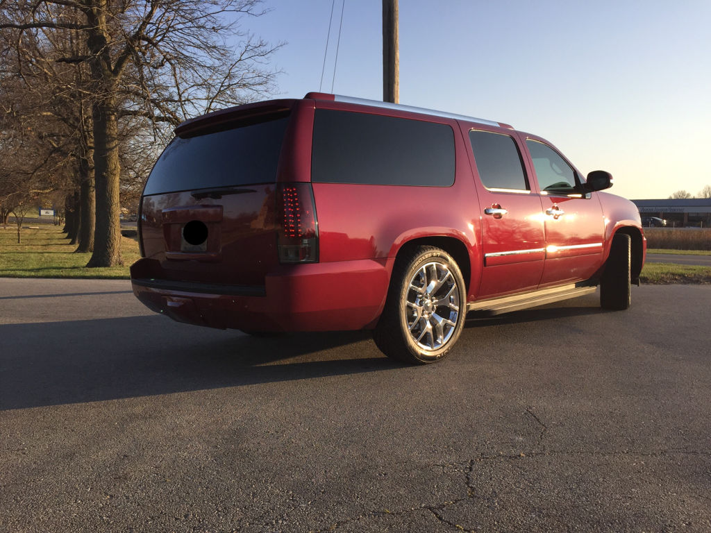

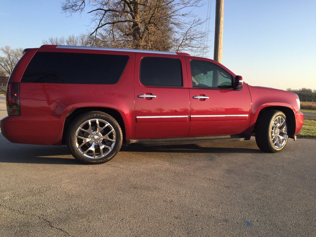

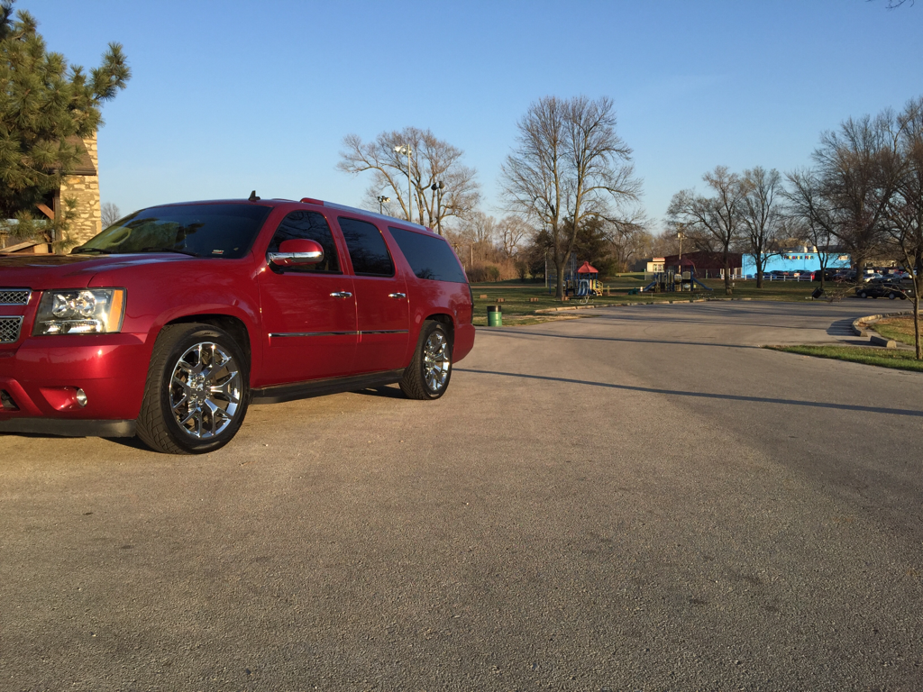

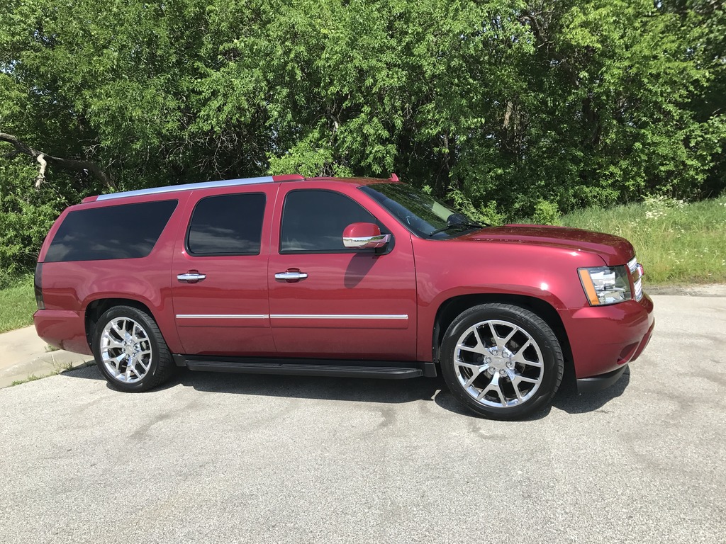

WARNING: This thread will probably only be interesting to me :)
The purpose of this thread is to mainly keep track of what I've done with part numbers and stuff in case I want to reference it later as well as keep an updated "to do" list of stuff I want to do next. I also will keep this first post current with "before" and "current" pics so that I can see how it transforms. Sometimes you lose track especially on slow builds and forget how far it's come. This will definitely continue to move slowly but I've added some new things to my future mod list that I think will be cool. Feel free to offer up suggestions and I may stick them on "the list".
Before (the day we bought it)
Current

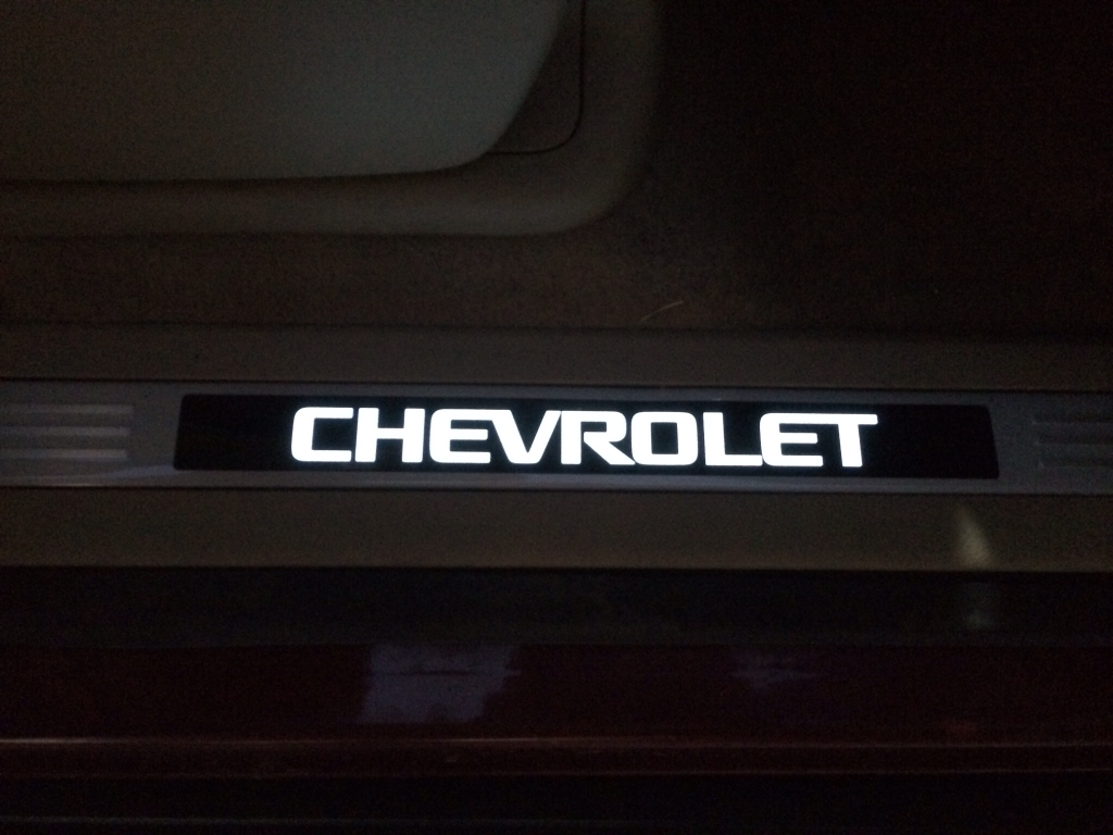

Illuminated Door Sills GM Accessories #338-19171554
Exterior
22" '14 Sierra reps w/Nitto 421q 285/45/22
OEM locking lug nut set (GM 17801711)
5/8" rear spacers
Colormatched front bowtie
Debadge
Rear window "handle" delete
2/4 drop parts list
-----Belltech 5323 (rear springs for 3-4" drop)
-----Bilstein 4600 shock (rear 24-186834)
-----BellTech 2509 spindle
-----Bilstein 5100 strut (front 24-186940)
-----DJM rear end links
Spohn panhard bar
Spohn Rear Upper and Lower Control Arms
Lightly tinted LED tails and Esky 3rd modded to light up all the way across
Yukon liftgate appliqué (GM 22777530)
Street Scene Hitch Cover (950-01005)
7440 5000K COB LED Bulbs (reverse lights -- http://www.cob-led.com/What-is-cob-LED-chips-on-board.html)
6K WHITE 8 LED BULBS (license plate and puddle lights -- http://www.vleds.com/6k-white-8-led-bulbs-194-168-158-2825-1-pair.html)
6K WHITE 4 LED 3 CHIP FLANK BULBS (puddle lamps -- http://www.vleds.com/6k-white-4-led-3-chip-flank-bulbs-194-168-158-2825-1-pair.html)
5% tint over factory tint, 35% on front windows, windshield brow
Esky DL3's
OEM Chrome door handles
Esky Roof Rack
Chrome tow hooks
Colormatched antenna
LTZ grill
LTZ side molding
---15950343 L FRT
---15950342 R FRT
---15950533 L REAR
---15950534 R REAR
