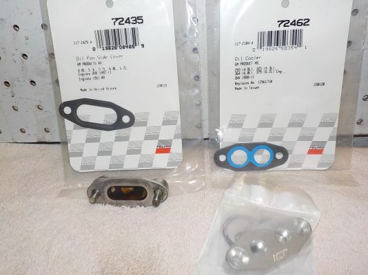

*NOTE*
I used the ICT billet oil cooler adapter for #6 size fitting/hose:
If I was to do it again I would use their billet oil cooler adapter for 1/8" pipe thread fitting:
there's more space between the fittings
and
you only want to run 5 to 10% of the oil pump volume thru the bypass filter. In the long haul 100% gets filtered. So I ground away about half the material between the 2 ports on the ICT adapter so as to bypass both pressure and volume back to the engine and away from the bypass filter. Bypass filters are very restrictive. Forcing too much pressure and volume thru it might damage the internal filtering media. The EaBP90 does have a bypass spring.
I know it is filtering the oil just by touching it a few miles after I leave home. If it's getting hot then you know oil is flowing thru it.
Also, in series to the bypass filter, I added a 1 gal tank to increase the total oil sump capacity and an oil cooler.
I use the Felpro# 72462 gasket and cut the center area between the port out.
