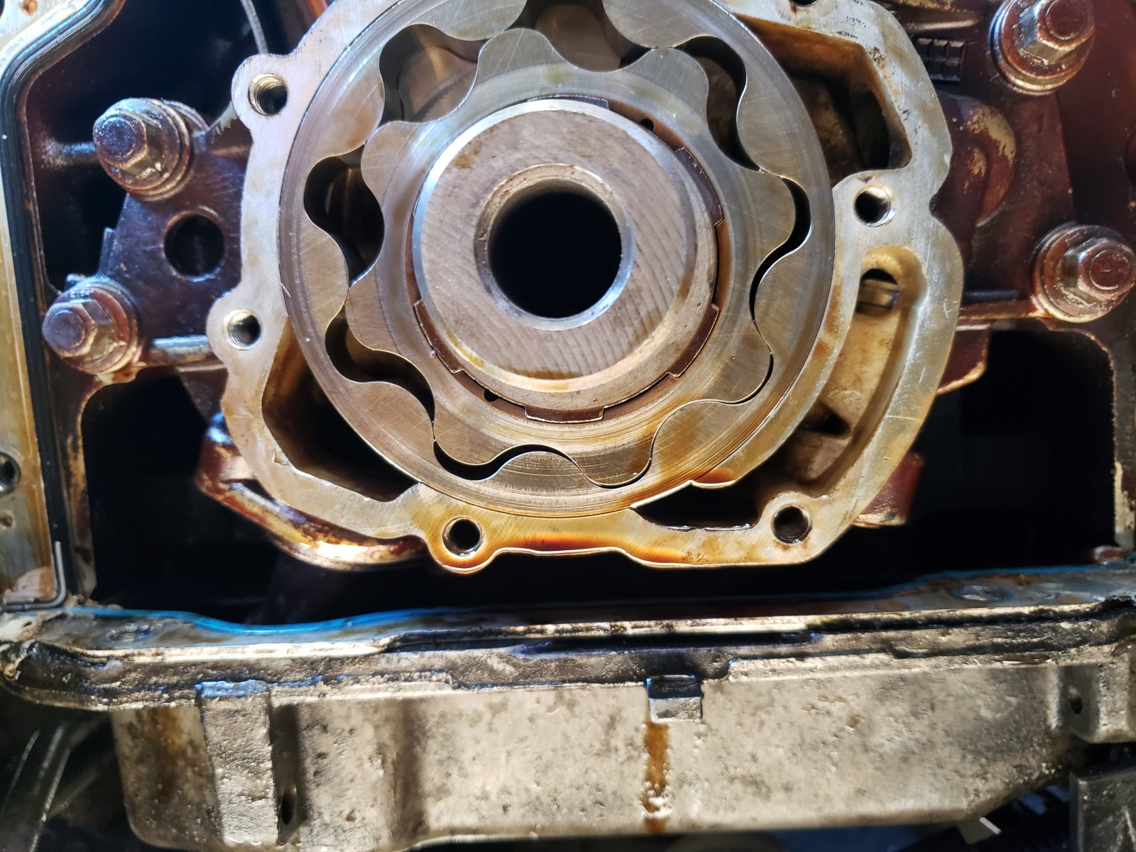

I'm a little worried about the comment that oil pump relief valve stuck open. Do you mean the one on the pump or the one in the pan? And was the one that failed original or replaced when you did the cam swap?
It was the one in the pump, I was told it was replaced @ 180k just before I bought it. It would run 80 psi cold 60+ hot

It was the one in the pump, I was told it was replaced @ 180k just before I bought it. It would run 80 psi cold 60+ hot View attachment 347442
Thanks for that. I installed a new Melling when I put mine back together, along with a new relief valve in the oil pan. It runs 55 psi when cold and 45 when hot, and 30-35 at hot idle. Fingers crossed that my workmanship and parts choices are good enough to cover the next 4500 miles of towing out to Yellowstone and back reliably. My goal was to end up with better reliability than when I started, but when I hear horror stories it always makes me bite my nails. :)
Also, I see that your cam is a 1-bolt cam, so you retained VVT. Makes me wonder if your stalling issue has a similar root cause to the one that guys running the L92 have been reporting for a while, which has 2-3 different potential root causes - one of them being low hot oil pressure not being enough to shift the cam back to idle profile, and another being the printed circuit board on the bottom of the fuse block starting to separate.

No i dont have VVT mine is a LC9 Went back with the Melling I will have to look part number up, but I know low op effected CAM bearings when pump failed. I have low OP now but, it does have some lol . 40cold 15 hot running 15w-50 Till I find a block and do a total build it is what it is. But I don't think that should have anything to do with the hot long crank issue. I like you, was hoping to just have a reliable DD and occaisional TT puller.

M365 oil pump?
