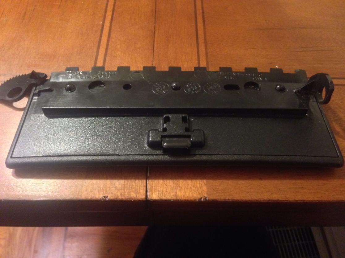

07 LTZ--My change lid broke and after taking it apart it is stamped GM#ANA34676 and PMP #M15299120. I've searched forums, junkyards, and eBay for just this flip up lid (bezel?) and I cannot find it anywhere. Does anyone know where to buy just this part rather than the entire assembly. The only thing worse than the wood grain is the molded plastic! Thanks.

Can't buy just that part, unless someone is selling a broken one that wasn't broken on that lid

Thanks guys. Gonna try the glue/tape route or LT cupholder swap. Just gotta find the part number.

Take a razor blade and scratch the surrounding area with x like patterns on both pieces. Then get some plastic epoxy. Or plastic weld. Should last a long time.

Thanks for the tip. It broke off right where the arm meets the shroud so should be able to get a tight fit.
