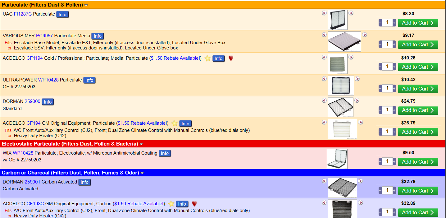

@petethepug
Do you have a part # for that cabin filter? Dont think that the dorman one in the retrofit kit is charcoal activated
petethepug
Michael
May 4, 2016
1,675
1,441
SoCal
Here ya go. There's a less expensive version that's "electrostatic" too. If you go through R/A use the 5% discount code. The GM filters have little cut outs along the edges that allow it to bend so when you install & remove the filter it's really easy to slide in. Most of the others do not.
