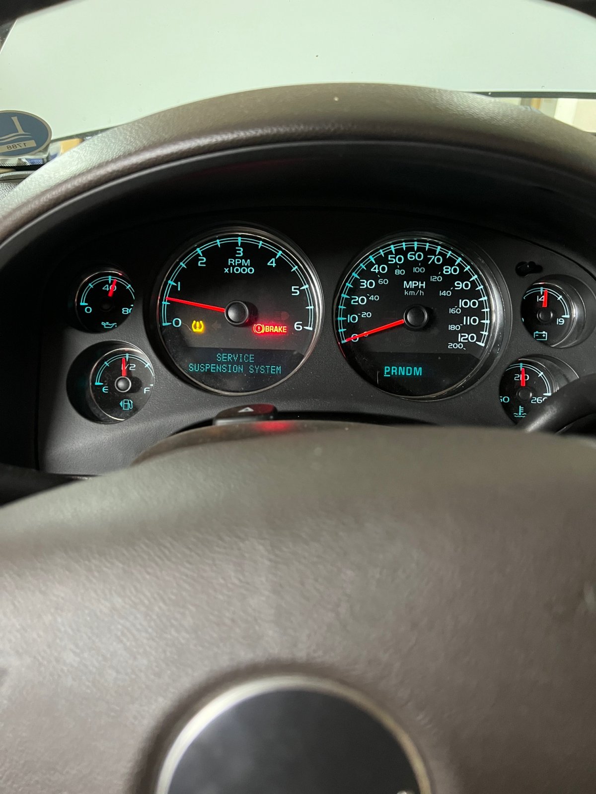

Got it back together today, fired it up. Oil Pressure picked up instantly even though I did not prime the pump. At full temp for almost an. Hour Hot Oil pressure at idle is 40 psi, at 2500 it is 55 psi. No leaks so far so all is looking good. Prior to this OP at idle was dropping to 20 PSI. I know that is plenty at idle but I don’t like low Oil Pressure.,
In this application I have zero concern about the 2 Orings. If one fails the other is there as back up.
I know the suspension alert is on. I am working to bring this truck back to life. I have a new air pump to install and then figure out if it needs new shocks also. Replaced the rear lift gate actuator today, easy job and now the gate works as it should, also installed a new rear window button so it can be opened normally. More work to do but at least Oil Pressure is golden now.
