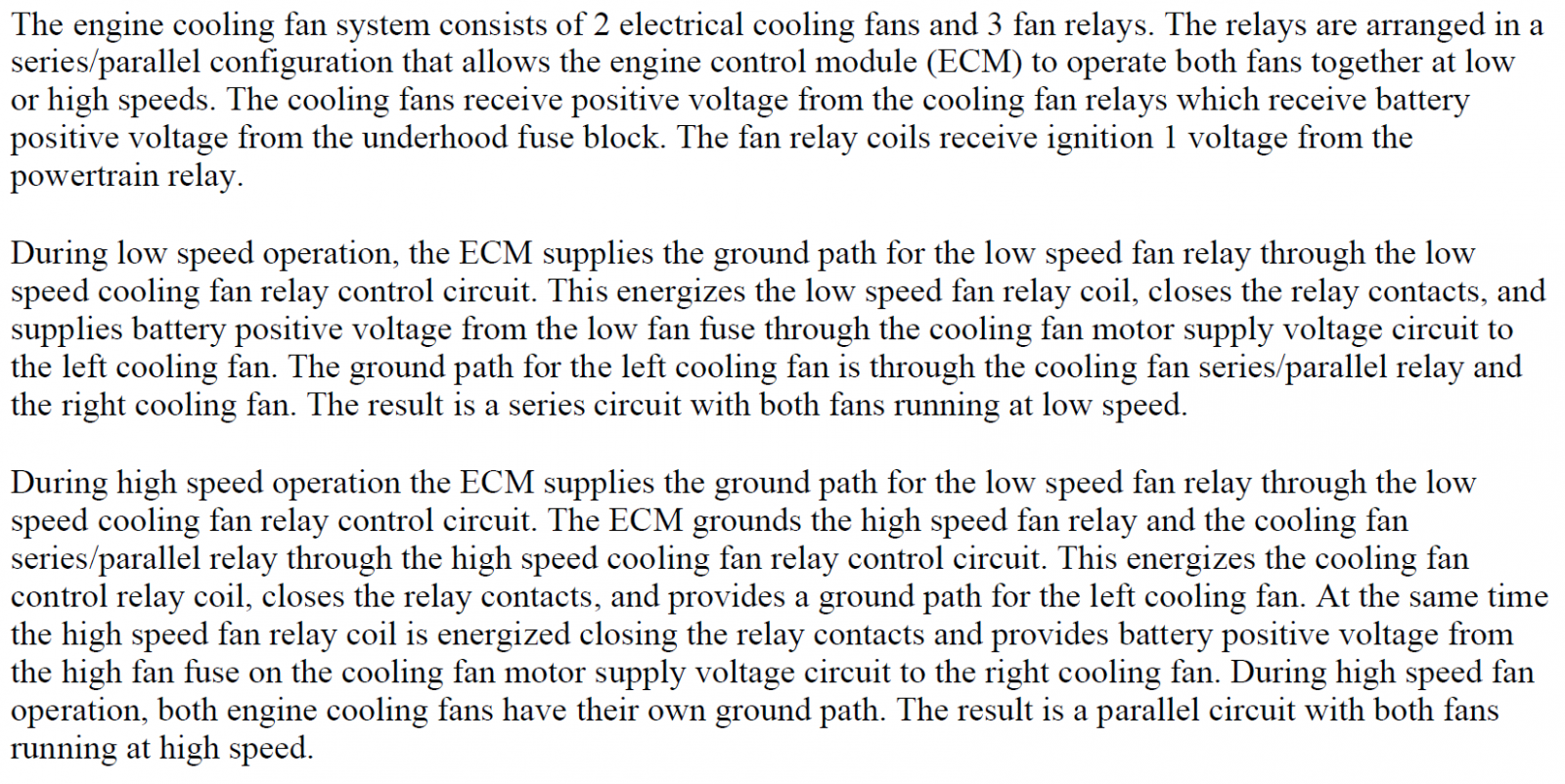

07 Chevy Tahoe 5.3 cooling fan stays on only when car is on and stays on until i turn off my car

I totally just went for the 3 relays and the fans still are the same. Cars r just so annoying especially when your a female haha
If you check your grounds and if a basic code doesn't show any codes, then it is time for a bi-directional scan tool for further diagnosis.
It is normal for both fans to run a high speed and when they do, they move a lot of air and make sounds as you describe.
