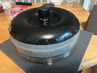

Well, here it is.
Now, can anyone give me some tips and tricks on installing it? Please :)

Make sure (triple check) that the converter gets seated all the way in. The common myth is that it's supposed to be "3 clunks" to get there. I don't believe that's always the case, depending on spline alignment and engagement.
I like to take a straightedge and place it across the transmission bell housing, then measure in a few spots to the converter pads. Not sure what that dimension should be, but you can find that online I'm sure.
Add some ATF to the converter before installing it, of course.
Thank you, I appreciate the help and info
I'll be spending some time watching some YouTube videos to make sure I have my garage situated for this haha.
