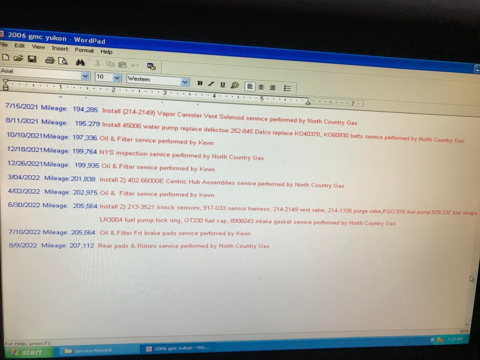

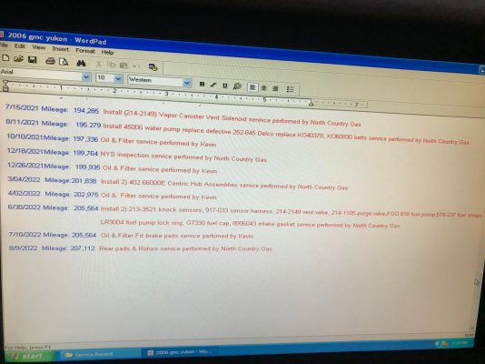

Before buying the owner gave me a list of things he's done since he's owned it...he purchased in 17 from the original owner and now im the third...he has done a ton of maintenance and it shows....all the usual things.
Fast forward to today I get a CEL and I have ptsd from dealing with the CEL on my VW so I go right in to autozone and use the scanner it comes out with code P0327 replace knock sensors and manifold gasket. The only sympton is the CEL, the truck is running fine.
I look back to the list of things done and these were done 5 months ago / only 4k miles since.....
