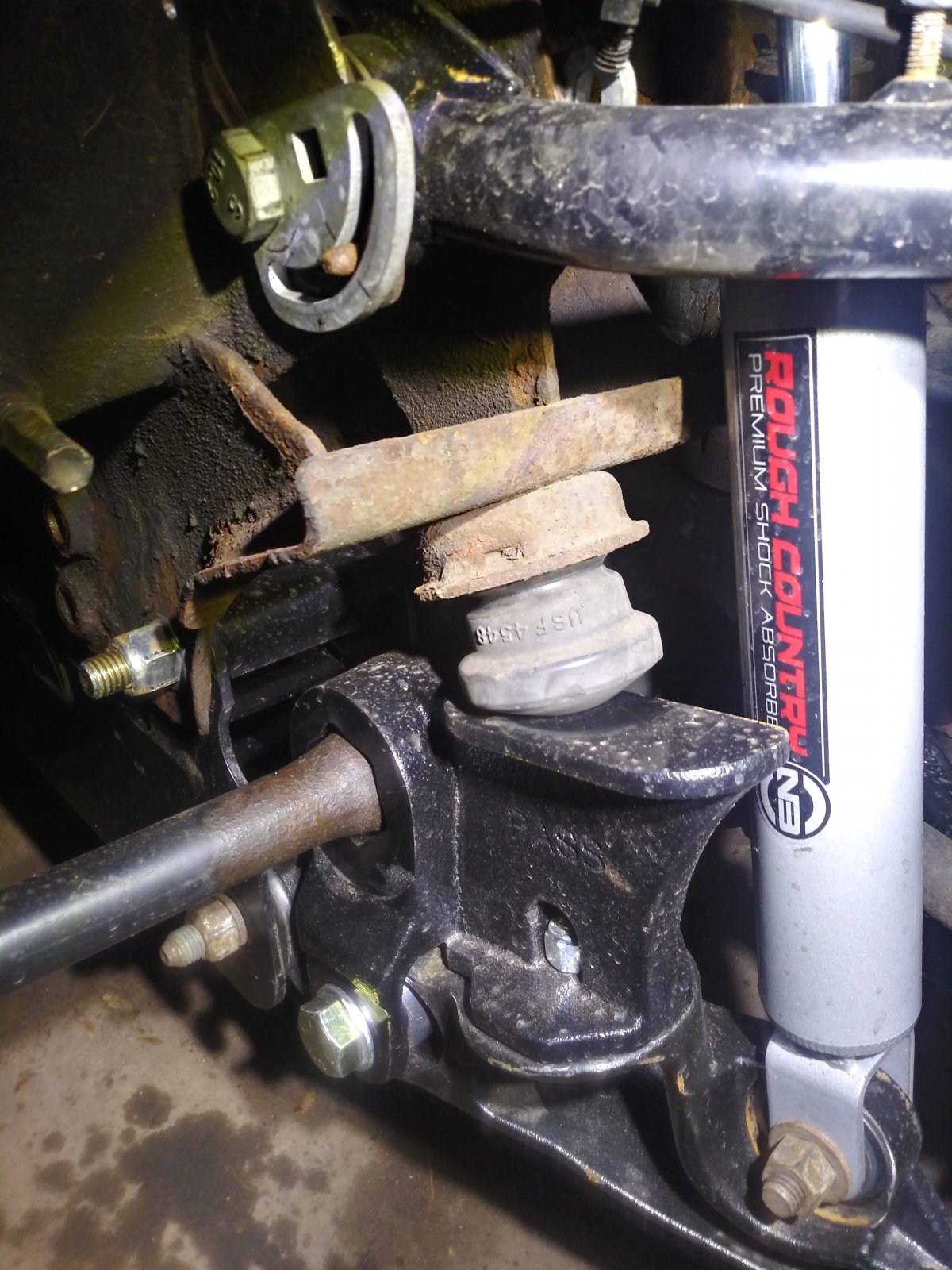

How about a pic of a lower control arm where the jounce stop is?

Drivers side looks like its dropped down more but the keys are adjusted the same amount on both sides and the wheel well spacing is the same from drivers to passenger side.

Is it riding on the bumpstops at normal ride height or are you "flexing" the suspension for your pictures?

yea, im confused why you are trying to decrank the torsion bars more? you need to get it off the bump stops to begin with and see how it rides. you may have to find some stock keys if youre trying to only run 3-4" of lift? not sure never messed with torsion bar front end
the RC shocks should be fine for a while since you already have them.

On a stock frontend suspension you WANT the lower control arms to contact the jounce stops; that's a pivot point for the fulcrum effect. Not sure why it would be any different for a modified suspension.

Only at full suspension compression though - not at all times. To elaborate further, the suspension should be set up in a way where the bump stops are just about never used unless in very rare and extreme circumstances. There would be no harsher ride possible (unless the bump stops fell out) if you were contacting the bump stops frequently OR riding on them all of the time. At that point the bumpstop is supporting all of the weight, you have no suspension to speak of.

That applies to the rear bump stops. I'm talking about the jounce stops in front.

On a stock frontend suspension you WANT the lower control arms to contact the jounce stops; that a pivot point for the fulcrum effect. Not sure why it would be any different for a modified suspension.
hmph....today I learned :shrug:
Would a new jounce stop help in this case?
