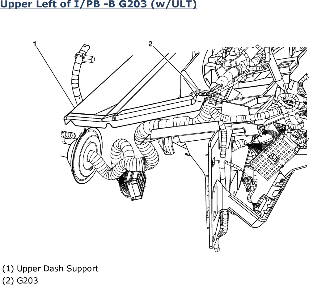

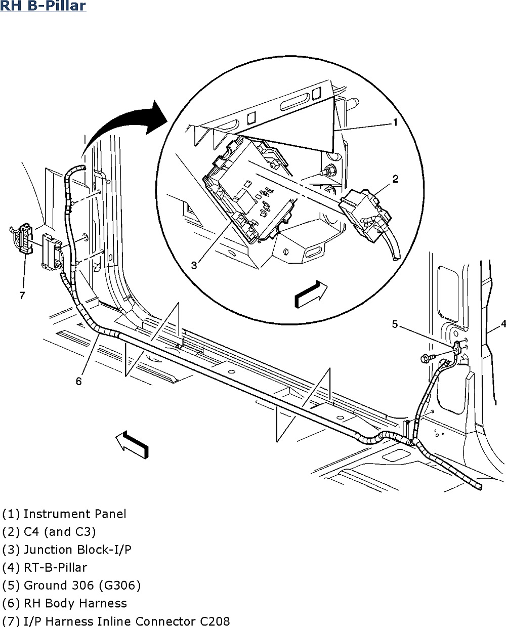

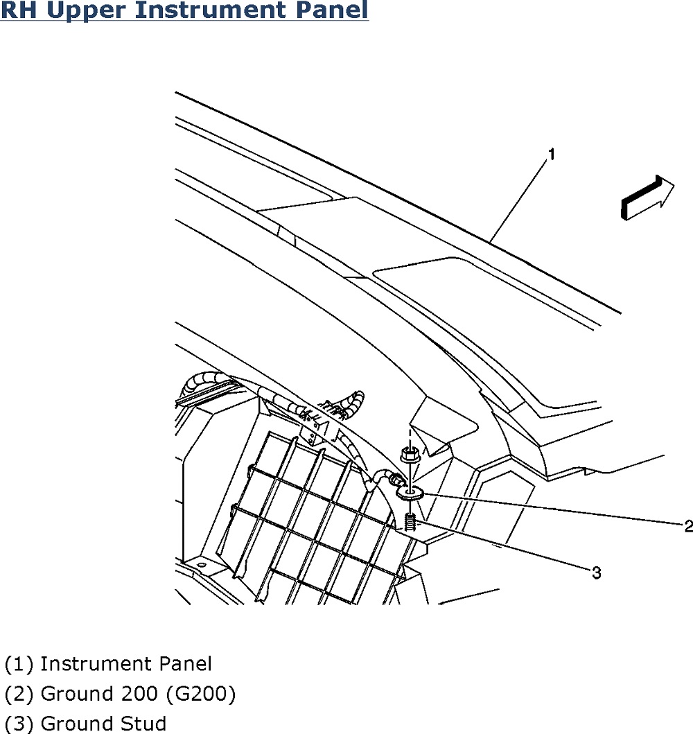

Anyone still know where the grounds are? I would like to check and clean them and the airbag light is on if that helps any.

One ground is on the drivers head facing the windshield.
Two grounds on the driver side block one behind the motor mount and one in front of the mount.
One ground on the passenger side block by the starter.
One ground on the front frame rail where the bumper hooks up. Driver side just in front of the radiator
There maybe more but those are the ones I know of, good luck

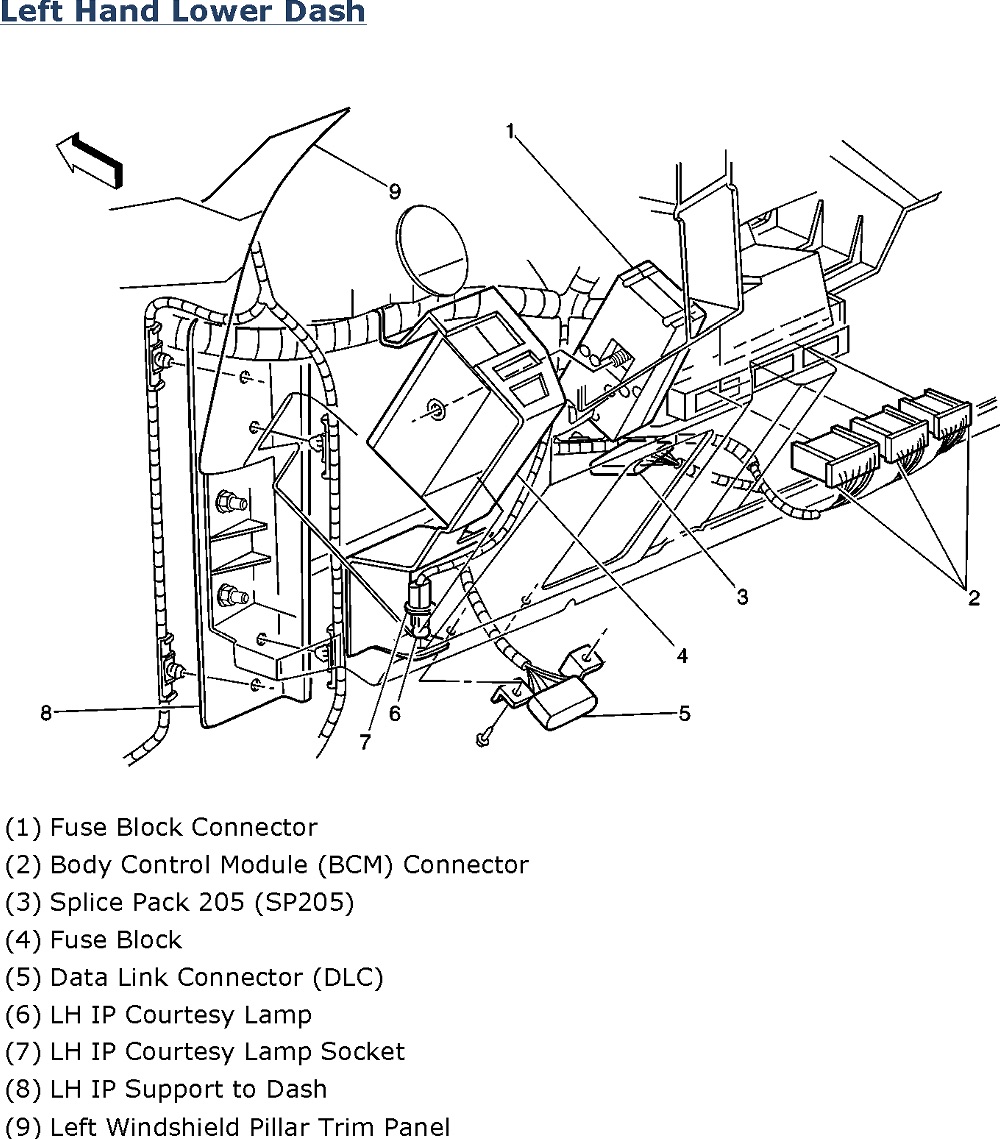

So I had the cluster swapped yet again with a well known good cluster and same issue. I was talking to the mechanic that recently worked on it and he suggested removing it again and checking the pins in the plug to see if they are loose. I now know it is not the cluster itself but another issue. Does any of this sound like a possible BCM issue? As stated, with this new cluster, I can tap on the top of it and it comes back to life which leads me to believe it is something near there. There is also some strange wires behind it which I don't know where they go.

pictures of these wires? are they tapped into the cluster harness?

I will snap someone when I get it pulled later this week. If I remember right, they appear to be running behind the deck for the stereo all the way to kick panel on the driver side.
