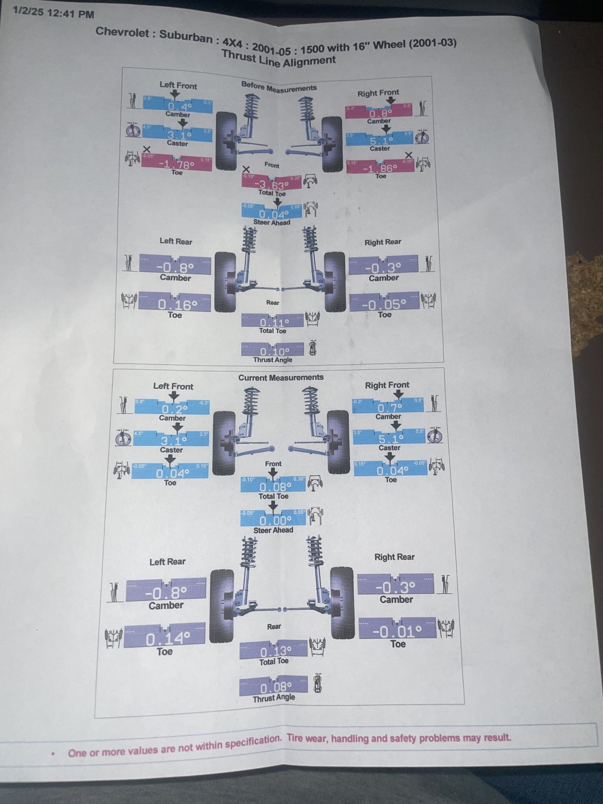

Just this week I finished installing all new front suspension and steering components. Took her in for an alignment, and the steering wheel isn’t centered at all, kind of wants to go all over and also there is STILL slop in the steering wheel.
turning the steering wheel and looking under the hood at where the steering shaft and steering box meets up, you can clearly see all the slop is from the input shaft of the steering box. So I’m thinking about replacing it now. I already tried adjusting it a little bit, made no difference at all. I have posted the link to the video of the gear box below and attached a picture of the post alignment specs.

I think I’ve done mine about half a turn? Definitely going to crank it a bit more and see how it does, of course making sure it still return to center. Can’t tell if it’s binding just by sitting there, because when I turn the wheel while still after about half a steering wheel turn it get super tight like there’s no power steering. Think pump might be getting weak, it’s fine once the engine has some rpm.
