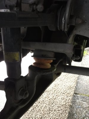

I've never seen ones from Belltech. I installed new OEM ones to replace mine which were really shot and it seemed my front raised back up 1/2" or so which I didn't want. Those look shorter than the stockers?
Yeah they are shorter. I had my OEM ones drilled out and then came across a post that a guy used these. They are perfect. Just barely touch at rest. You just knife the back to peel the mount out then pop them in. They are the same diameter and everything

Damn. Wish I hadn't just spent money for OEM's! Might just buy these anyway.

Well I decided to cut 1/2" from my OEM front bumpstops in order to save the $30 those Belltech ones would cost me. Then I installed the KYB steering stabilizer I bought. Steering seems more solid now. I recommend this to anyone with big wheels or tires. Front suspension seems a tiny bit better now too. IMG_5002.JPG IMG_5006.JPG
