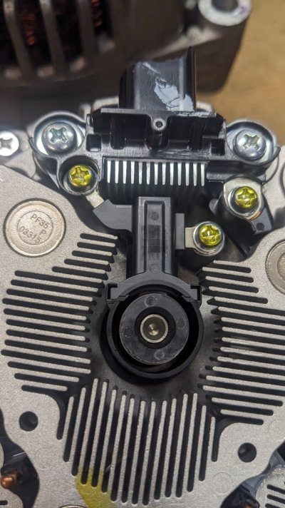

my part number 13534128 regulator looks like this, super eazy to swap. just a few screws and no solder. but I can't find anything that swaps.. can't even find a replacement one. PXL_20230728_023101604.jpg

Gotta remember that the alternators off these newer rigs are 6-phase. Probably not gonna find many replacement parts.
I honestly don't fully understand the difference but these things work well very well. if you order a amp clamp I'll be interested to see what you can load yours too.
the ebay seller got back to me finally and said he's going to locate me a good one and send it out. he didn't say if it was a regulator or a whole alt. I asked but go nothing. I'll see if anything shows up haha. but I clocked it so it's facing upright and the plug doesn't look like it's going fall out and if it does it defaults to 13.7 without the plug anyways haha.
