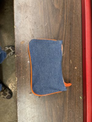

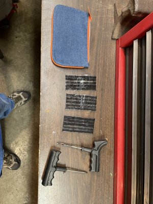

Speaking to the tool kit comments. I decided that my plug kit should be in my truck not in the drawer in my shop. Scored this little bag at the local Goodwill.
View attachment 273078 View attachment 273079 7A538F6A-71AF-4C99-B686-864893368109.jpeg FCFE984D-1C1E-4D06-9644-3A4BAE4A53E8.jpeg
