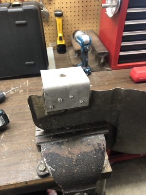

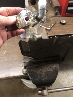

I just replaced the one short one on the driver side. Yes, thats the heat shield.
I got my tubing kit yesterday, I take it you did too? I plan on replacing them as a maintenance item so I’m in no hurry but don’t want to stash the parts away or I might forget. :smoke2:
