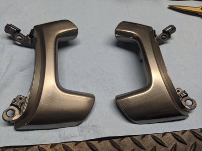

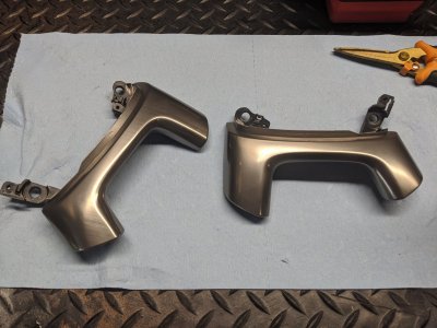

If the two steering wheel accents silver on any of those trucks intact and not worn out or scratched as well as the window switch plates. Let me know what you get. Mine are worn out on the wheel and both from window switch plates.
I found a set yesterday and pulled them. I would rate them as a B+ in used parts. They cleaned up nice, they do have some light scratches.
Shoot me a PM/DM if you still want them. If not no harm, they're clean enough where I'd keep them and install them in my truck

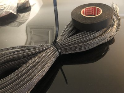

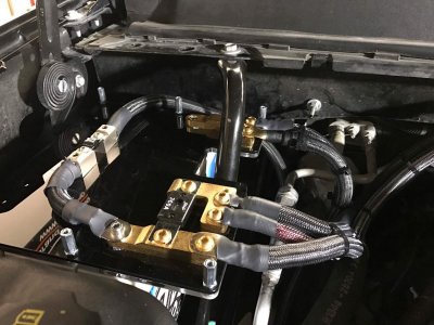

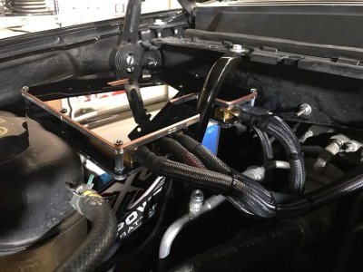

Also finally replacing all the cracked broken wire loom under the hood via Tesa tape and matching braided loom to match the Big 3 cables and custom battery top.
