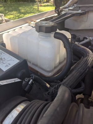

Air bubbles in the coolant reservoir

ya it's kind of bewildering that it's now holding coolant, runs perfectly (aside from the startup clickety that's not nearly as bad as it was or doesn't do it at all) yet still has bubbles in the tank and it passes a pressure test and block test. The 05 is pretty nice I picked up some front pillars with the bose tweeters in them today and will be adding a sound system to it and putting some power fold and blinker mirrors on, I had the cluster refreshed already and added a trans temp to it. ordered the hoses, T's, coolant tank, wheel bearings, some steering parts and washer pump for it, gonna have to pull the reigns in on spending money on it for the moment but the parts are all shipped so have work to do on it this coming week

Well it's been 23 days since adding the blue devil, coolant level hasn't budged and it has been driven every day, the tickety-tick noise is gone and drives and sounds normal, the coolant did turn a funky darkish color but it was already mostly water. Appears to have fixed the problem for now. still see air bubbles though :shrug:

Quit staring into the bubbles....I’m concerned for your mental health.

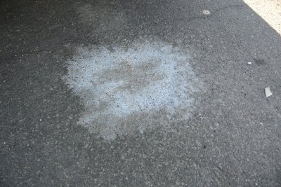

I put in 2 bottles, I poured as much as I could in the radiator and then I pushed the upper hose down to empty some coolant out and managed to get 95% of 2 bottles in it. what spilled on the ground looks like this now after the sun hit it

Bottle said don't pour anything in the overflow, and I didn't want to spill anything by cracking the upper hose--at the time. Guess I should've. This stupid van!

The blue devil stuff "might" be working, the bottom of the filler cap is now clean and dry before it had some small amounts of milky like residue and the clickity-clickity noise at start up is going away and coolant level hasn't gone down in about a week, it still has air bubbles in the reservoir though but preliminary results are promising.
do a exhaust gas test on it (they have test kits that can detect exhaust gases)
if it's negative then it can just be some old air that was not purged from the system. or was trapped in a high spot and got moved out randomly

it does it instantly on a cold startup or hot startup, and when it gets up to temp it stays where it should and never wavers. It's not boiling Brent there air bubbles, I have done the block test 3 times at various intervals and I have done a pressure test 3 times, first pressure test it was the water pump seeping, replaced the water pump, then the crossover pipe was leaking replaced that, system holds pressure now and passes a block test. yet still has air bubbles all the time day/night, hot/cold, sat & sun too.

so the wifes 04 has a mysterious coolant loss, no leaks and passes a pressure test, also passes the test for gasses in the coolant, I see bubbles in the reservoir??, i'm stumped. looses about a quart every 2-weeks. water pump was replaced and replaced the crossover pipe because both were leaking. oil looks fine and nothing under the fill cap.

air bubbles on a cold start can still be there from the previous shut down
have you inspected the spark plugs for coolant sludge?
should look something like this if some is getting in the cylinder and the cylinder maybe much much cleaner then the others
already know there WAS coolant getting in the engine, but not anymore and the bubbles are still present
