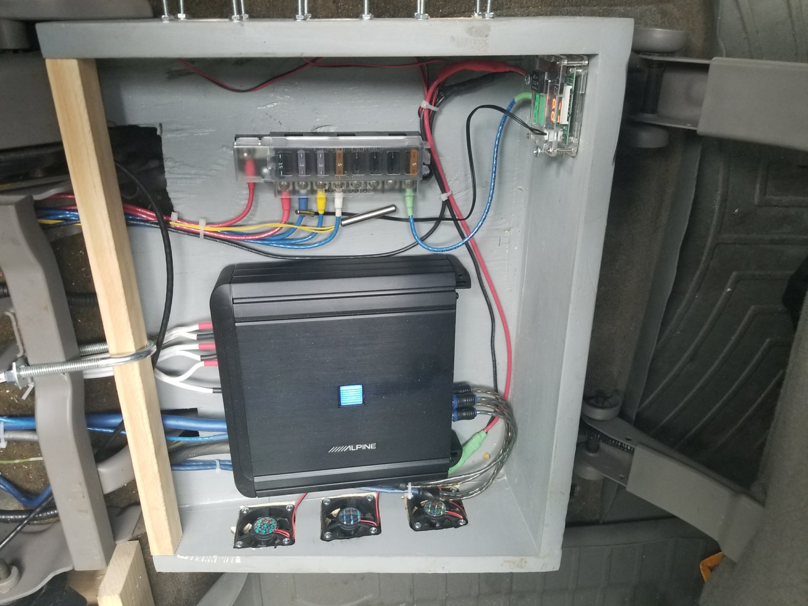

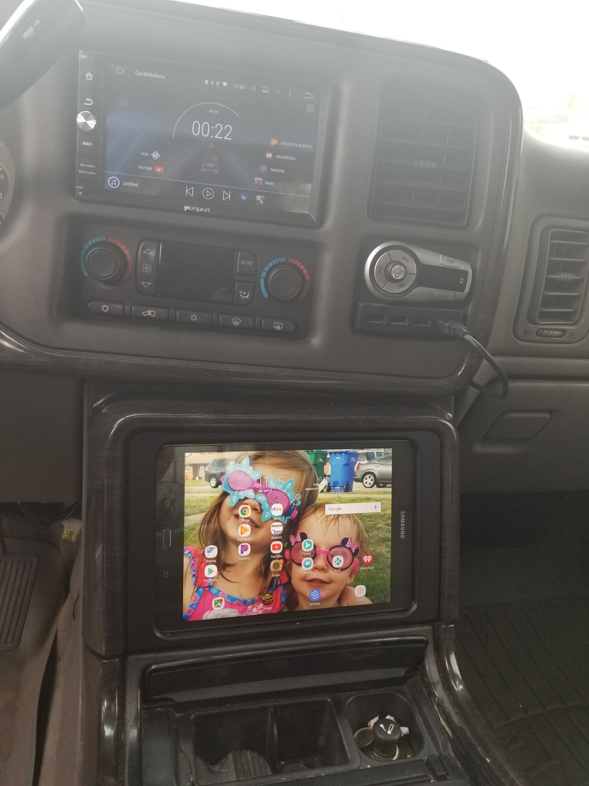

nothing crazy so far .IV been buzy. before i had a raspberry pie in there for streaming from anything from it was on and off. With the tablet, i picked the tablet out (Galaxy Tab A) and found these guys

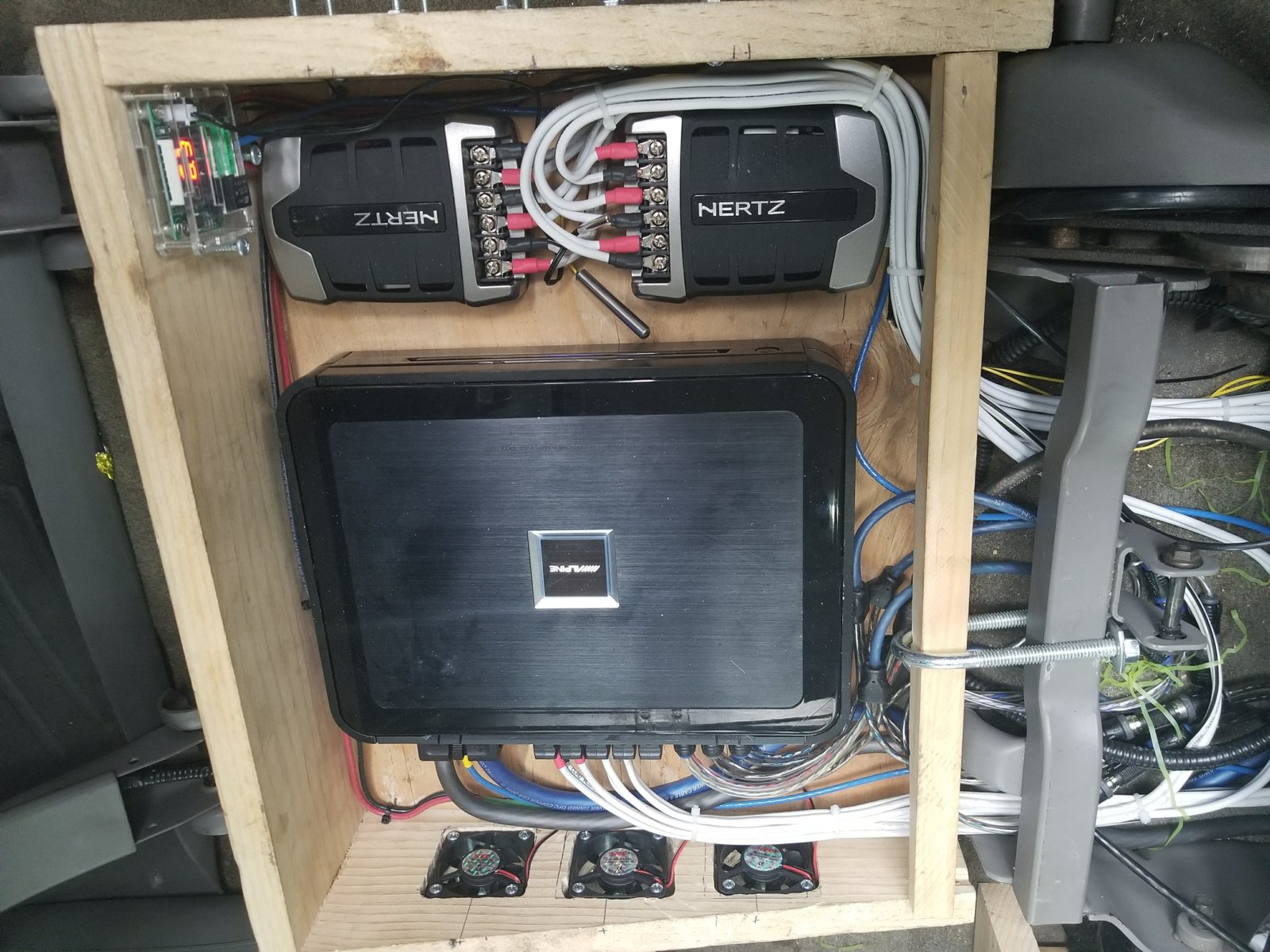

http://www.fifieldfabrications.com/ Really nice people. i told them my vision and they said since they dont have a kit for it my panel or tablet, they said send them the tablet and that panel i want it in. They sent it back with it fitted. it came with a hole for the charging port. so what i did was ,i put the tablet in the lock position, put the charger in and glued the plug into the hole so it sits in there nicely. I still have left is, routing the top then Plexiglas on top, maybe some leds, carpet the outside to match the floor, fan grills so nothgin gets jammed in there. still get a sub in the back. still have to show you guys the 2 temp gauges (other end of the yellow longer temp probe) looks really cool actually. definitely keep you guys updated as i go. like i said have any questions, willing to spread the wealth. im not doing competition stuff, just hobby and messing around. Question for you guys, my fans i have are one pushing and the other pulling. Do you think since it really wont cool down unless its cooler in the cabin, would the fans be more effective with both side exhausting the hot air out? instead of push pull? i have the fans set to kick on at 75 degrees.
