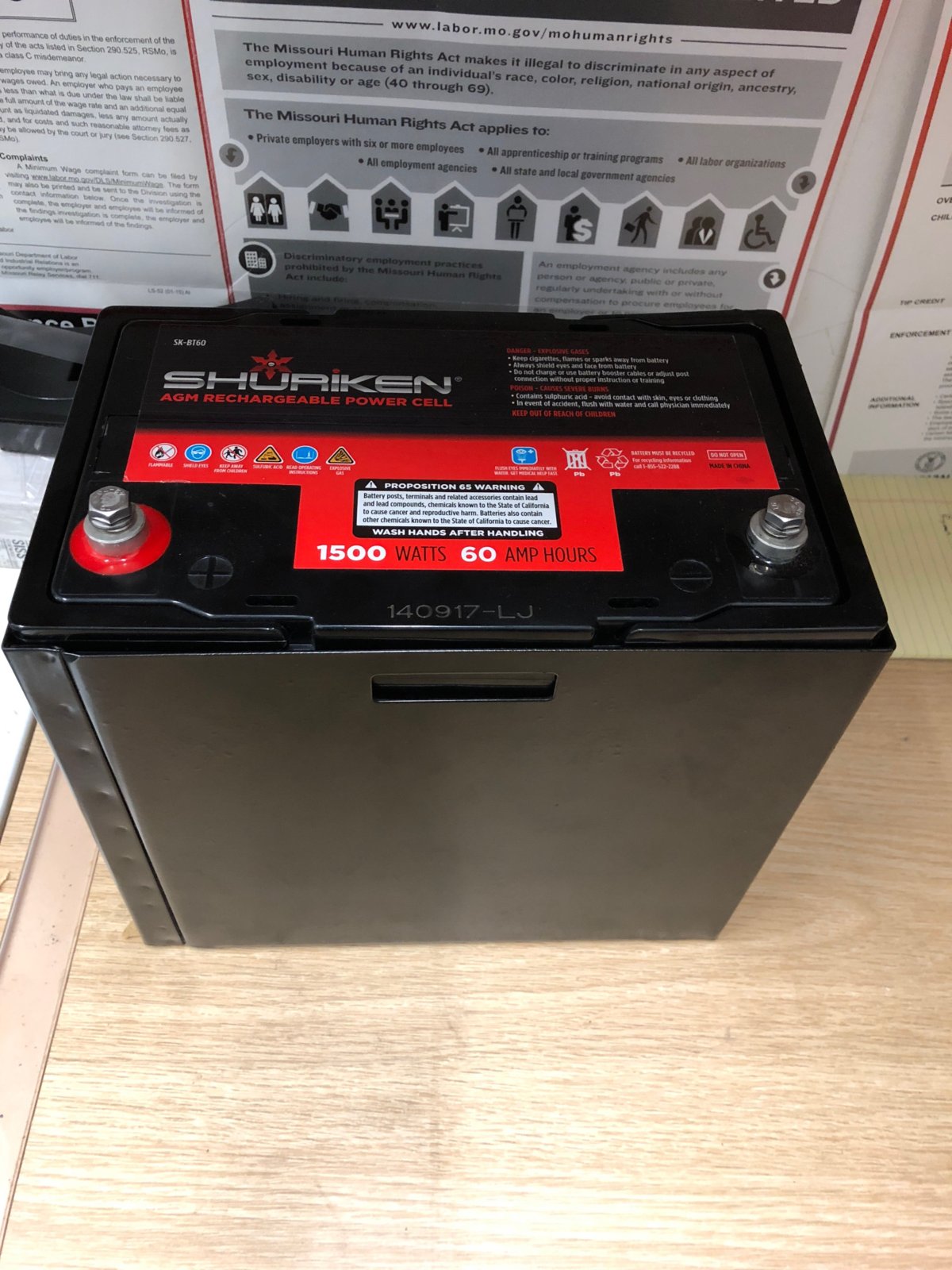

I used to have 3 Alpine PDX amps running a total of 2600 watts, I used 1/0 gauge to the 2nd battery which was a Shuriken SK-BT60. It ran the system fine. 1 ** alternator was used for both main battery and audio system battery. Now I use 2 amps running 1200 watts with same battery, perhaps over kill on power supply, but will have no issues with dimming lights, or under powering audio system. What's nice, is having that spare battery bay under hood, (front left side) of engine compartment for adding the second battery.
