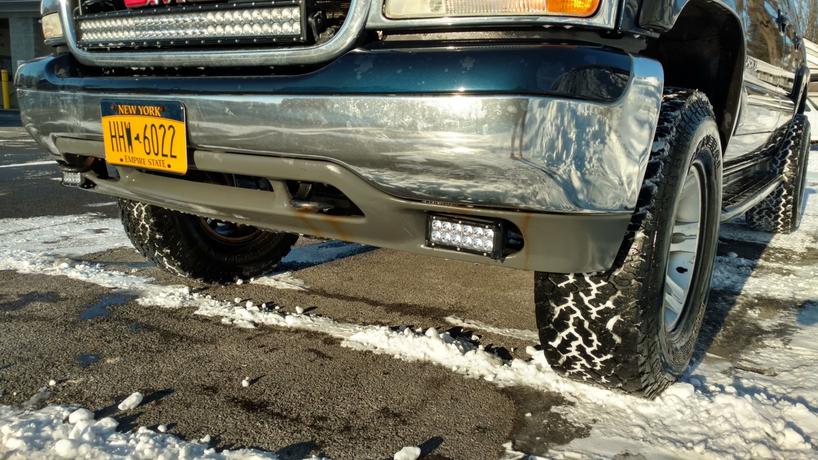

Mine may not be the same brand, but I have the exact same - 7" x 36w Cree's.

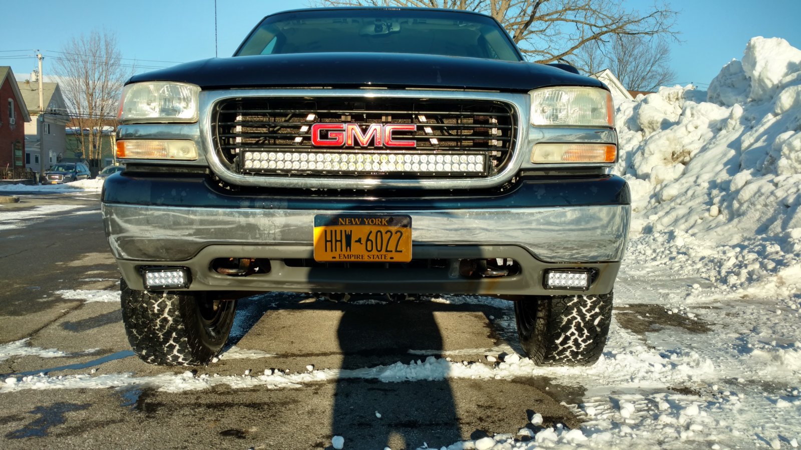

All I needed to make mine fit was to fab up a piece of 1/8" x 1 1/2" x 4" steel, and drill 5/16" holes 2" apart. Bolted the steel to the holes in the top of the opening (steel toward the engine), and then bolted the lights to the steel. Mine didn't have plugs on the end, so I simply used wire nuts to attach the stripped factory wires to the lights, then wrapped them in heat-shrinkable electrical tape. No issues in almost a year.

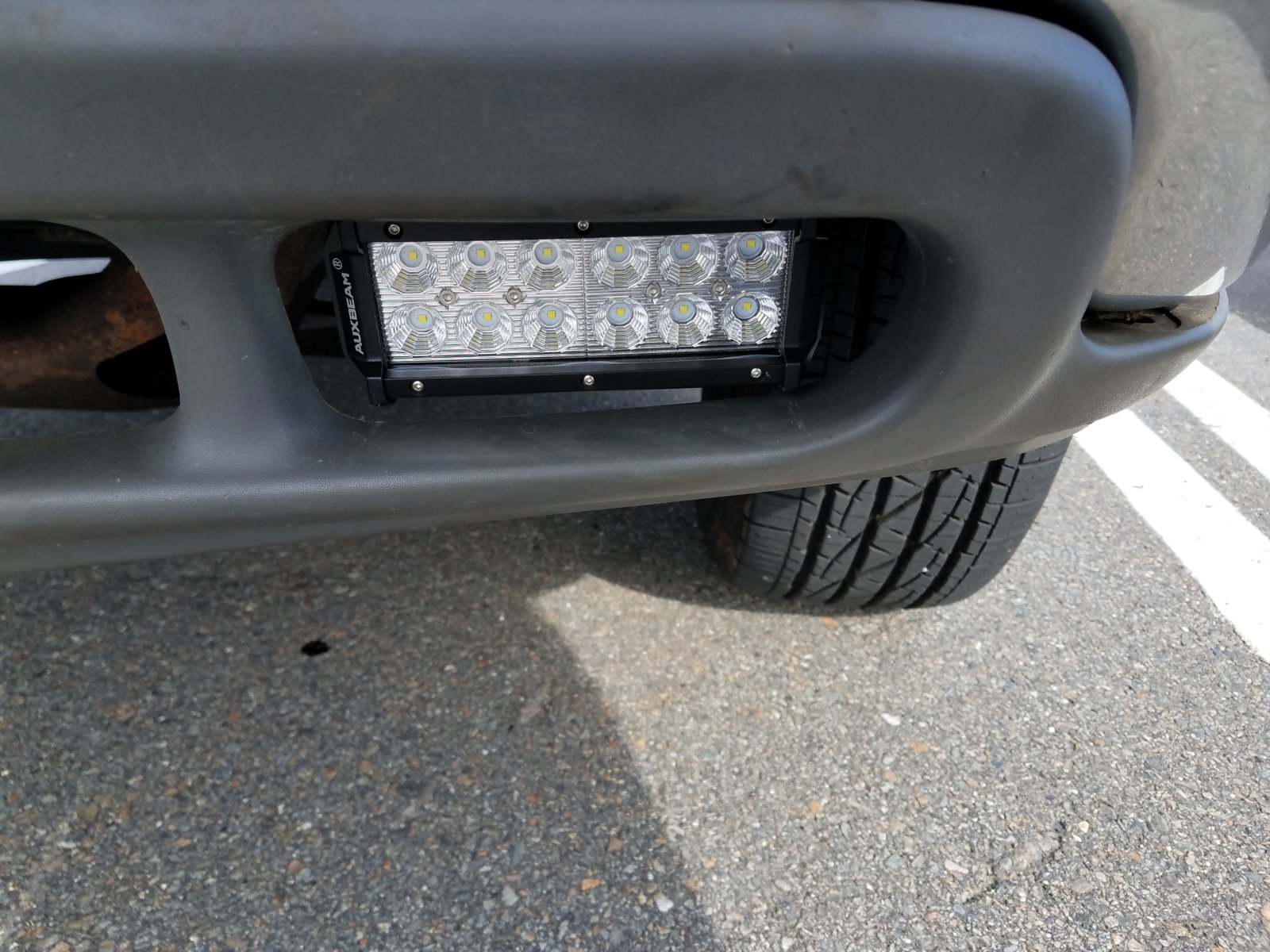

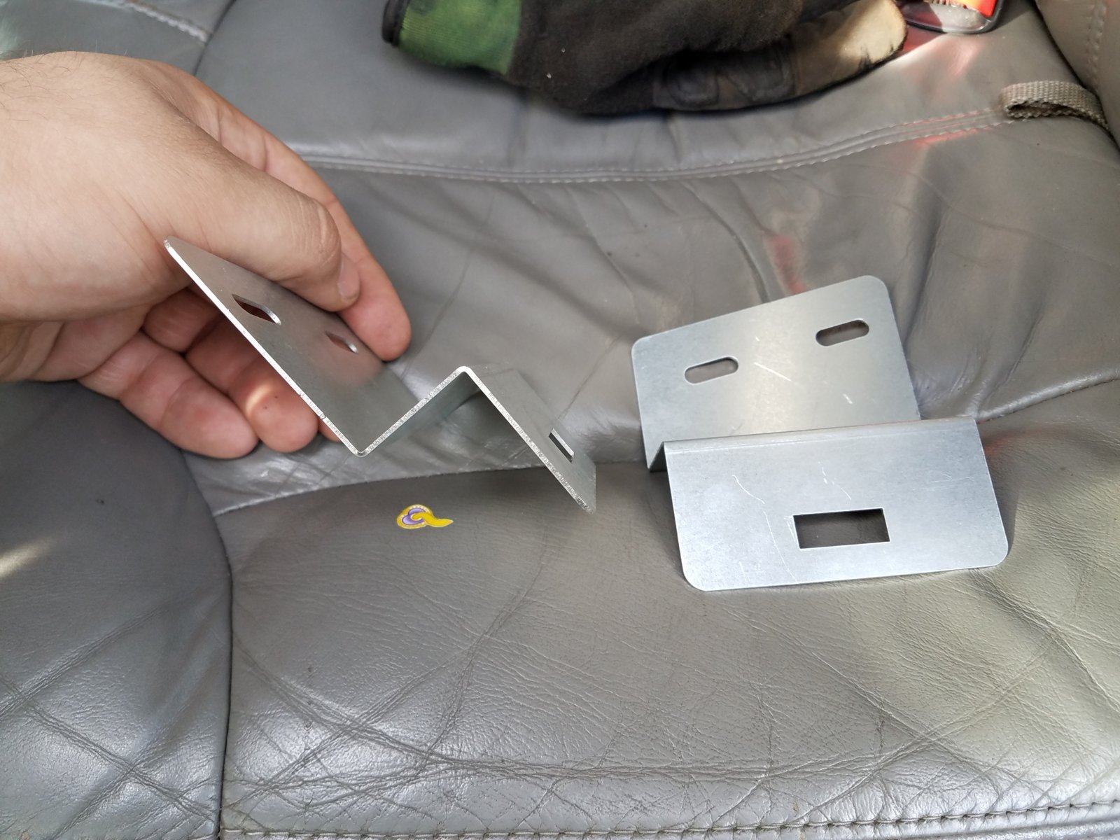

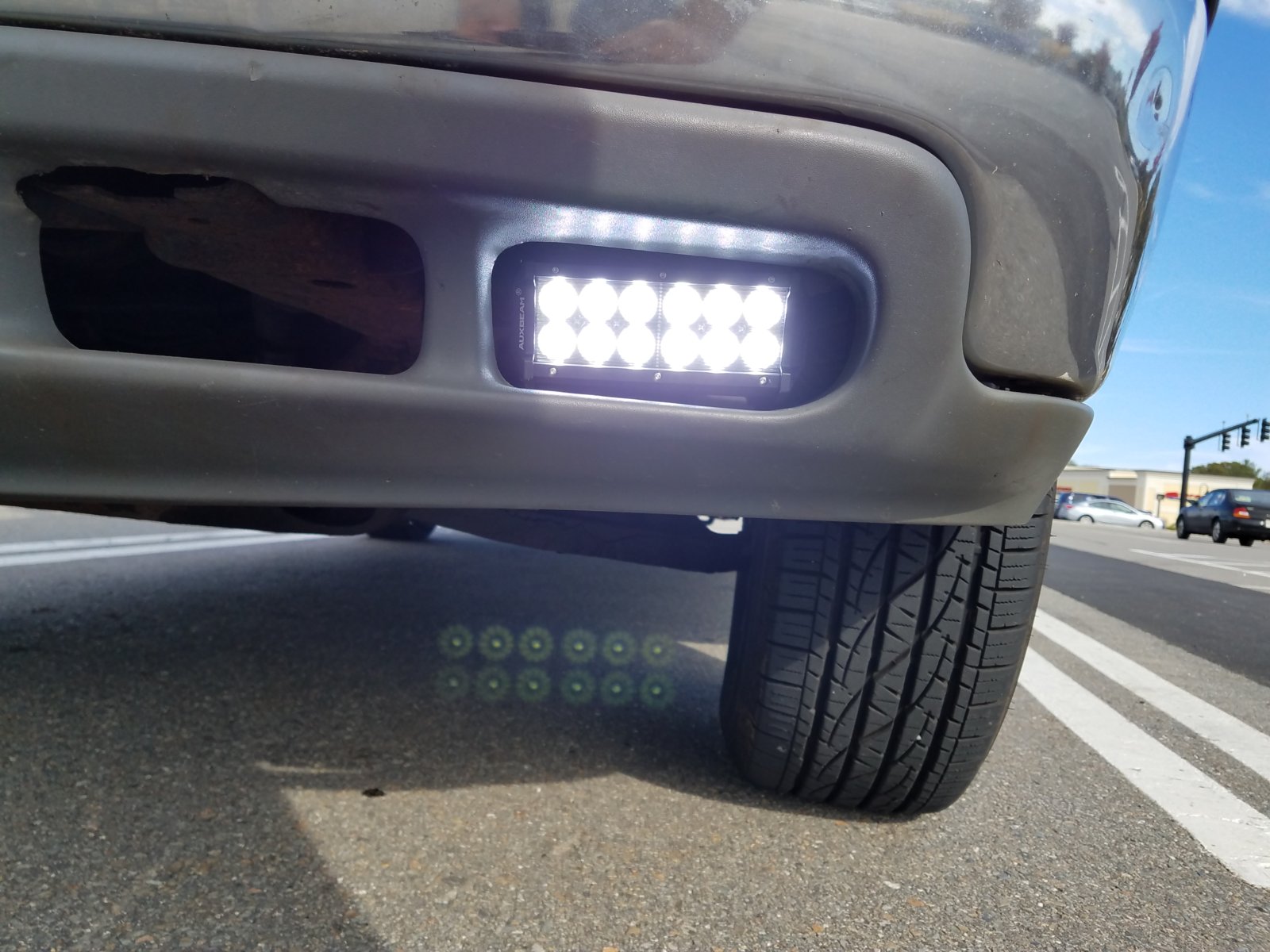

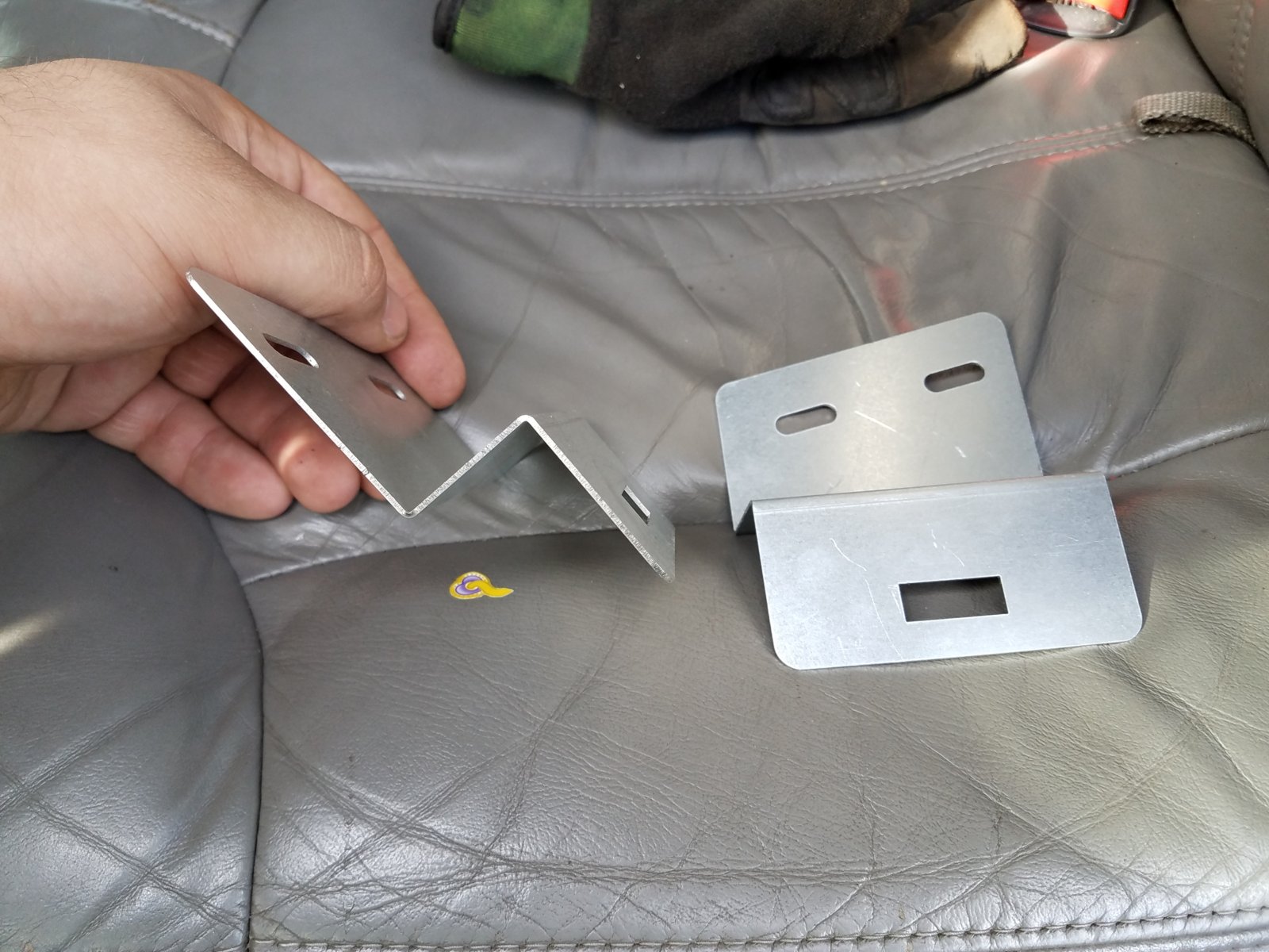

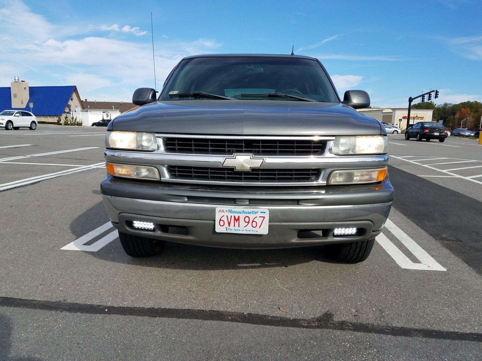

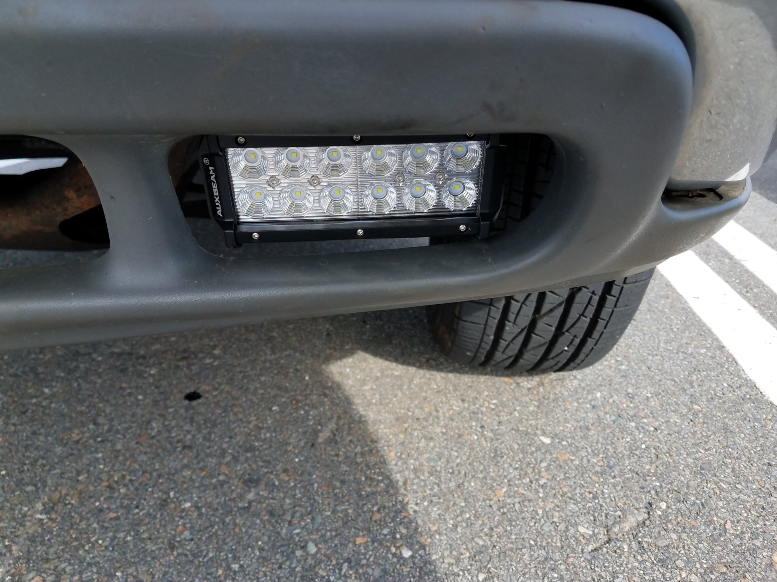

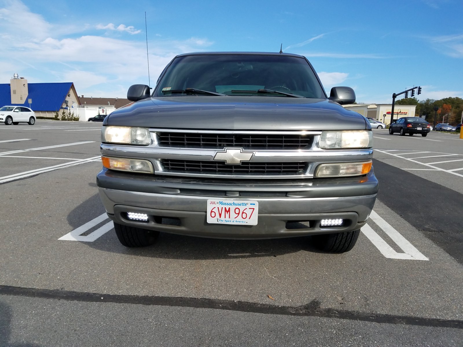

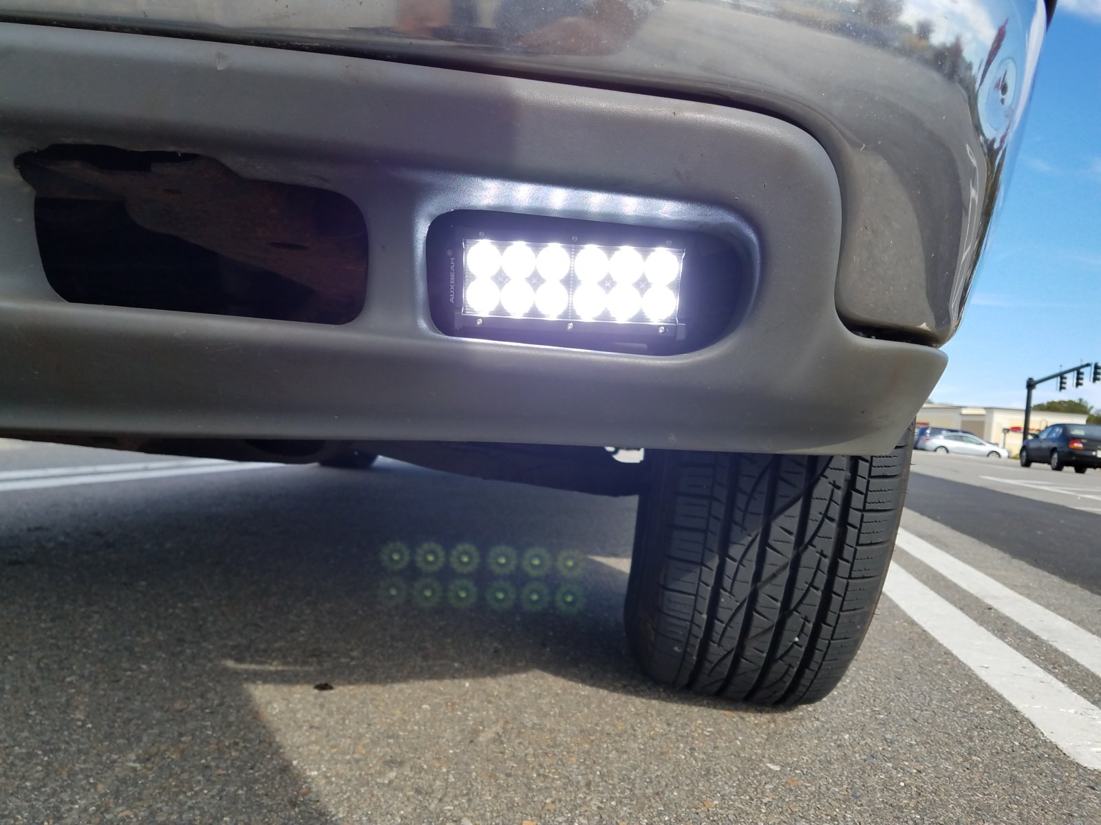

Alright guys. I took a look at mmeachem's links and had a set of brackets made up at my work. I am a mechanical engineer at a lighting manufacturing factory so I have the advantage of having sheet metal turret and laser machines and press brakes at work.
I managed to get the guy that runs the mahine shop to run me some brackets out of 0.046" Galv. Steel after drawing up a quick print from measuring the stock plastic bracket.
The brackets came out slightly short because I didn't account for the drop of the ears on the side so I made up for that with a bunch of 5/16" washers lol.
I used these lights that mmeachem recommended:
Auxbeam LED Light Bar 7 Inch 36W CREE Driving Lights Flood led off road lights waterproof for Jeep Off-road SUV Truck Car ATVs Boats (2 PCS)
https://www.amazon.com/dp/B00T8UY53Q/ref=cm_sw_r_cp_api_SyjVzbKC6PCNW
I'll be sure to get you guys a night shot some time soon! Going to do a 4hi mod as well.

One thing I forgot to mention was that he ran me two sets of plates just in case, so I still have another set that someone could use if they want it.
It holds the light great and is solid, doesn't move. Like I said I did have to use a decent amount of washers as spacers for it to get to the height I wanted it at.
