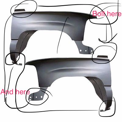

I would start top rear and bottom rear of fender and see how that goes. Im no body guy though. On my older cars/trucks just loosening and a shim or pushing here and there lined it up but I do remember those chinese fenders/body panels never lined up so well..
