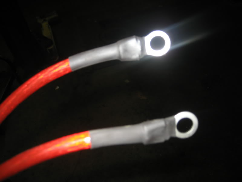

    this is on creedcop's 95 tahoe. the initial problem we were having was the lights were diming and the old battery died a couple of times. we decided to plan for the future and pull out all the stops and make it to where there will never be a battery issue.
    PARTS LIST
    1. got the alternator rebuilt at a local shop to handle more power(will get specs later)
    2. dual optima yellow top batteries
    3. 20+ feet of 4 guage wiring from the local stereo shop for all new wires
    4. universal frame mount battery tray bolted to the core support and the inside of fender
    5. misc amount of ring terminals, side/top post terminals, heat shrink, and corigated tubing
    both batteries were given their own grounds. the hot wire to the fuse box was replaced and put in factory location with factory tubing. the battery cables connecting the two batteries were ran along the top of the fan shroud. lastly we replaced the alt to battery wire. here are some pics.
    ground wires
    battery cables
    alt wire
    fuse box wire
    driver's side battery
