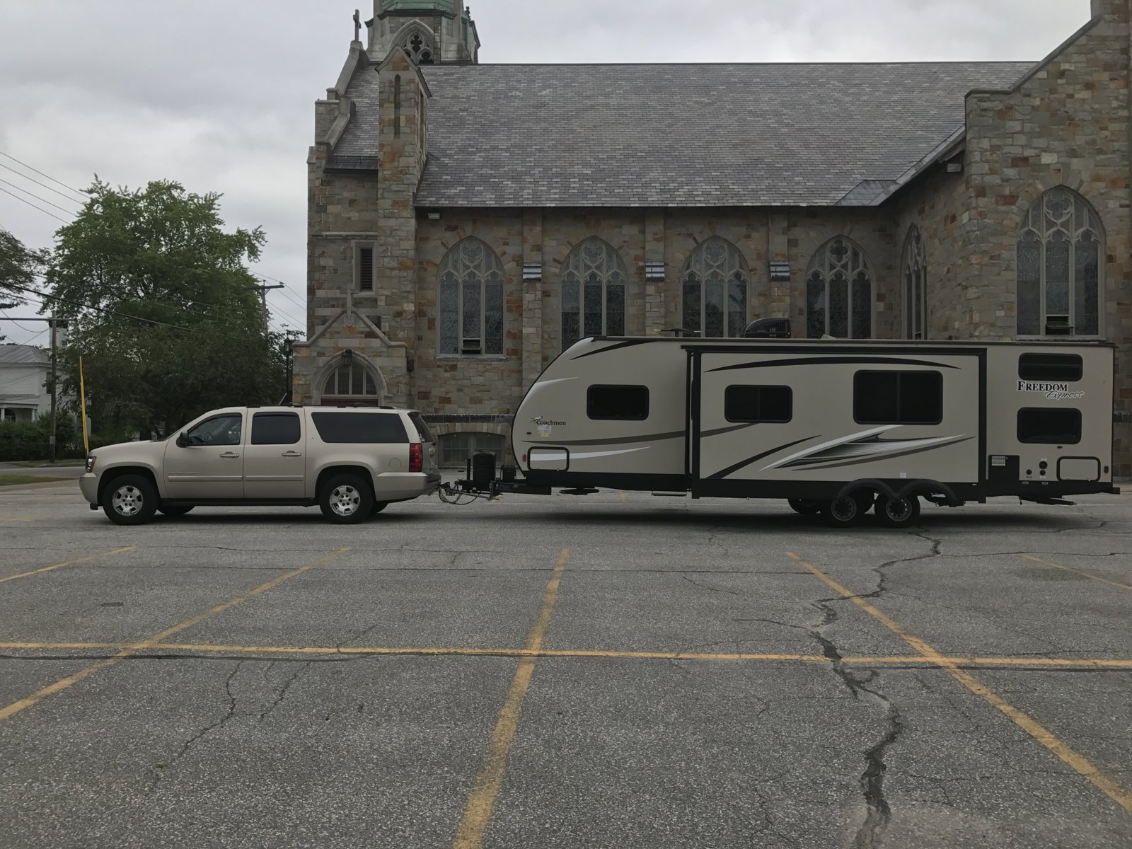

I own a 2007 suburban with 167k miles on the clock. Frames got surface rust in the rear from New England winters but its not rot. Over all the trucks in pretty good shape. Last year we bought a Coachmen Freedom Express 29SE (GVWR 7600). I never intended to tow with this truck but it does ok. The picture shows the truck with the weight distribution hitch and it rides pretty level. I have Z71 shocks and struts. with less than 8k miles on them.
In the next year or two ill probably be looking to upgrade to either a 2015+ Denali 2500 or a Yukon Denali XL. I'm wondering if any of you pull travel trailers around 30 feet long that weigh in loaded at about 7500-8000 lbs With the the 2015+ Yukon XL or Suburban. I wont be pulling this thing all the time which makes me lean towards the SUV over 3/4 ton for the ride. Bad back and knees from a work accident. Plus I have 3 kids 5,8, and 13.

yeesh - that's gonna be a chore. what part of the country are you in? Rockies? Appalachia? Coast? It really depends on where you are and how often you are gonna be pulling your camper... I pulled a car trailer with my 15 5.3 one season (8k loaded) and it was not fun. Might want to look at a duramax or superduty.
