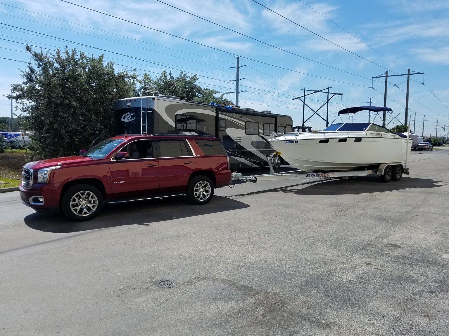

I'm towing my 255 Formula and trailer (7500#) and 650# tongue weight.... with 2016 Yukon with Max tow (has automatic leveling) with no issues. My air compressor for the leveling system runs only for a few seconds to level the rear...before it runs there is barely any noticeable sag.
With 500# on the tongue I doubt you will see any noticeable sag. I do recommend though that you make sure you have at least a 6000# ball...the ball is the weakest link in the system.
My prediction is that you will be fine...depending on how much gear you load in the back of the Tahoe and how far you are towing.

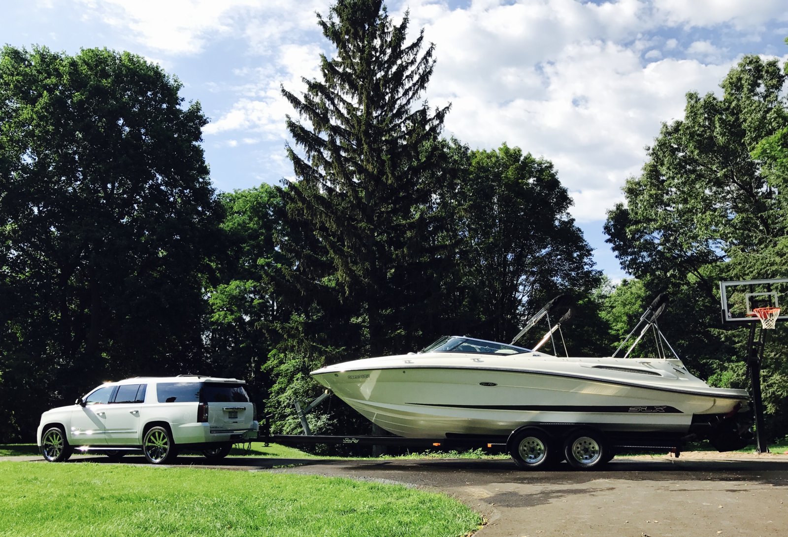

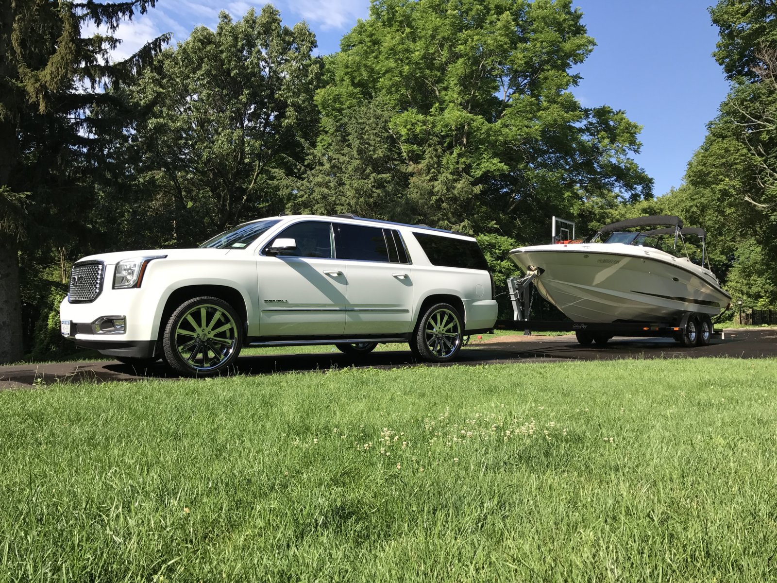

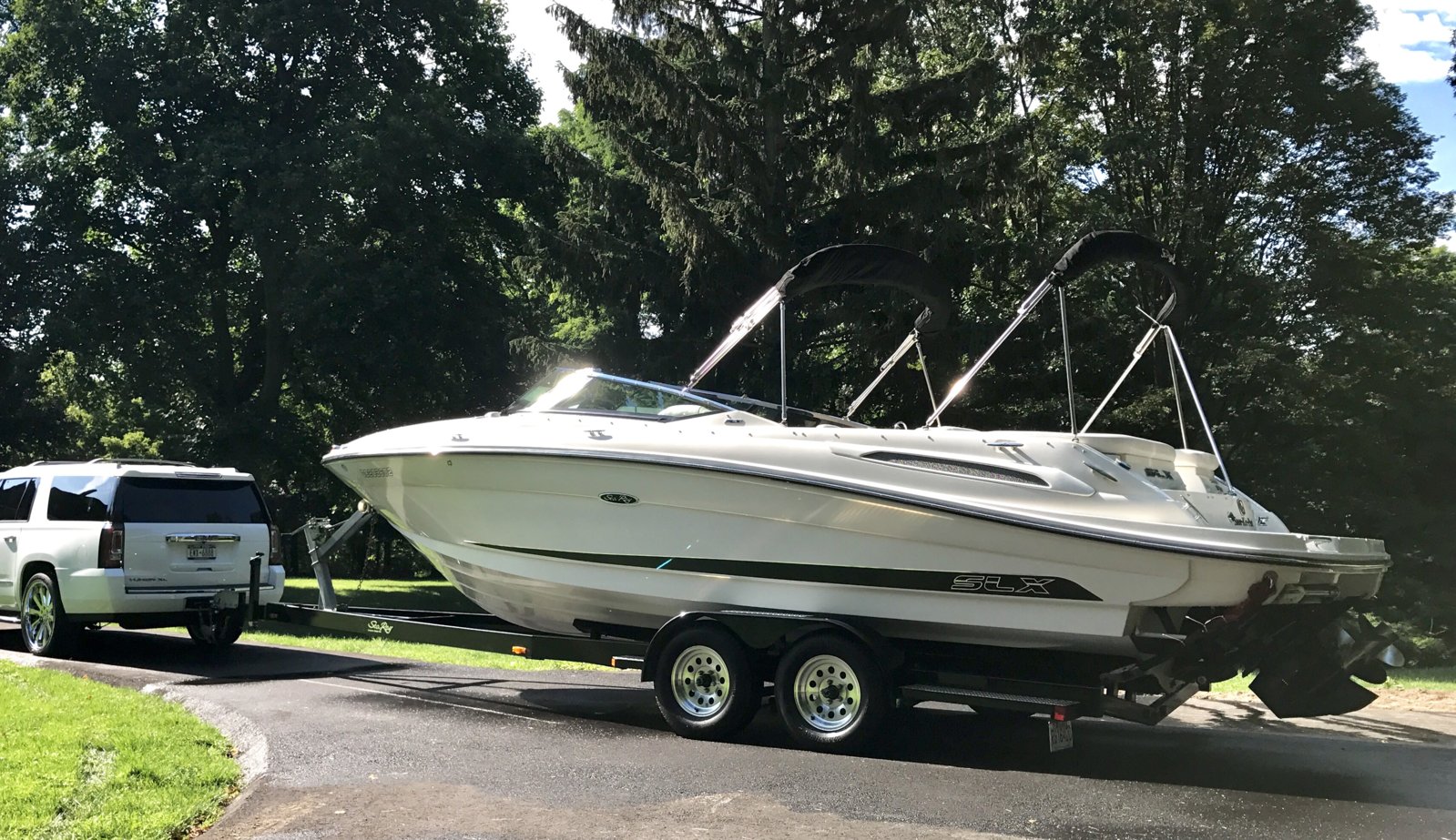

Just bought a 25' Sea Ray 250 SLX this past weekend. I had no problems whatsoever towing it 200+ miles home. Was a little worried being on 24" rims without a lot of sidewalk but it towed like a dream. That's a 5500# boat + trailer. IMG_5439.JPGIMG_5452.JPG IMG_5442.JPG
