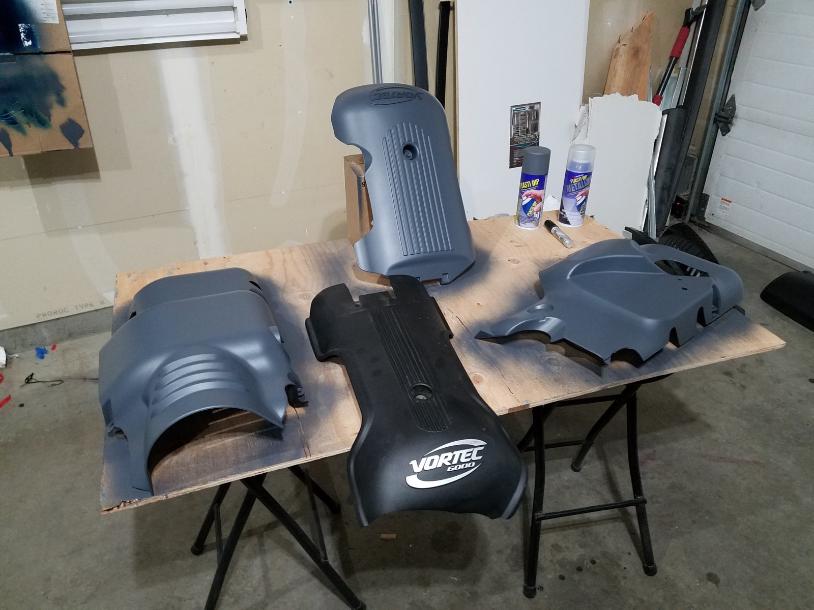

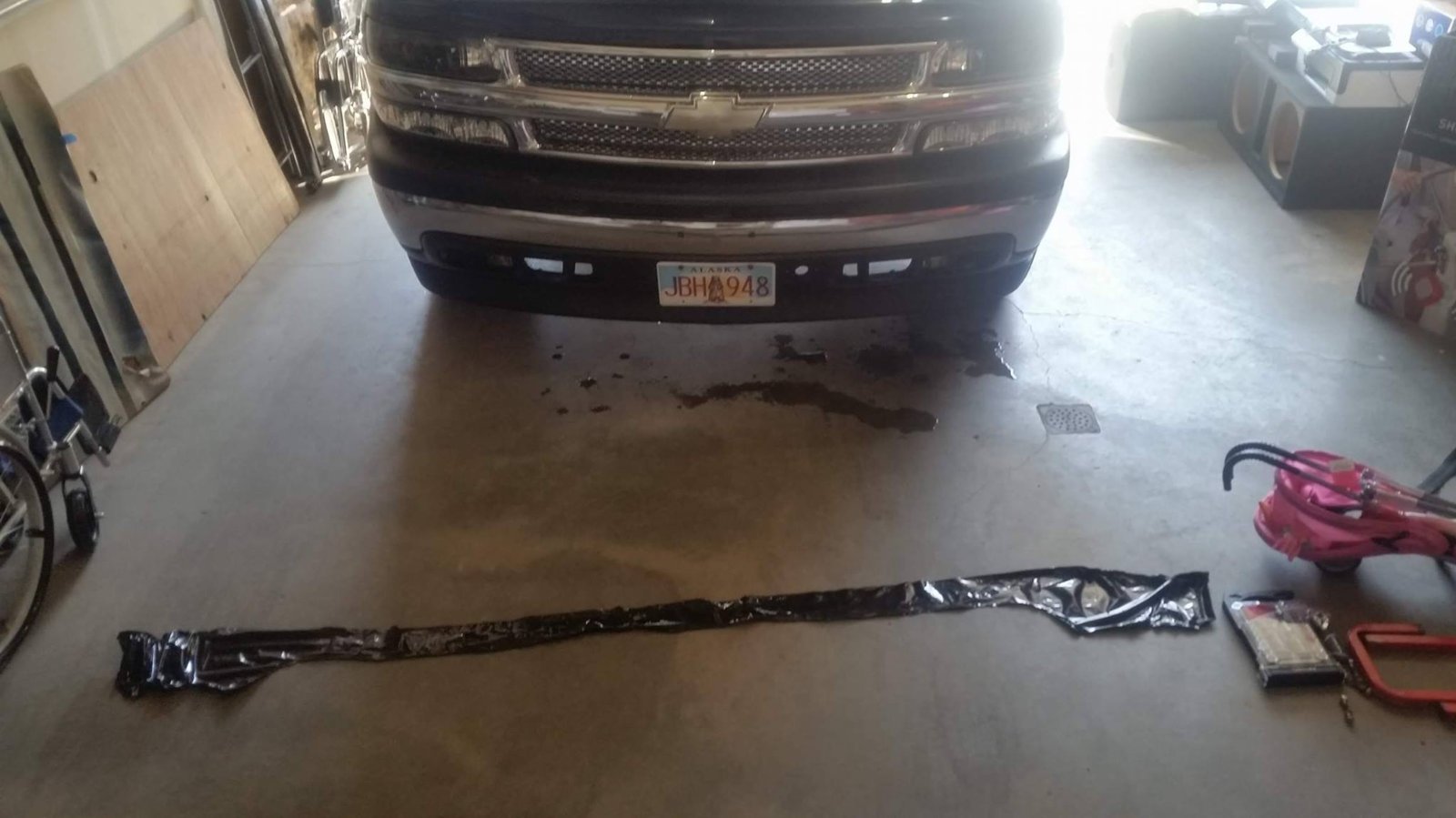

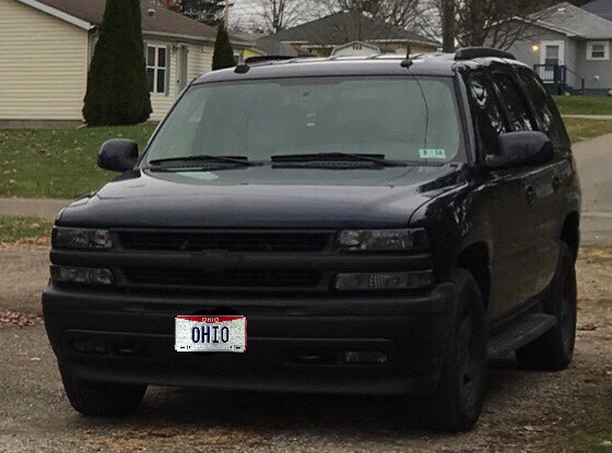

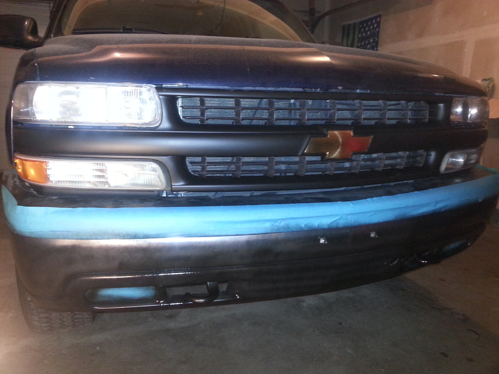

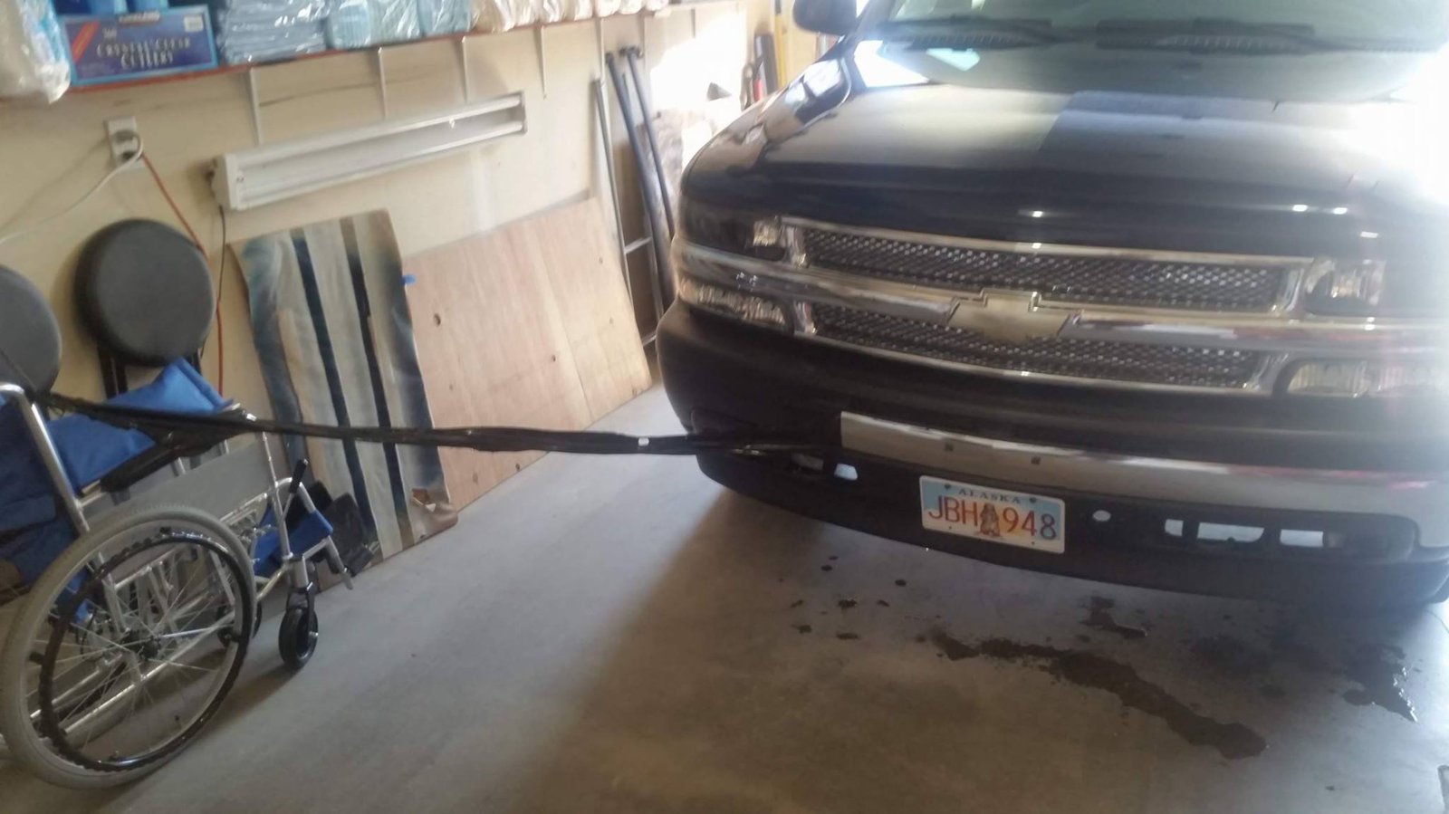

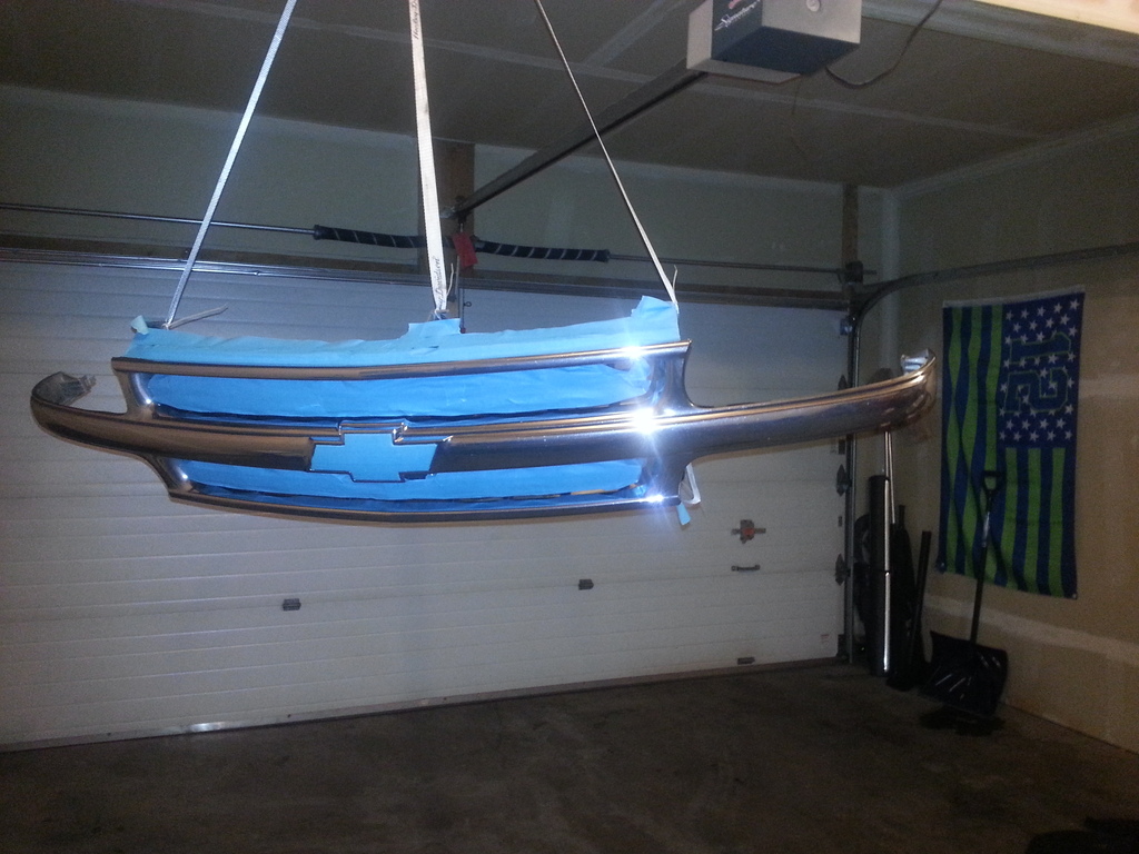

So here goes. I'll start with one of the most popular applications - plastidipping the chrome grille.
First I clay bar the surface to get rid of every spec and debris on the area I'm spraying. Next I remove the left over wax used from the clay bar with dish soap and a rag, then I rinse with a clean water only rag. Let dry then spray.
No matter what always use the recommended 6-7 coats, 30 minutes flash time (dry time) between each coat. Thats almost 1 can for the grille.

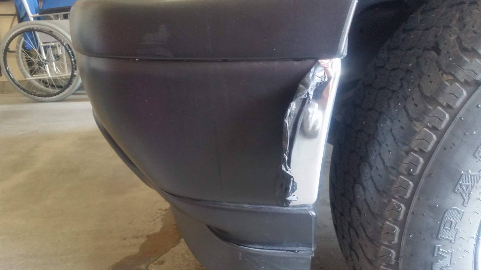

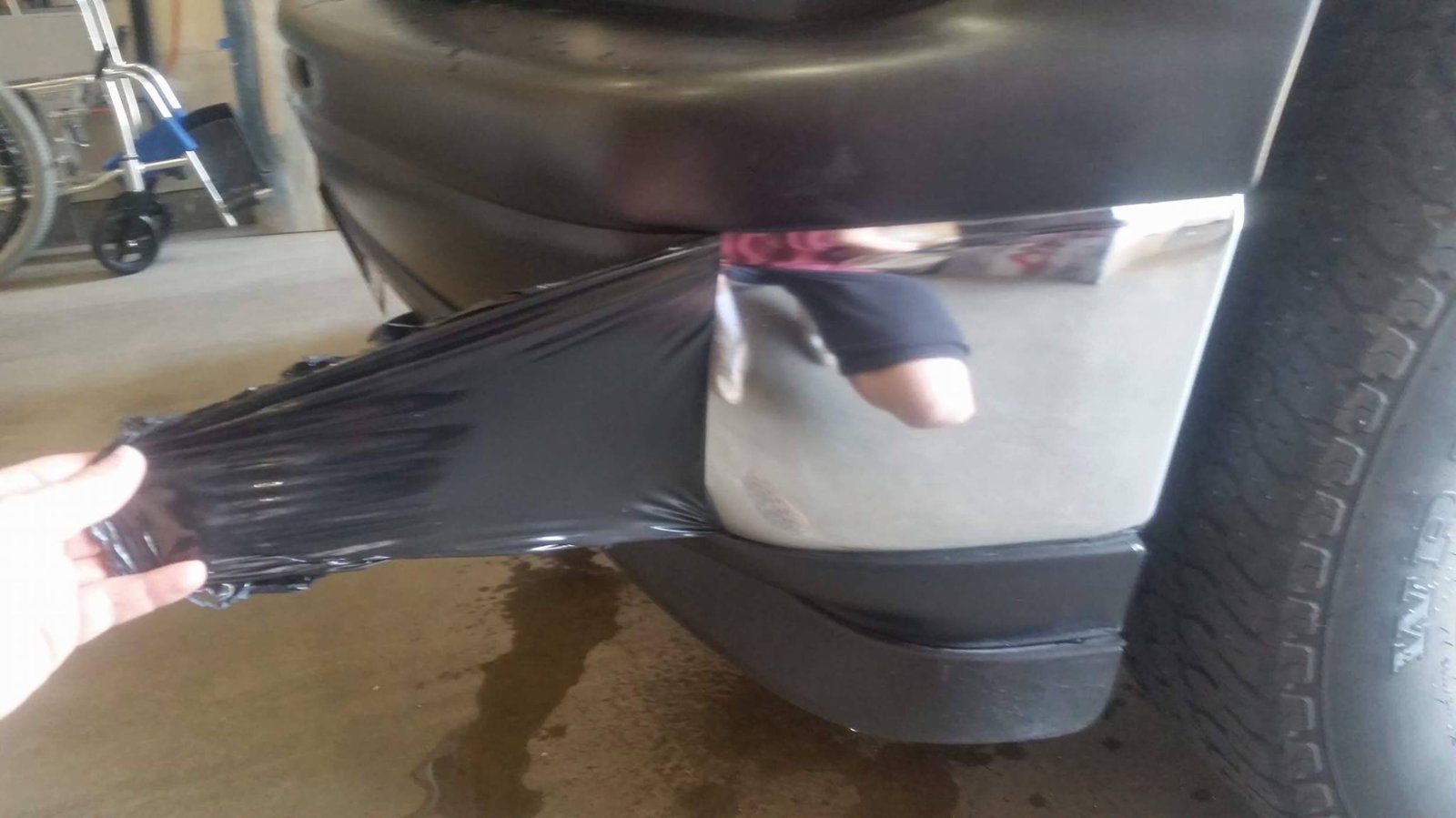

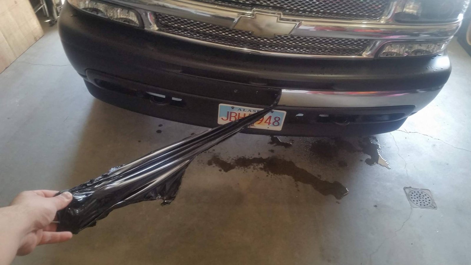

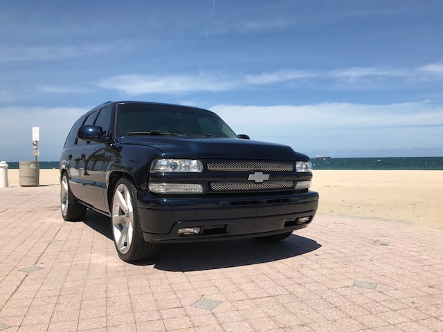

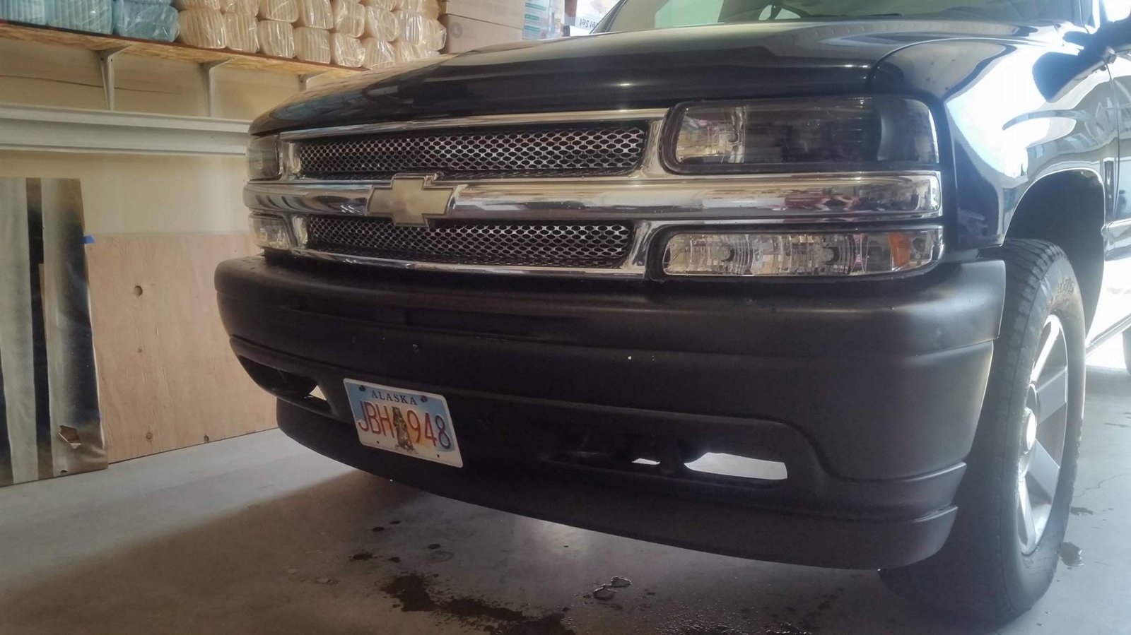

Next was the bumpers. Again 1 can each bumper
I also went over the gray lower valance to blend in with the front. I highly recommend it because the gray looks like on any color tahoe.

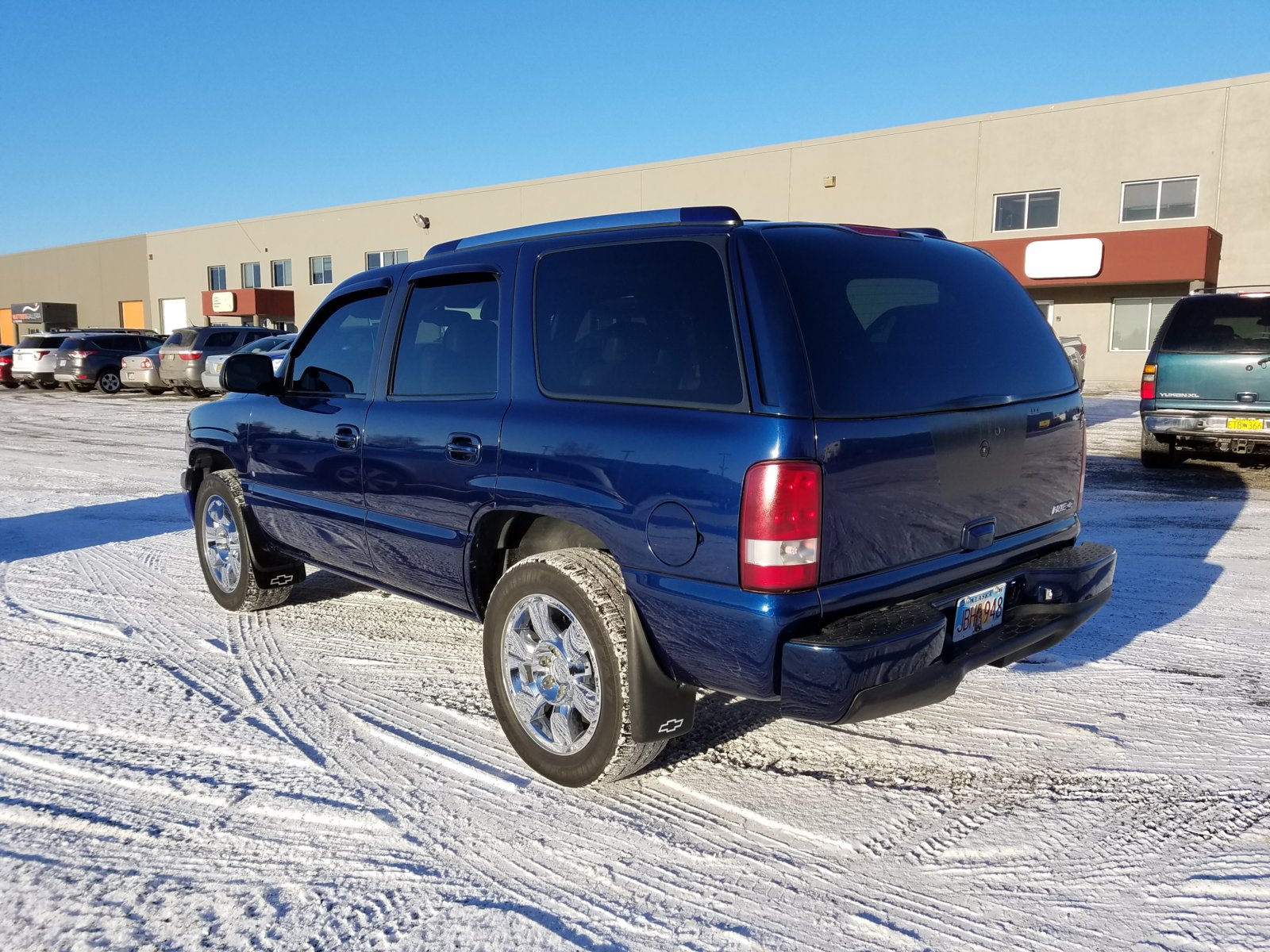

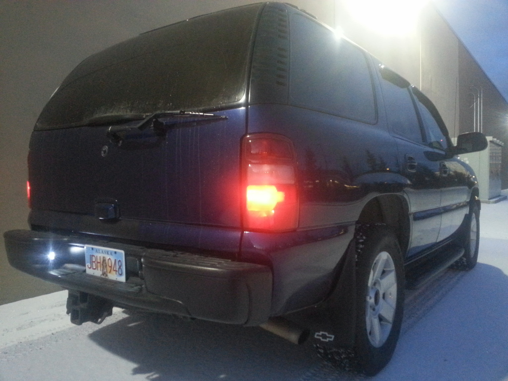

Rear bumper
This was my first real experience with the stuff. For a beginner it's great and hard to mess up.
