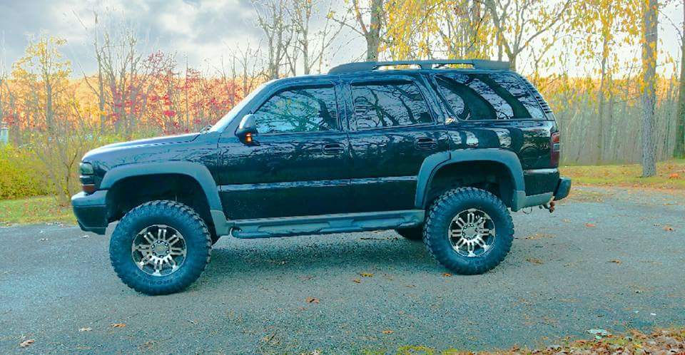

Hey,
I have a Tahoe with a 6" NTD Rough Country lift. I know my torsion keys are very close to stock height but am I going to run into any issues (such as the control arms binding, the RC shocks overextending, etc) if I reindex the keys and add 1.5" coil spacers?
I'm looking to clear the new set of 315/70/17 tires without rubbing on full turn/bumps. I have trimmed as much as I can without it looking goofy and the truck currently sits level.

If you don't go more than 1.5" you should be OK. They sell shock extenders or relocaters to move the shock up a couple inches. Either that or get longer shocks but you shouldnt run into problems with everyday driving. Off road is where you will notice the shocks bottoming out if too short for your setup. Truck looks boss.

Excellent. They are Rough Country shocks designed for the 6" lift... I did this lift a few years ago and don't remember if they had shock extensions or not but I can fabricate and weld if I have to.
My big concern is how the rear axle doesn't sit center in the wheel wells since the rear pivots on the control arms (the longer the coil springs the more the rear walks toward the cab).
