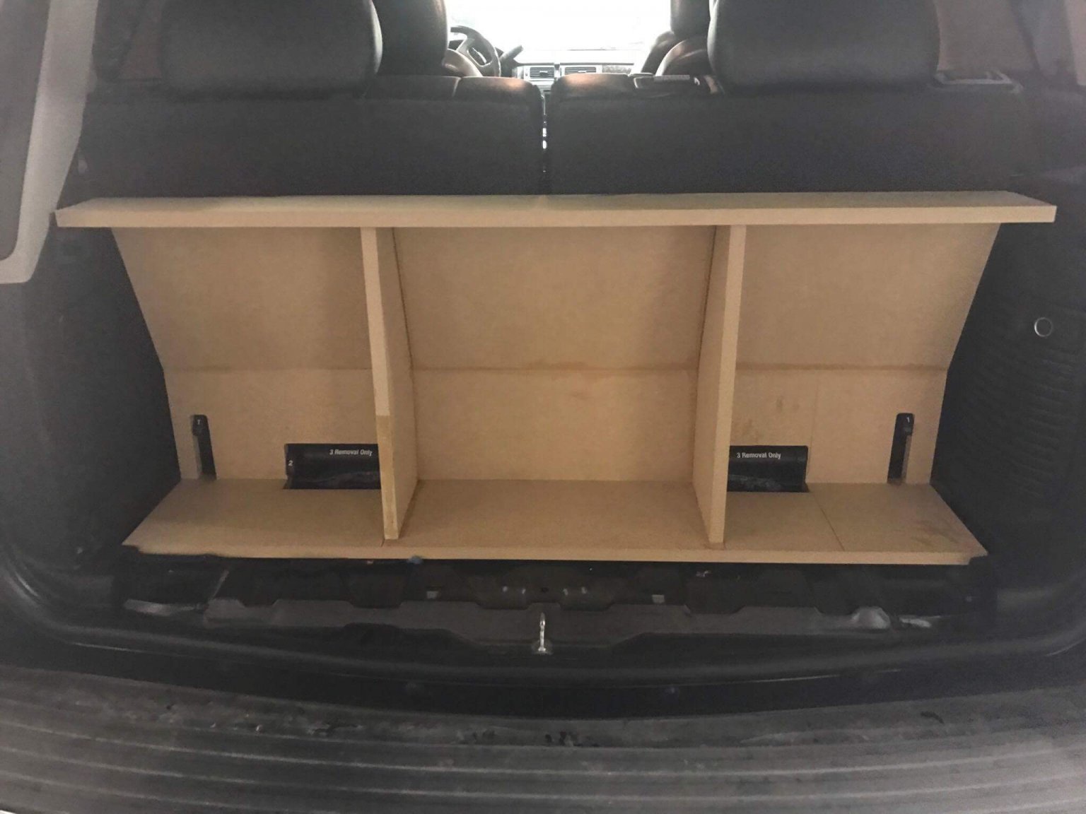

There's over 200 hours of custom fabrication and several hours of tuning the digital sound processor involved.

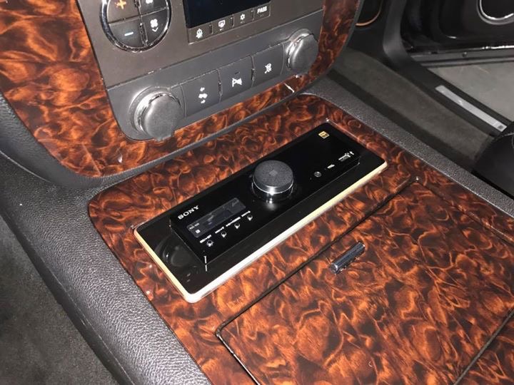

Kept the factory touchscreen headunit for rear camera, dvds etc but added a 2nd Hi Def Audio Head unit.
Here's the layout
Sony RSX-GS9 Hi Resolution HD Audio Headunit.
Uplifts any audio file into hi resolution audio. It doesn't have a touchscreen and the display is pretty small but its focus isn't on buttons and display but HD Audio files. Controlled via the Sony SongPal App or remote that comes with it.

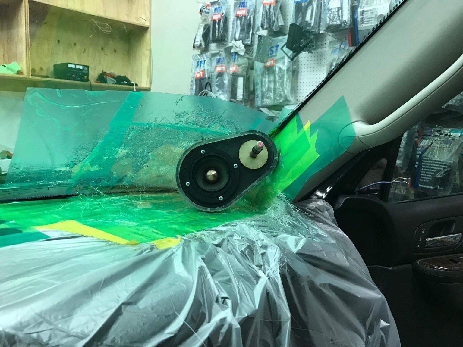

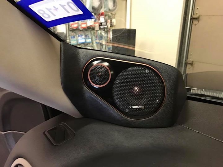

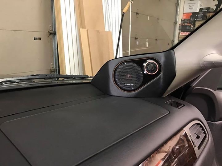

Front Stage dash custom speaker pods:
Hybrid Audio Technologies
L3se- 3" midrange speakers
L1ProR2 tweeters

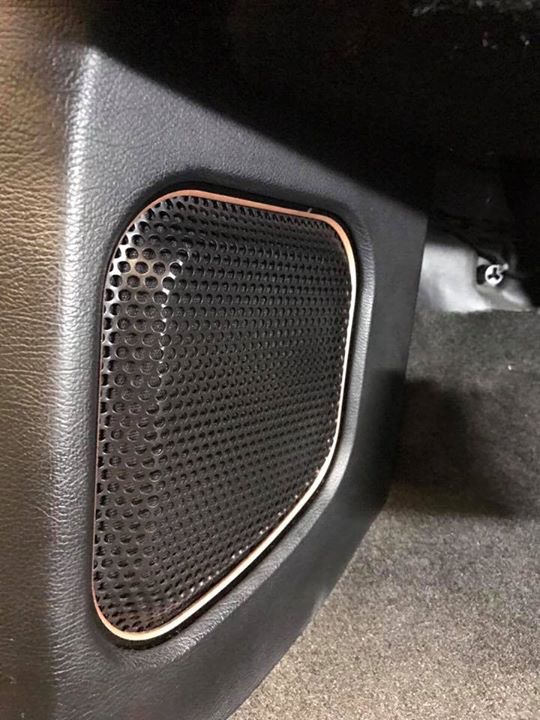

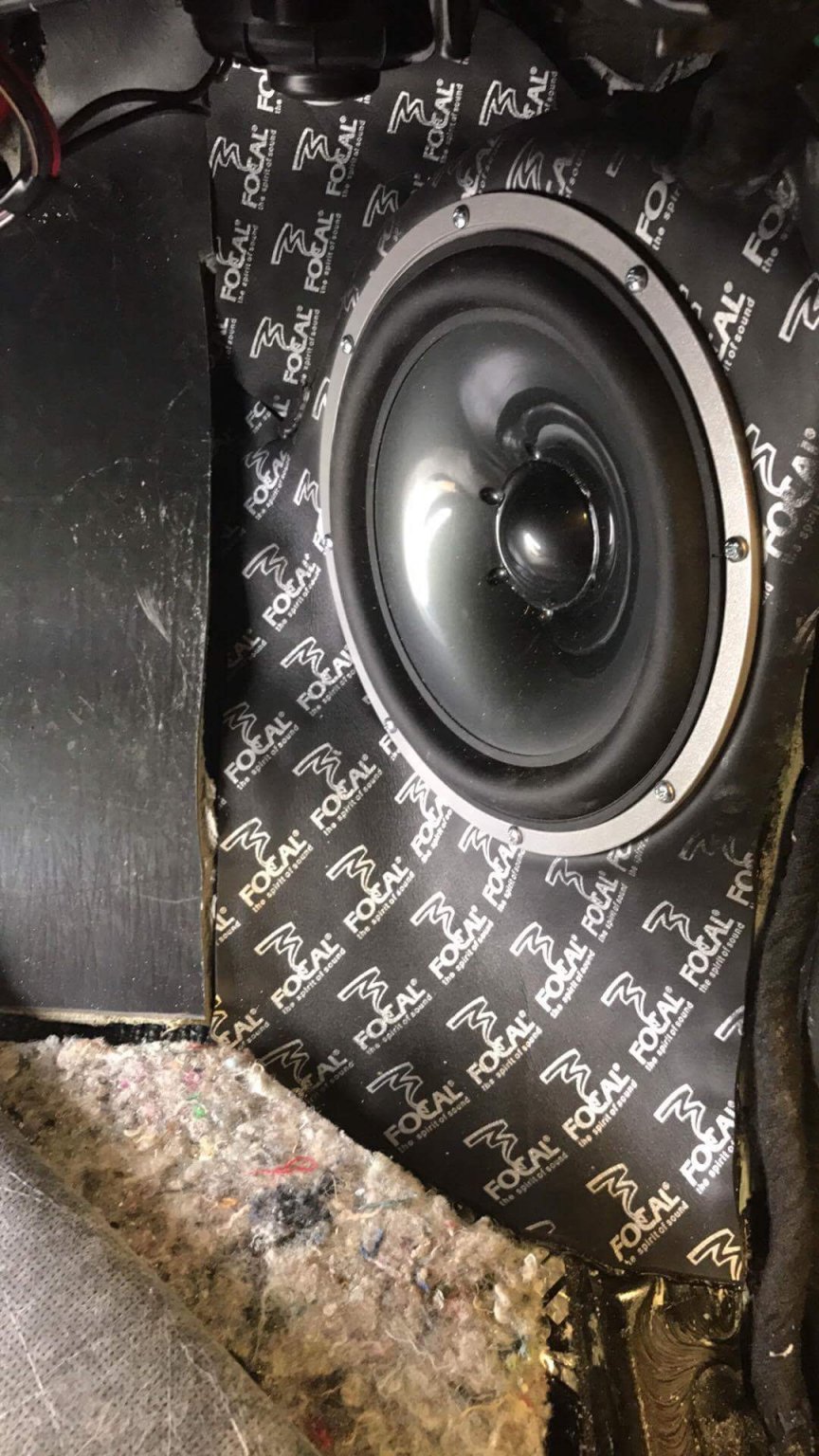

Added 8" Midbass Custom Kick Panels with custom pressed grills
JL Audio ZR800
We had to remove the ebrake assembly but converted it to an actuator E-brake thats controlled via switch under the dash.

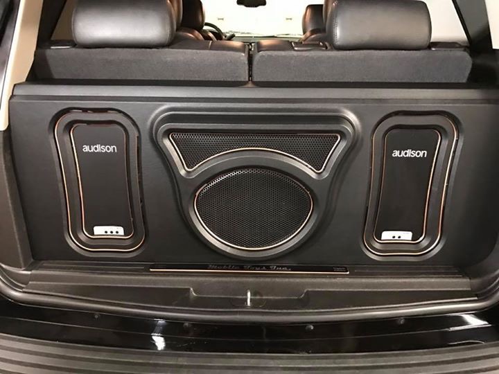

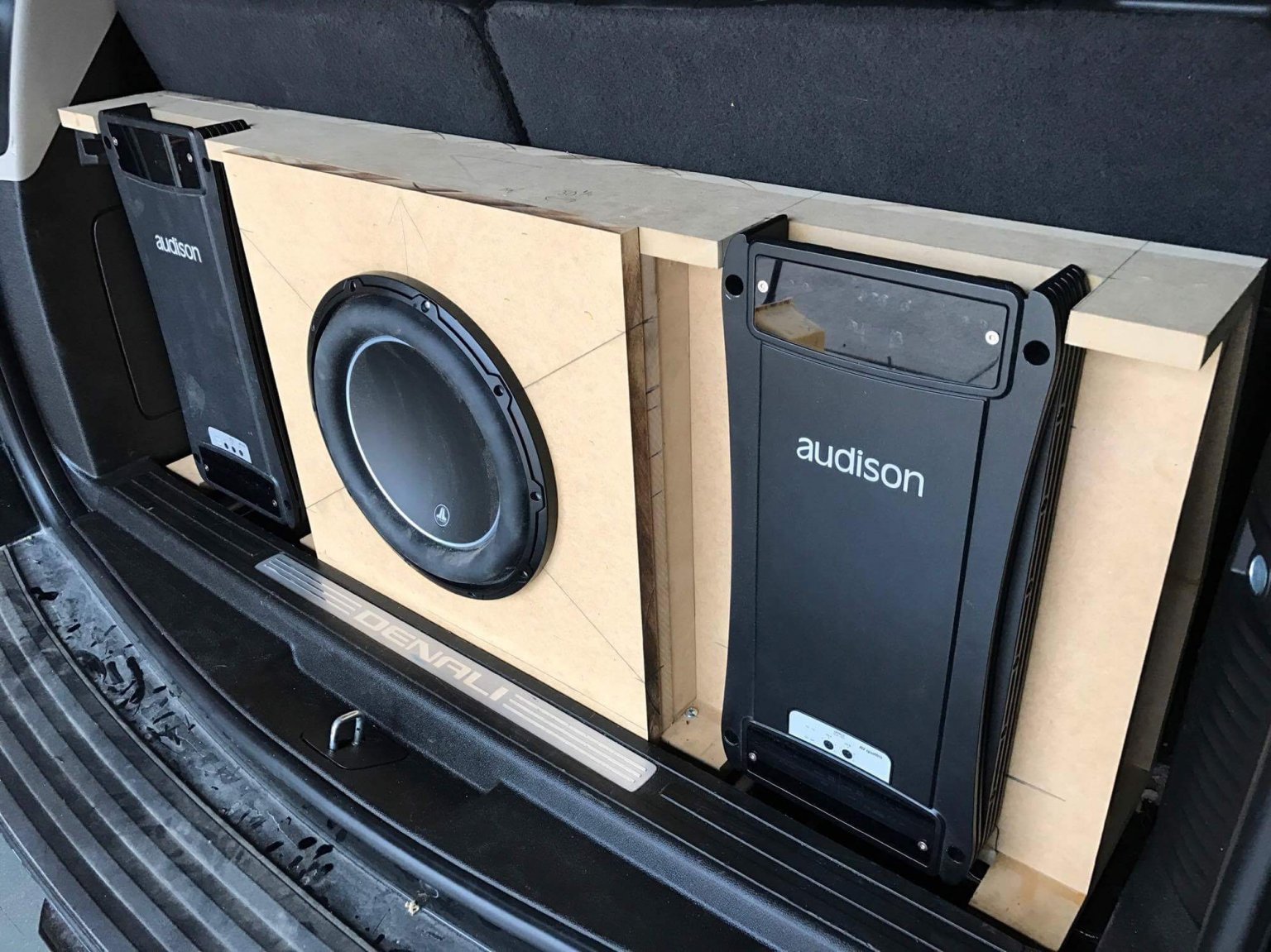

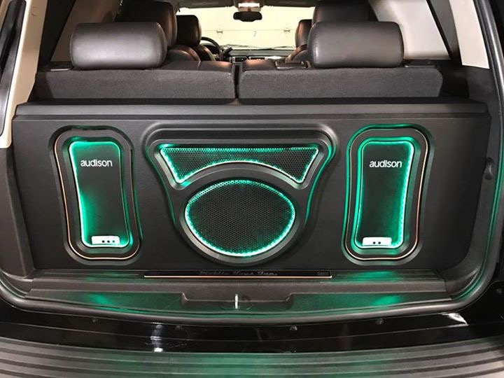

Custom Amp Rack and subwoofer behind 3rd row

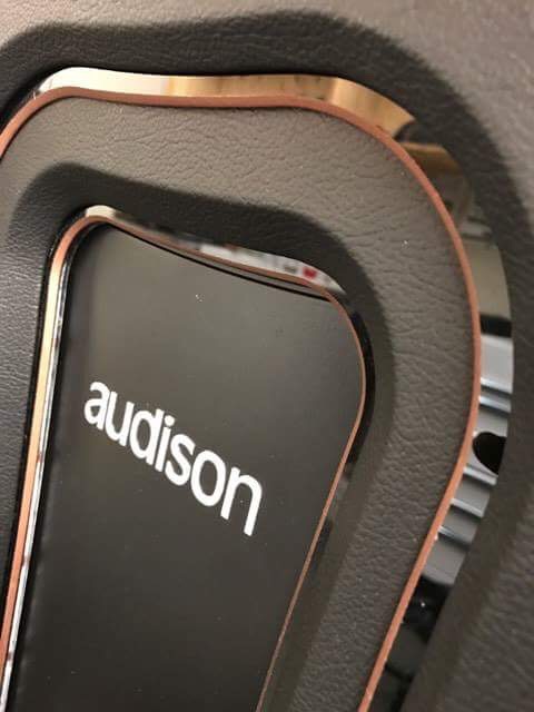

Amplifiers-
Audison Voce 5.1k 5 Channel Amp
Audison Voce Quattro 4 Channel Amp
Subwoofer-

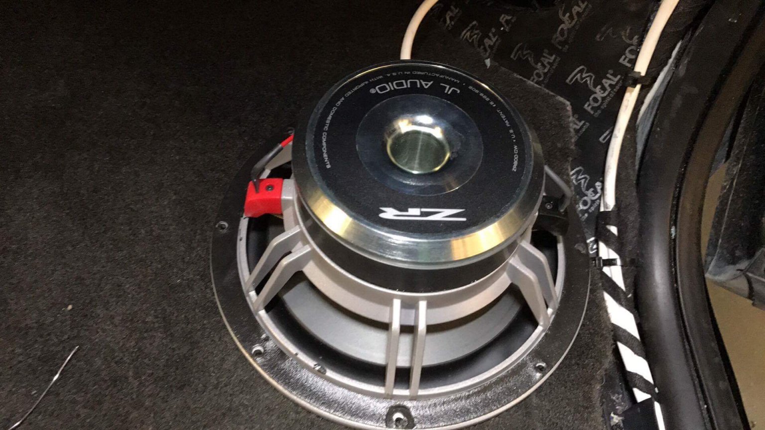

Single 12" JL Audio W6v3 sealed in 1.125" enclosure.

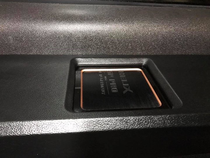

I am running front stage active and using a 10 channel Digital Signal Processor
DSP-Helix Pro MKII with director (remote)
meaning there are no passive crossovers and each speaker has its own amplifier channel.

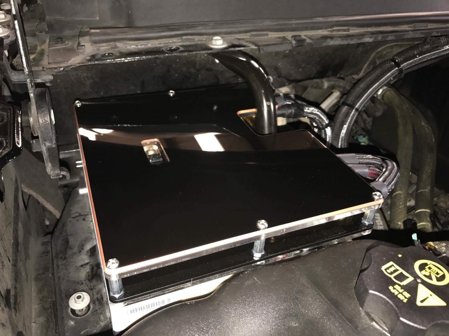

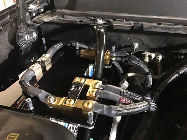

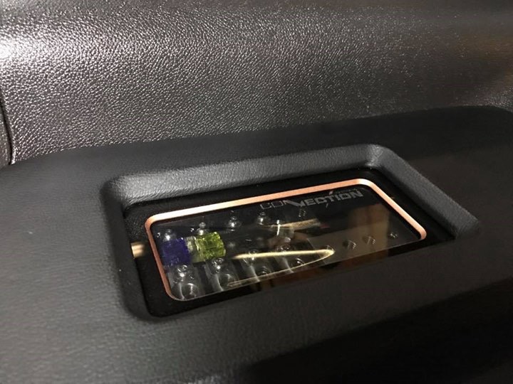

Battery was upgraded to a XS Power D3400. Had a custom battery top made following the same copper theme as the rest of the installation.
Big 3 Upgrade was done to 1/0 Stinger Hyperflex Wire.
Audio system power wires are a 1/0 run of Stinger Hyperflex power wire.
I have all power wires covered with techflex for looks.

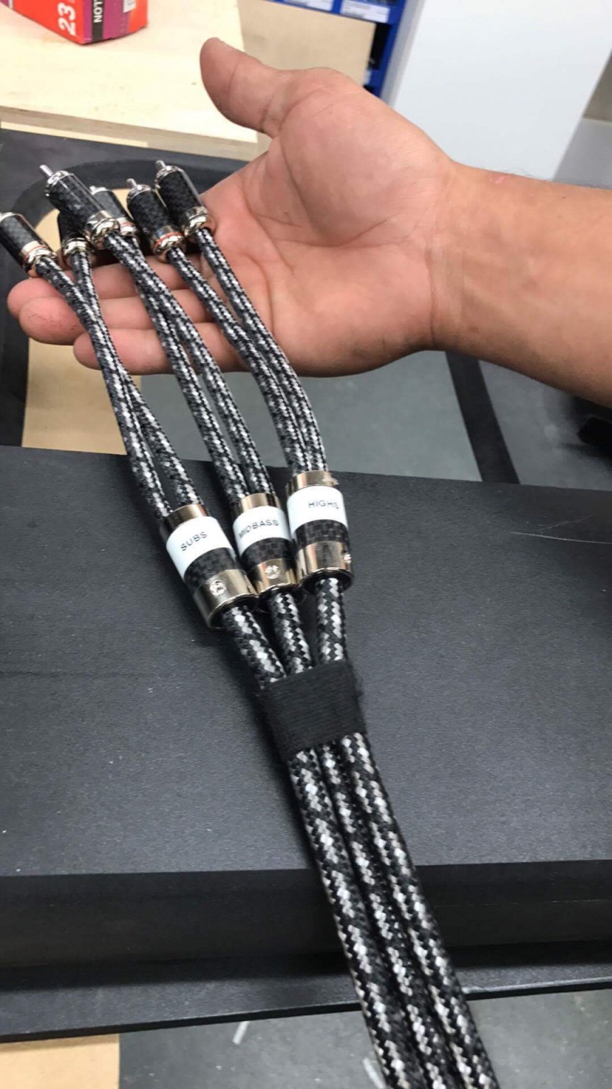

RCA's- Stinger 9000 series RCA's all around.
