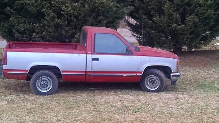

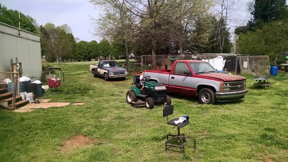

I had a woman call me to come clear some scrap metal out of her yard. Under a tree was an 88 Chevy short bed with about 3 feet of pine needles covering it. I gave her $500 and left with it. It had to work on the way home. We loaded 4 work benches on it. I towed it behind my 94 Chevy Suburban that died shortly thereafter. The little S10 is my wife's 500K mile S10 still doing work.
It sat in the yard for a few weeks with no real hurry to get it on the road. We started it up and it smoked like a house on fire. It also had no brakes. That was a fun test drive.

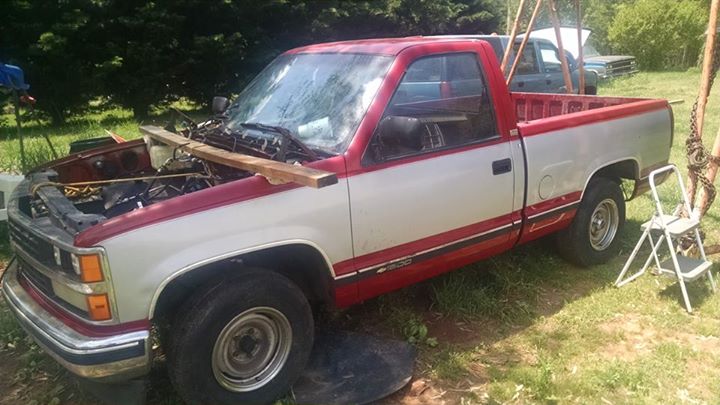

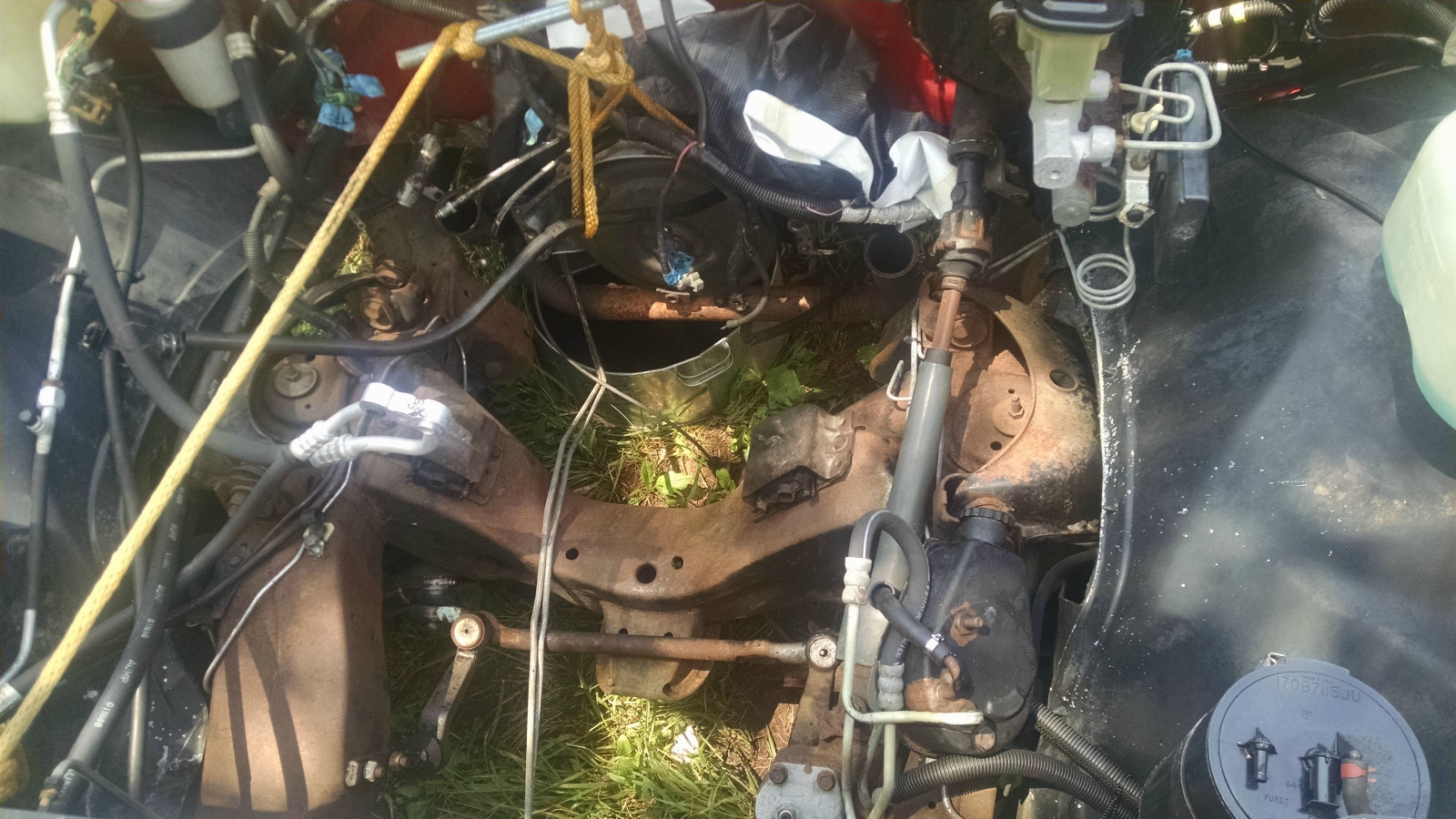

Pulled the engine.
It was covered in grease and oil and grunge from a massive oil leak. Some Purple Power and a pressure washer and it looks pretty good. Still have some cleaning to do.

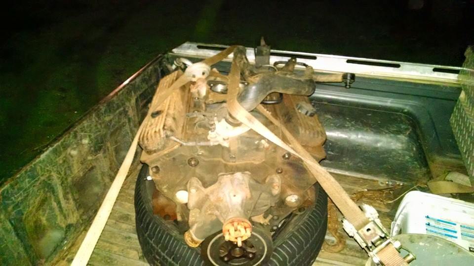

I bought an engine.
Guy said it was perfect. Got it home. One cylinder was full of water and it had 60psi compression on 2 cylinders. If I wanted to rebuild one I would rebuild mine (which will happen eventually). Took it back and got my money. I was called every name in the book. I was bigger than he was so I got my money and left.
So if you are not too far from Charlotte NC and have a cheap 350 let me know.

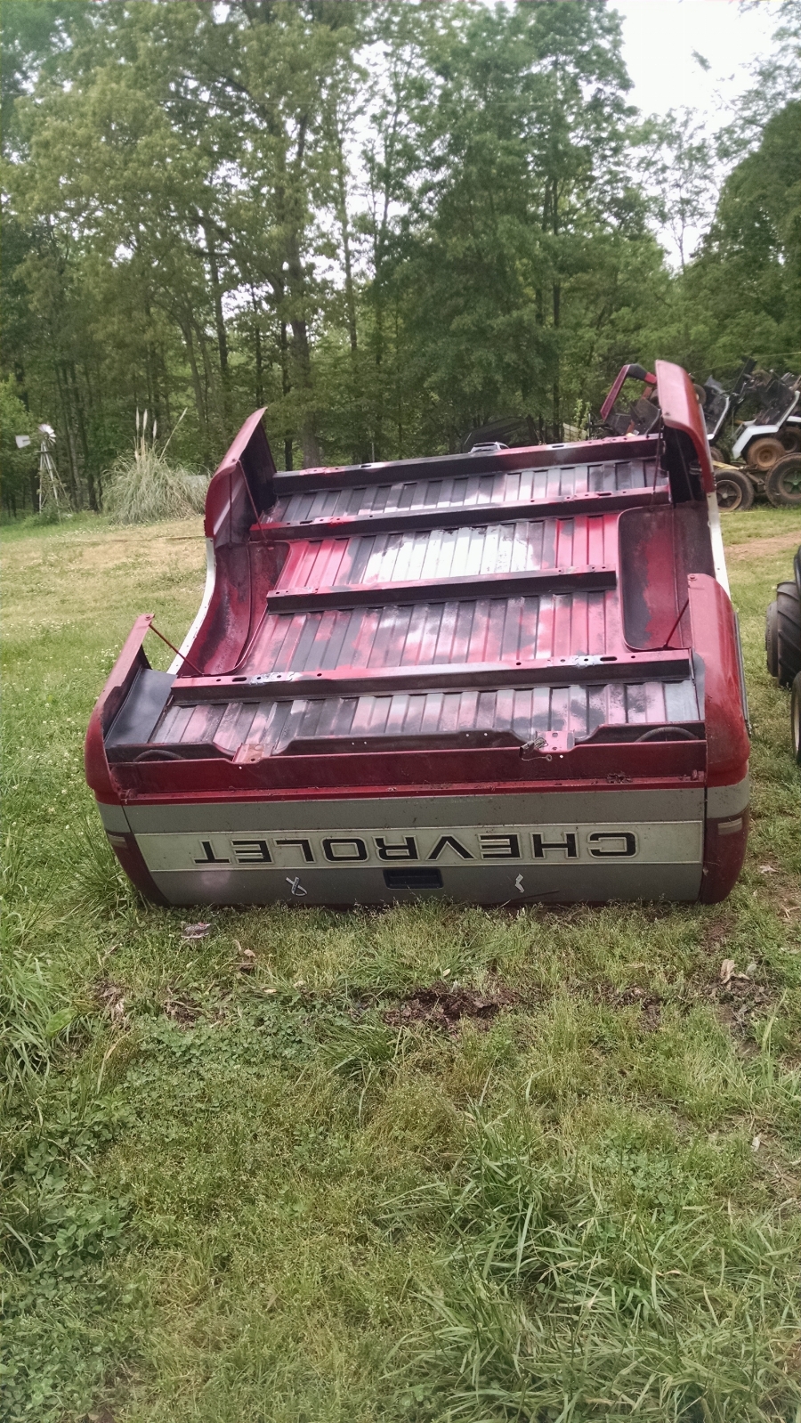

Pulled the bed off and hosed it with degreaser.

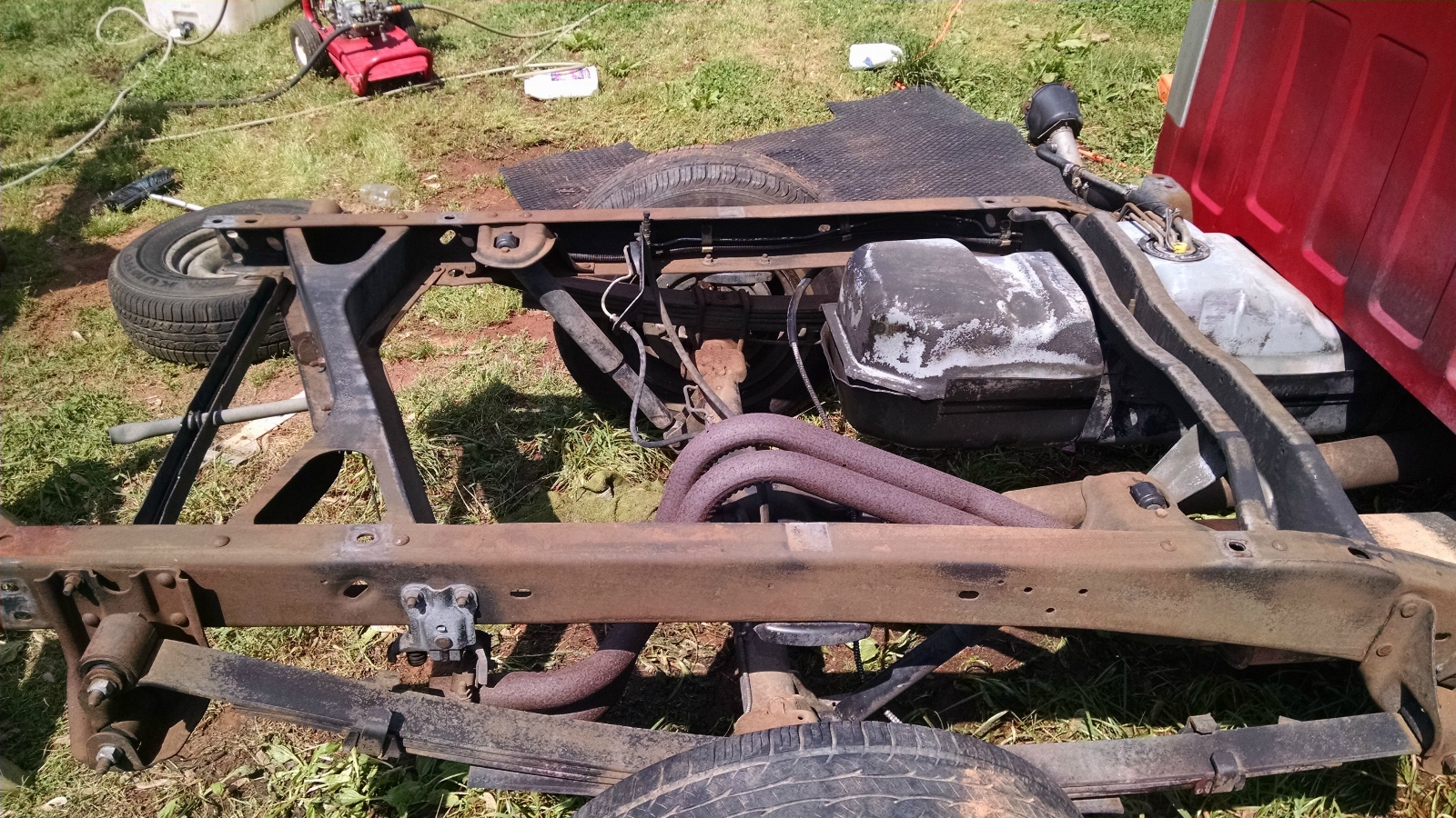

The under side is covered in oil and gunk.

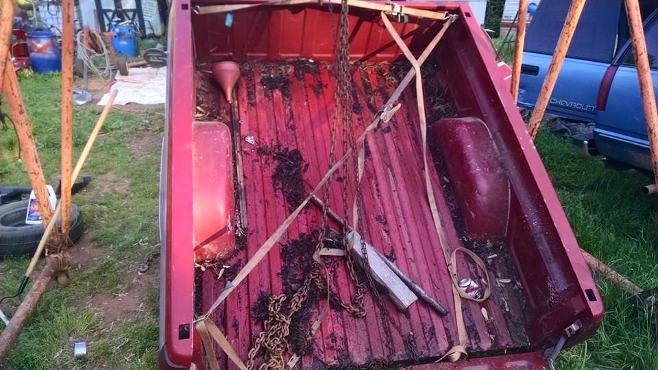

The bed was full of trash and pine needles.
Propped it up for cleaning

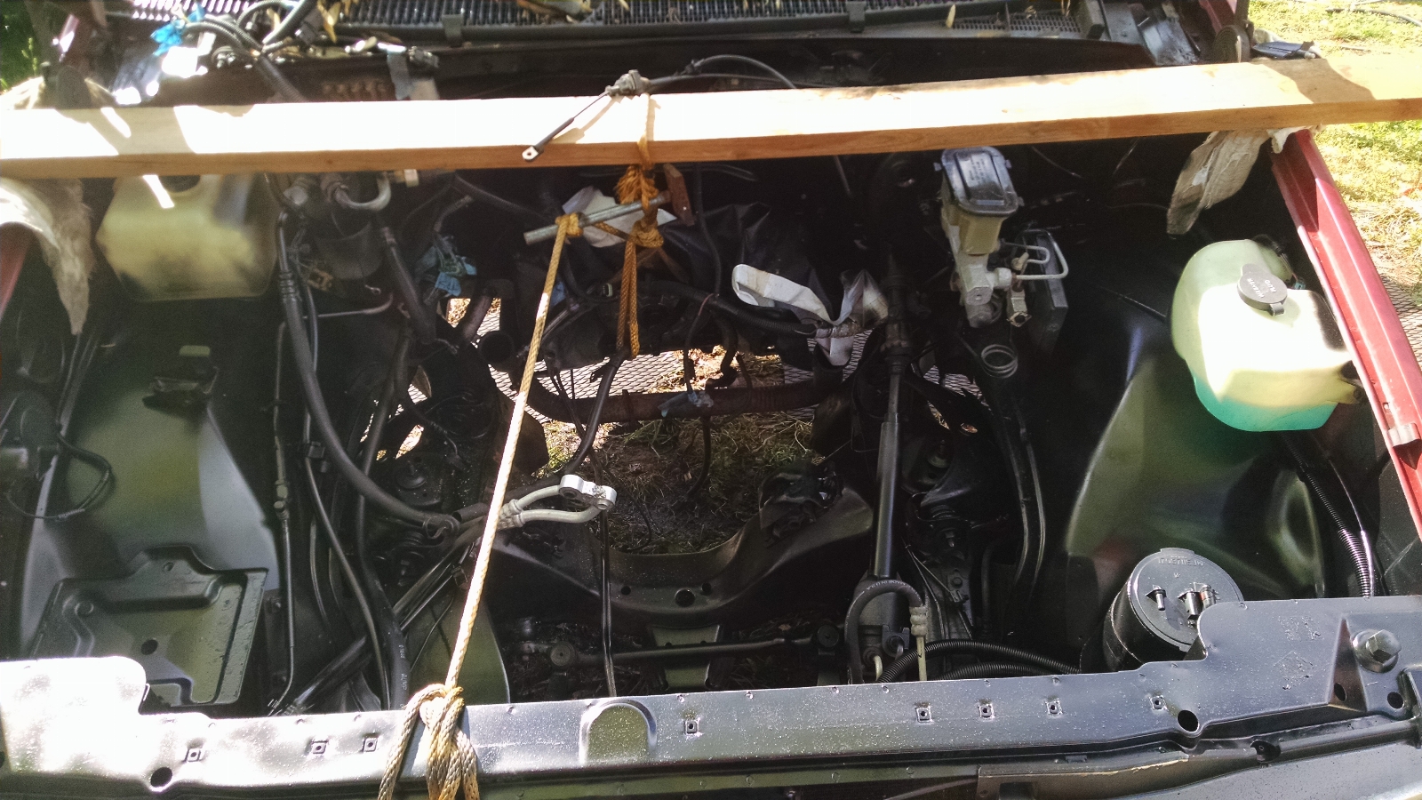

Final wash of the engine bay
Next comes paint

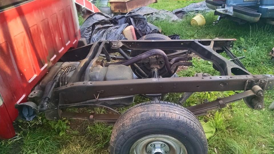

I am going to lift it up with the crane tomorrow and get under the cab.
Under the bed
Still gunky but getting there. My shoulder gave out so I had to stop.

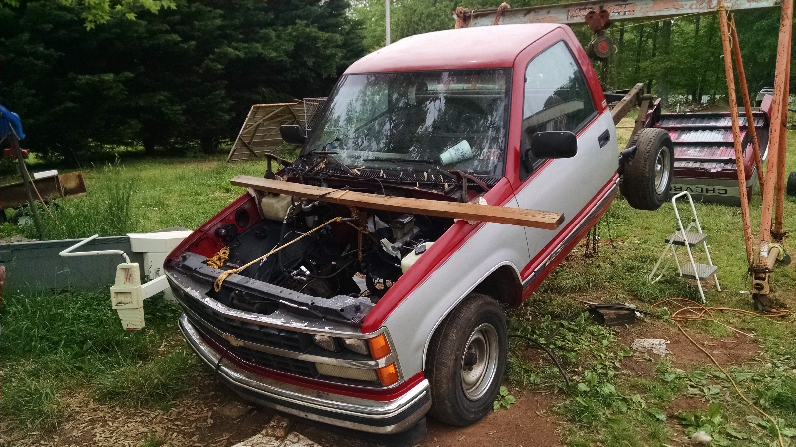

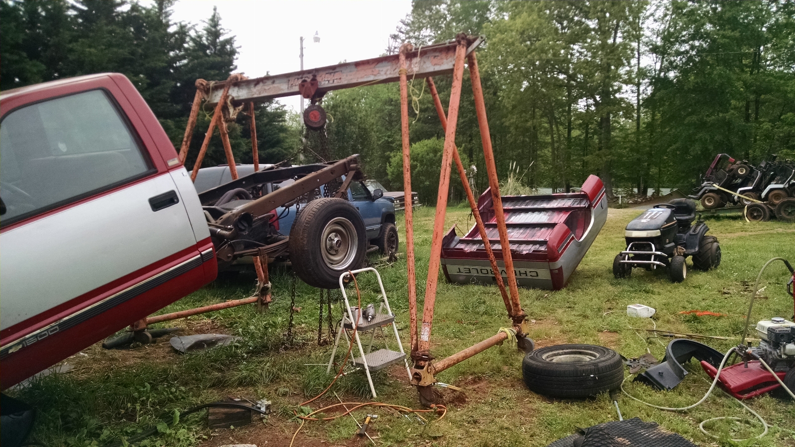

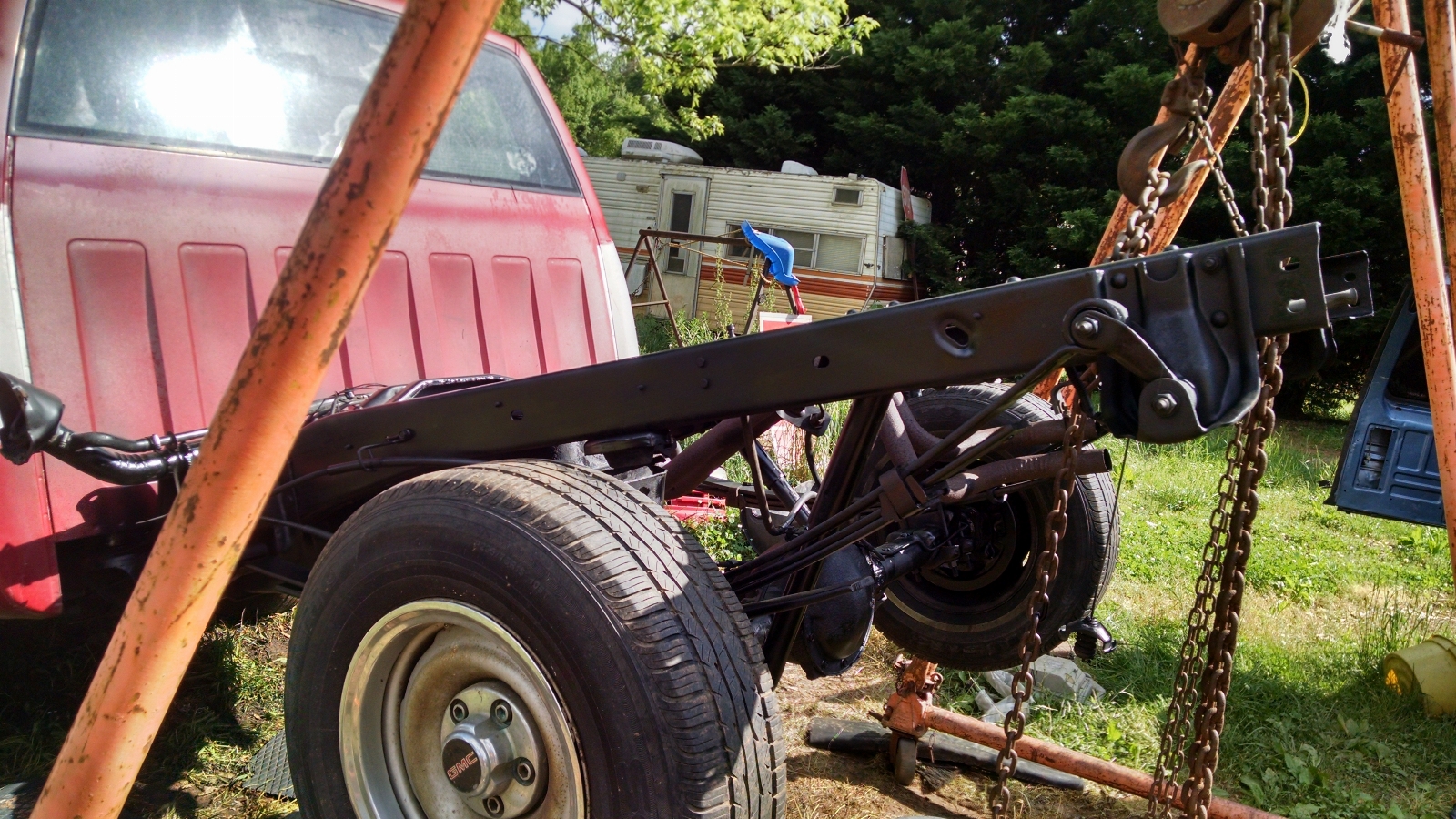

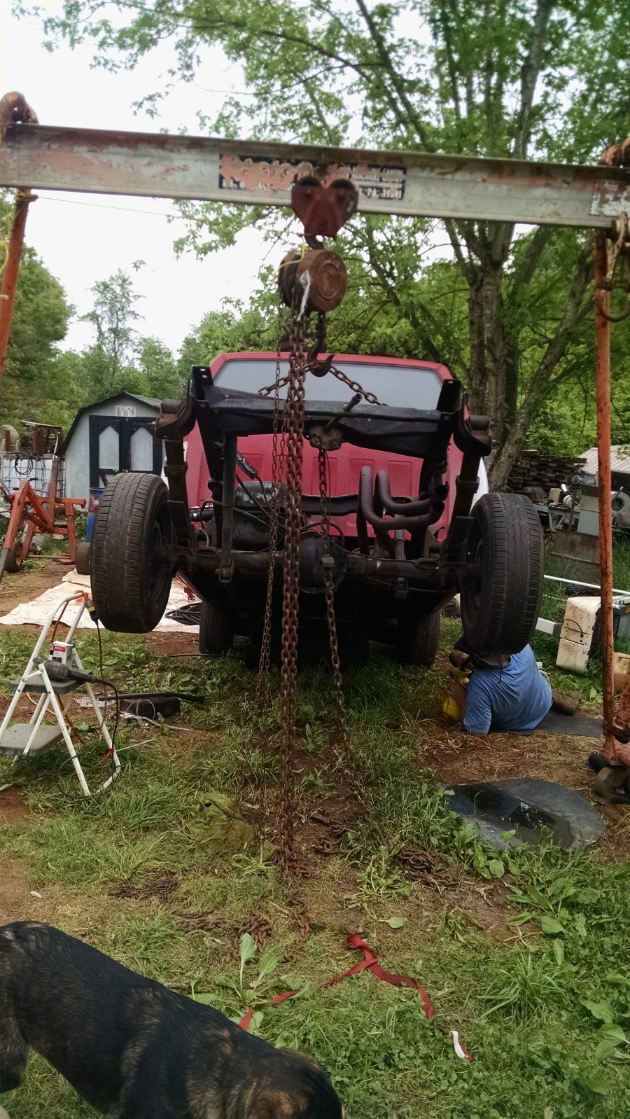

Needed to clean the underside so the gantry crane lended a hand

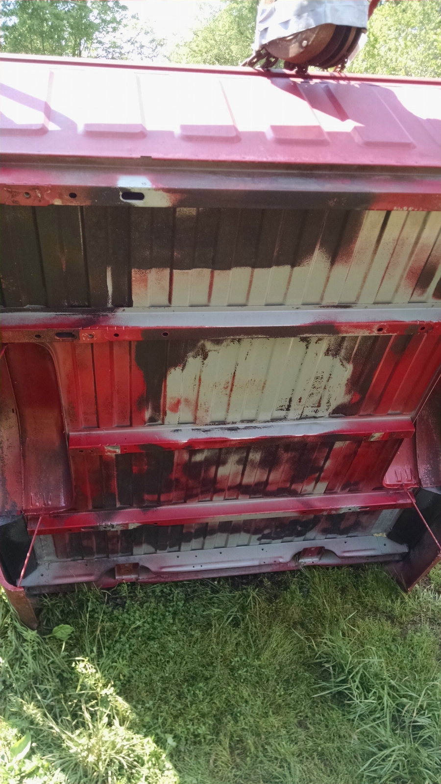

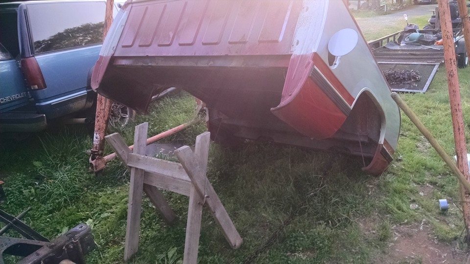

Flipped the bed. Still have some gunk to clean off it

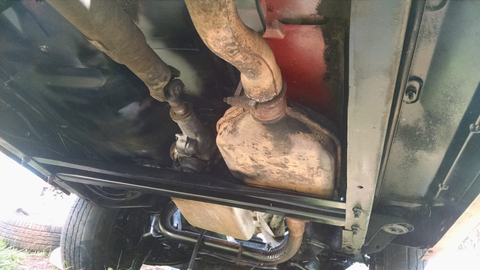

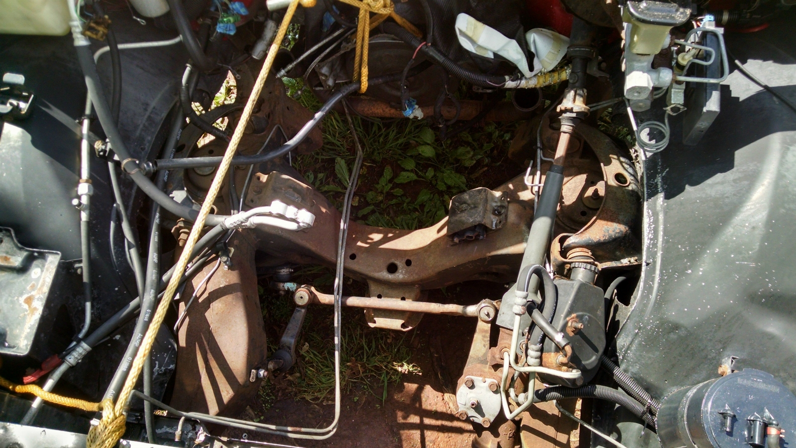

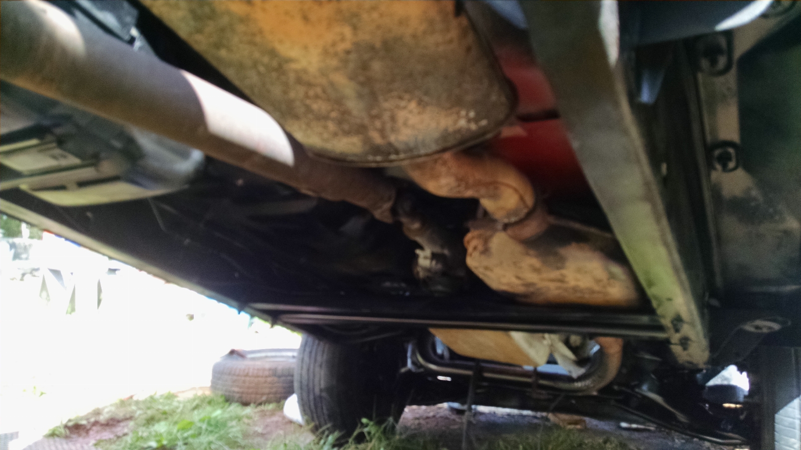

Better shot of the underside hosed down with degreaser, Bottom on the cab is nasty!

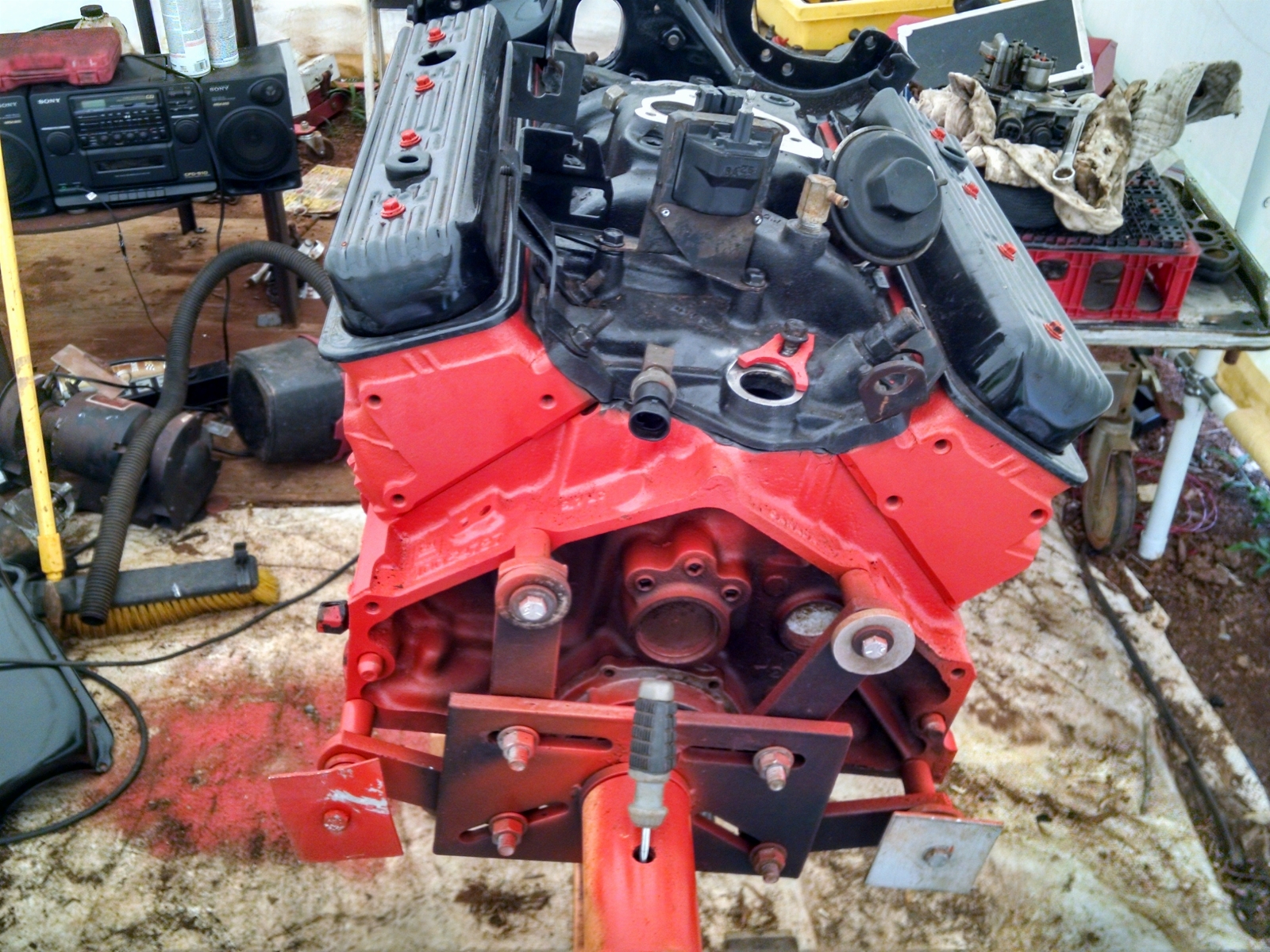

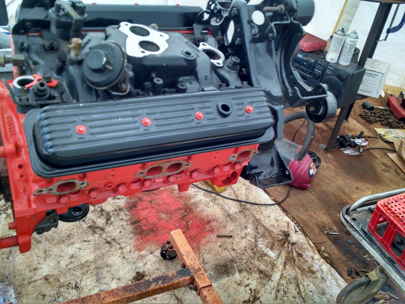

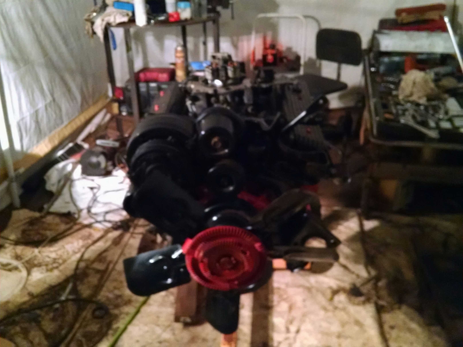

Got an engine for the 88 today. Compression and leakdown tests showed it has a blown head gasket or cracked head between cylinders 2 and 4. Not a big deal since I wanted to go ahead and do the heads any how and I have 2 sets of heads if these are cracked.

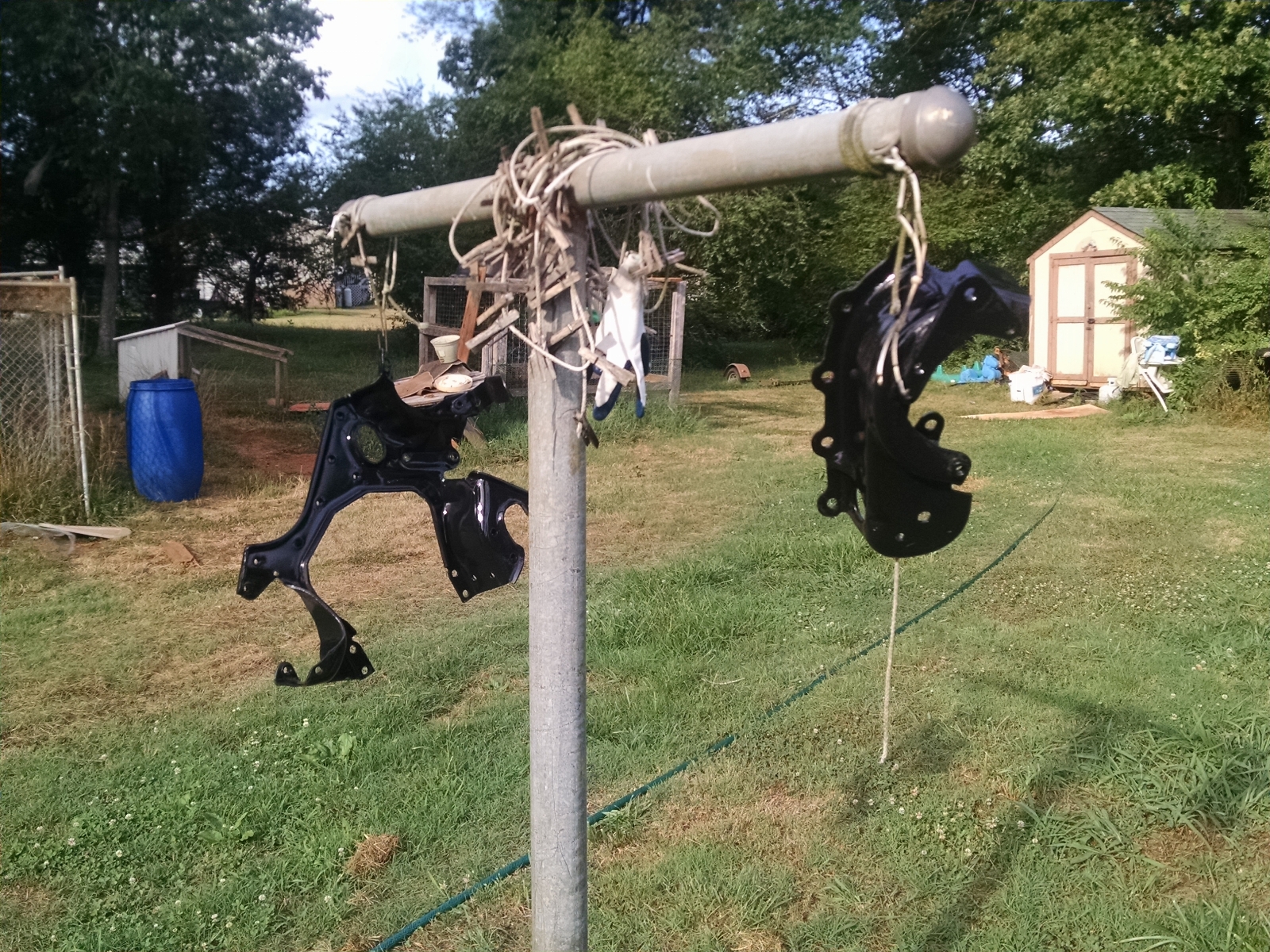

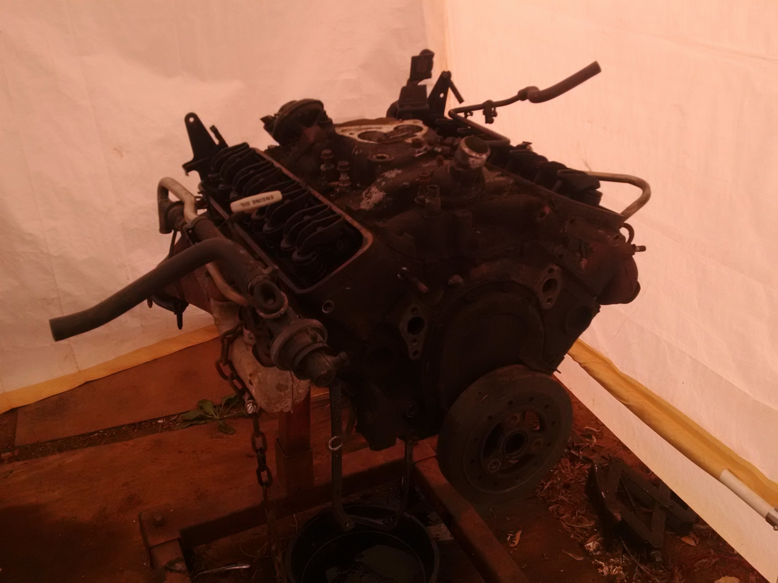

Hosed down the engine with degreaser.
It was super nasty

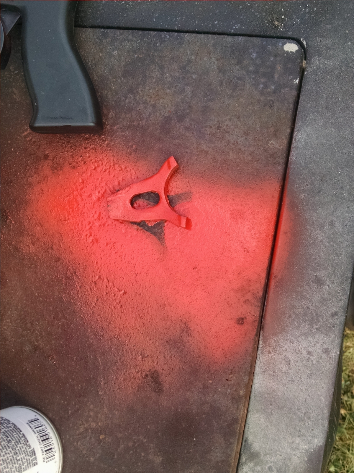

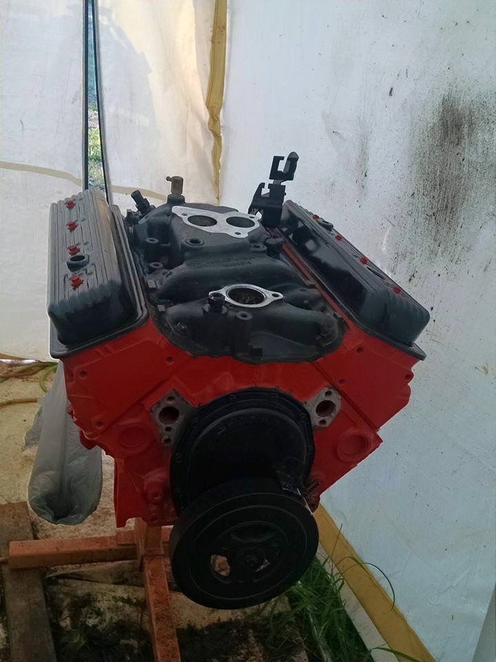

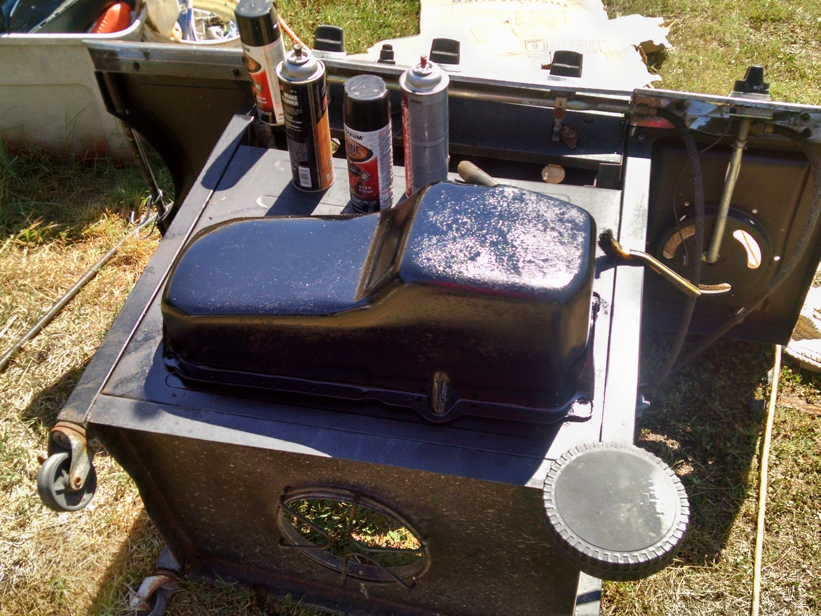

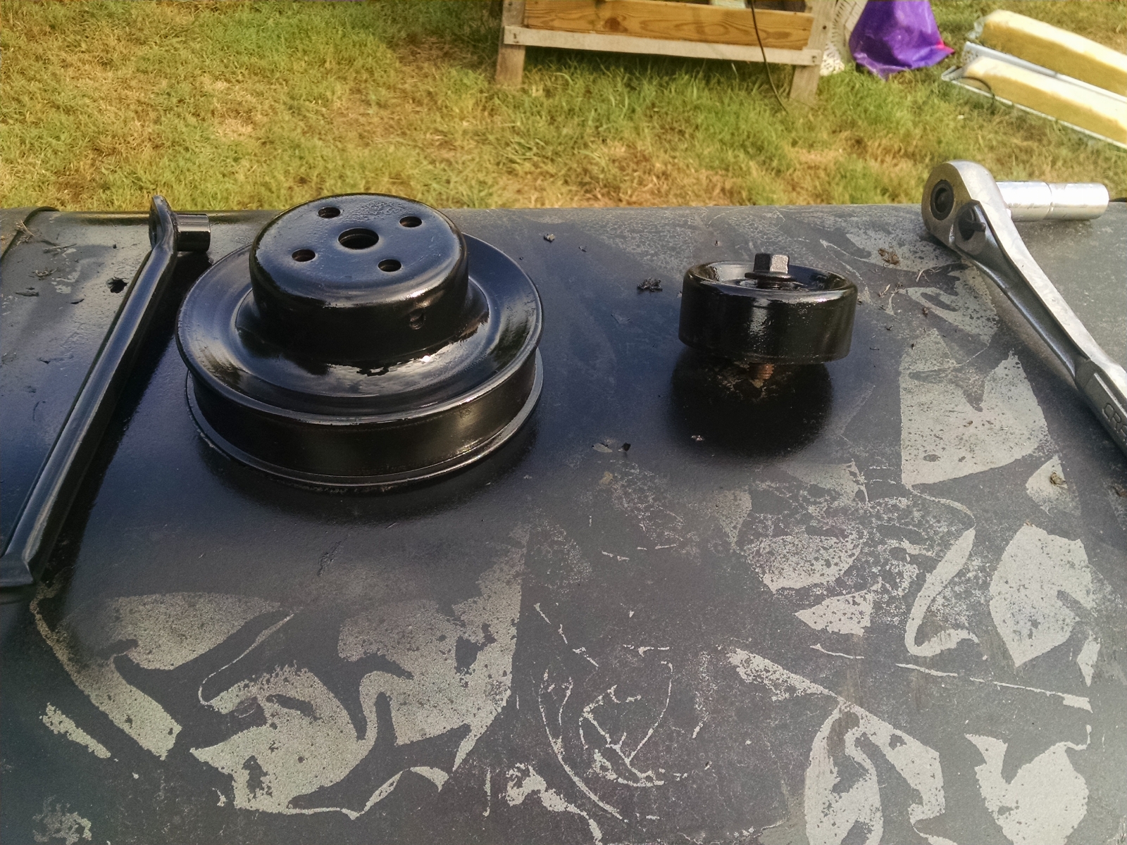

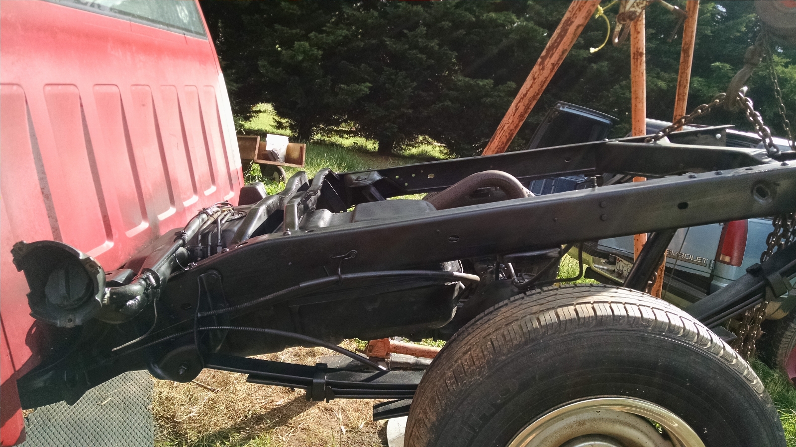

My son, Jared and I attacked the frame and engine compartment with Rustoleum rattle cans. Looks a world better.

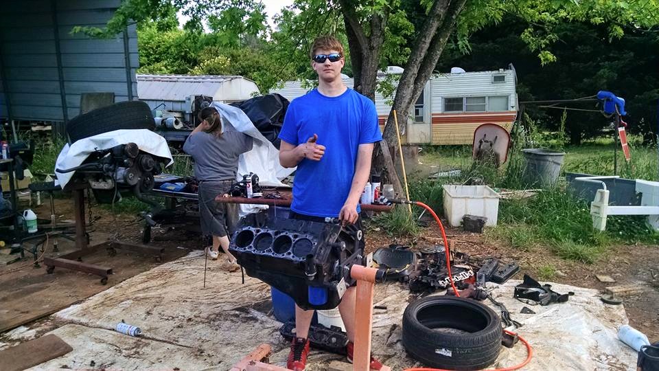

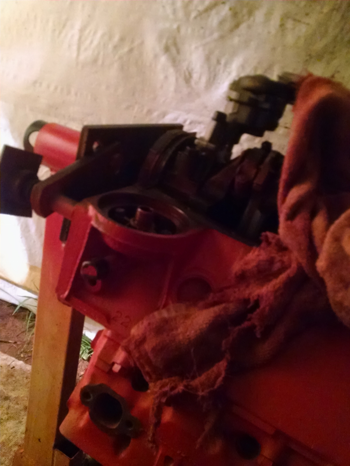

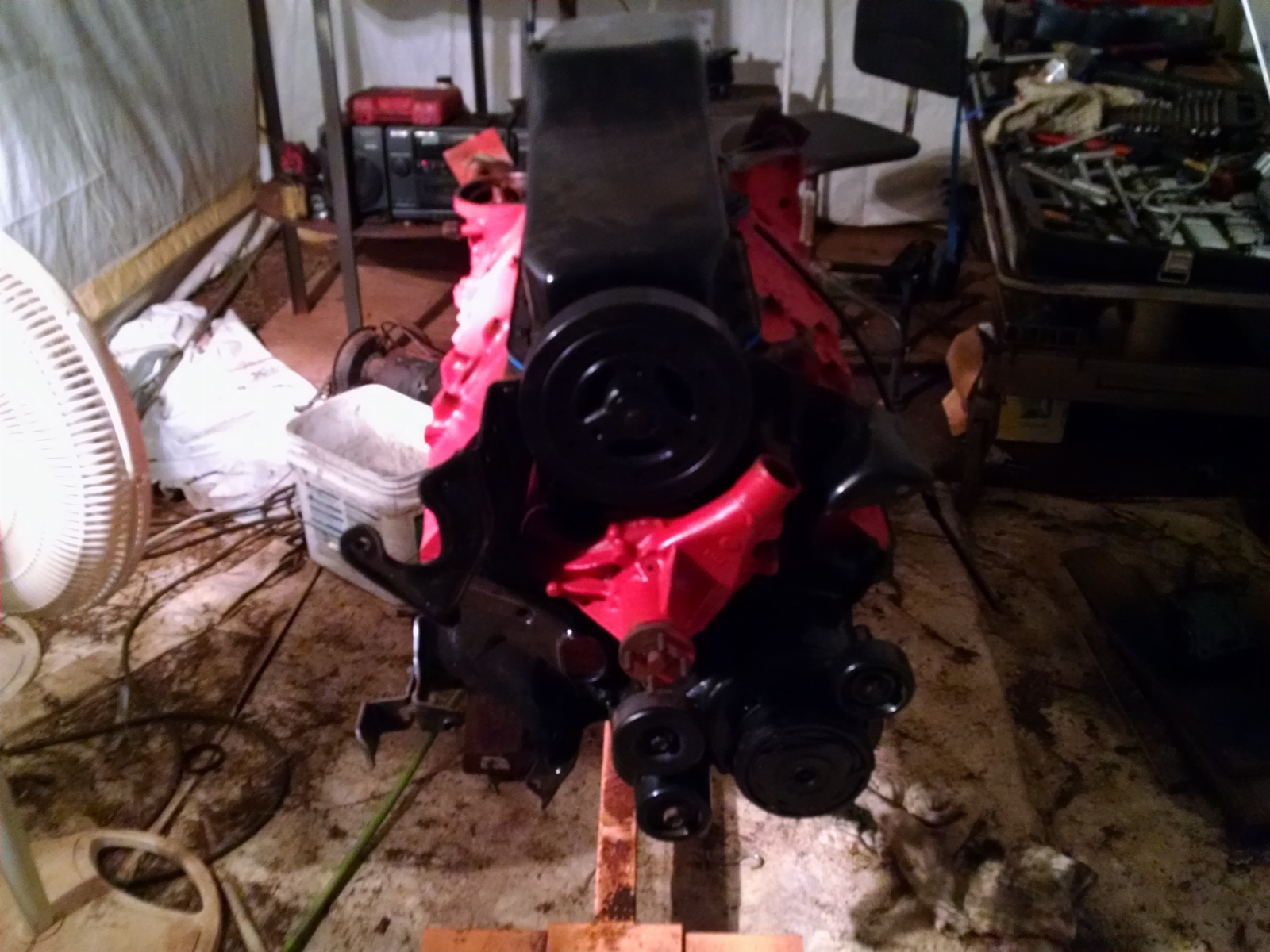

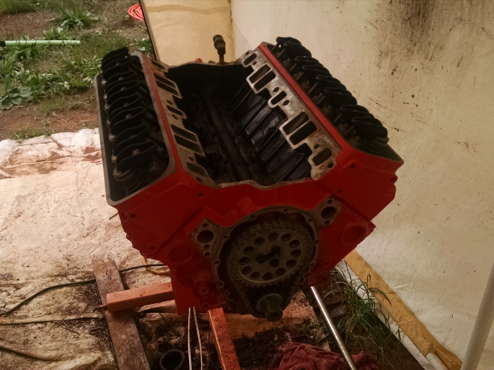

The other engine.

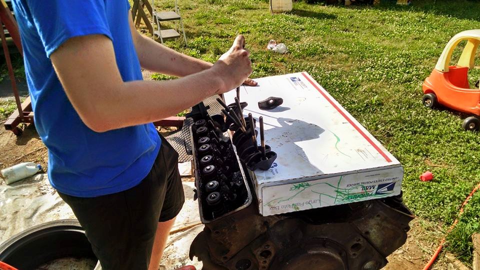

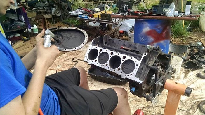

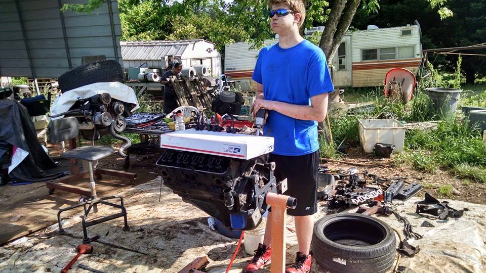

Did a compression and leak down test. Showed blow-by from cyl 3 to 5. I figured it was a blown head gasket - worst case scenario is a cracked head and I have 2 more sets. SO we (my son Jared and I) pulled it down. Here he was using a box for the pushrods

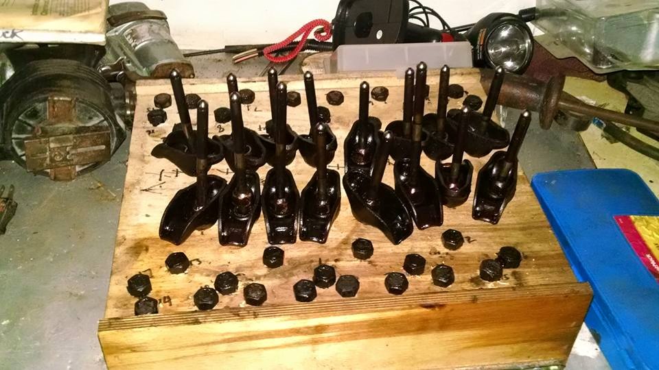

Decided to make something reusable
Took an old drawer and drilled holes in it. Covered the other side in a old metal sign. Everything is numbered. Super easy.
He was pretty proud.
This is the first engine he has ever had apart.

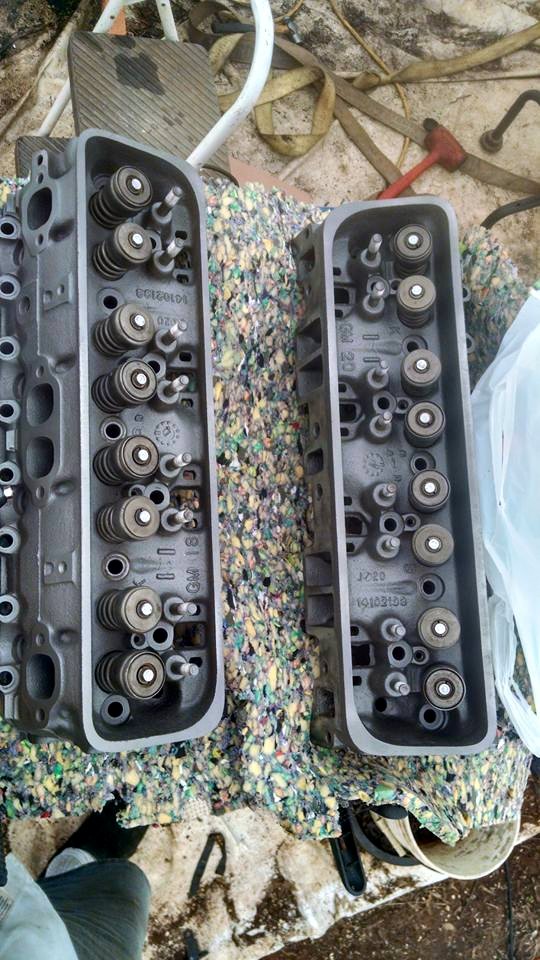

Thursday the machine shop called and said the heads were cracked. NO problem I had another set in the shop. Had to dig them out and send them off.

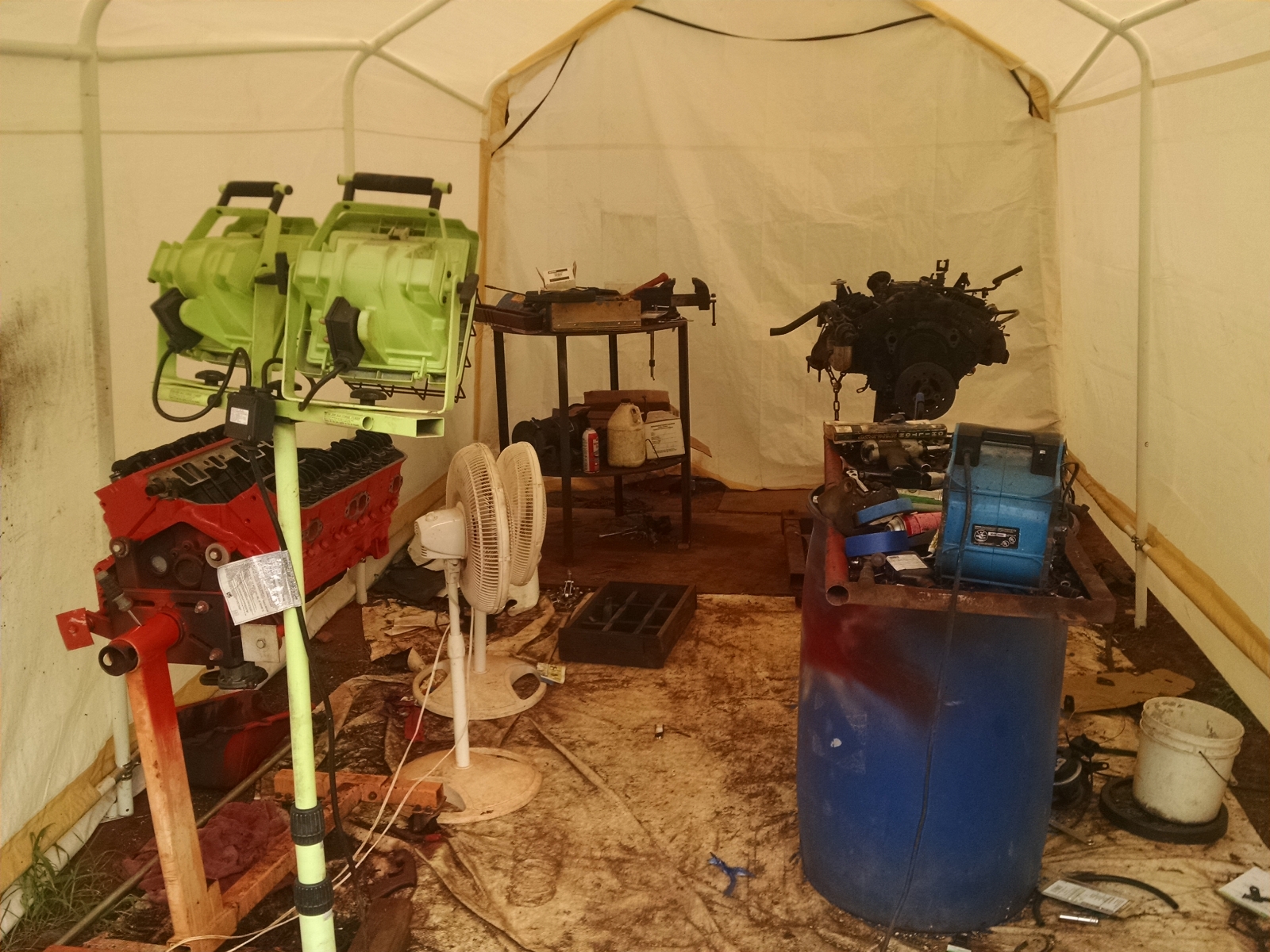

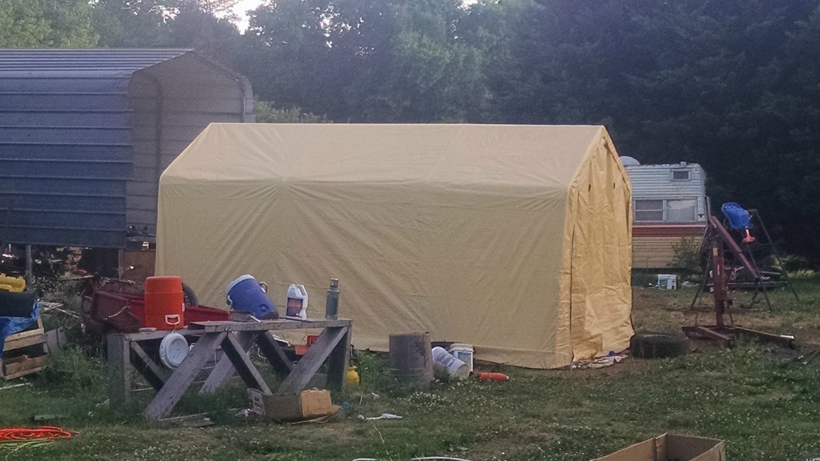

Forecast is calling for monsoon weather so I figured I needed a dry place to work. The carport is full of tractor stuff so no working there.
Saw an ad on CL for a portable building. Got it up just in time on Sunday. It has rained ever since.
Last night I spent some quality time on Rock Auto ordering parts to put things back together.
