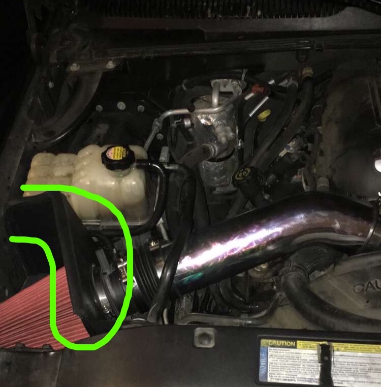

After installing my 99002 Spectre Air Intake I notice my hood will not shut all the way has anyone else experienced this problem? I think it has to do with the heat shield.

Solved this is a common problem all you have to do is cut the heat shield
That’s weird mine required no cutting and doesn’t have the insulation strip, maybe it’s been redesigned
There's two versions 99000 and 99002. You most likely have the 99000.
