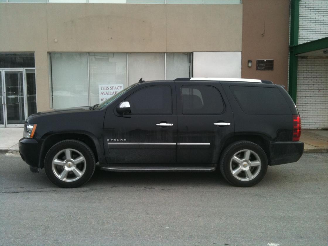

Hey all,
I'm in the process of fine-tuning my Belltech rear drop on my '09 with autoride.
At this point, I have the rear springs in with shock relocators and no spacers. I have the stock autoride links in (which I can't say have been altered or not from the first drop installation).
I am about to install the Belltech-supplied shorter autoride links.
My question(s): How, exactly, do the autoride shocks work? I know that the shocks air up when the truck senses that it needs to be raised -- but how do the shocks air DOWN? (I have found that the ideal rear wheelwell measurement to the ground is 36". I've measured the truck at 36", but measured it after driving last night to be 37-1/2".) Do the shocks just release air over time? Is there a purge after every drive cycle or something?
When installing the new links, should the air lines be pulled from the shocks to release the air, THEN the new shorter links be installed, assuming the truck will air the shocks back up (to a LOWER height than before)? Or, do I not touch the air lines, install the shorter links, and the shocks will just naturally find the correct, lower height after driving or some time or...?
I understand the airing up process -- I just don't fully understand the airing down process, especially when there's no additional weight added to the rear.
Thanks, folks!
